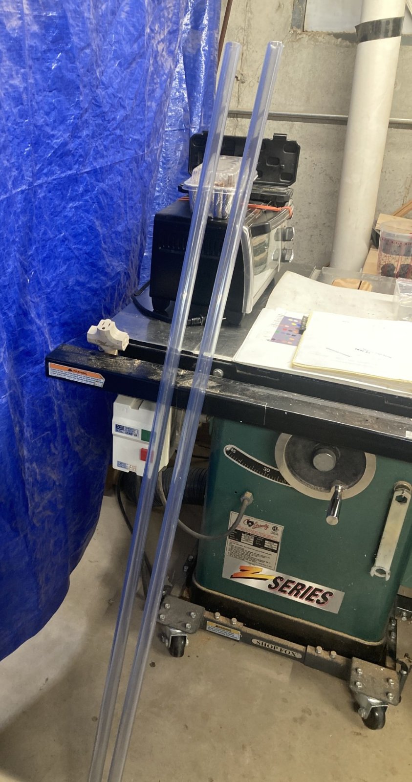

Lastly, I received my Schedule 80 Clear PVC Pipe today. I can't wait to cut it into 12" lengths and use it.

Brief Update - I poured several tubes last night using my clear Schedule 80 PVC pipe - the pour went well. This morning I pressed the new blanks out of their tubes, and something did not seem right. They looked too skinny. I measured them with calipers - sure enough, they are about 0.700" instead of 0.750". While I can probably use these, it is not what I was expecting or paid for. I will consult with the company I purchased the pipe from and provide an update here.

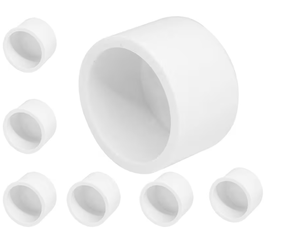

I cap my pvc with pvc end caps, at Lowes. I line the caps with Saran Wrap. You have to push the Saran liner internally the bottom of the cap or it traps air and bursts.
