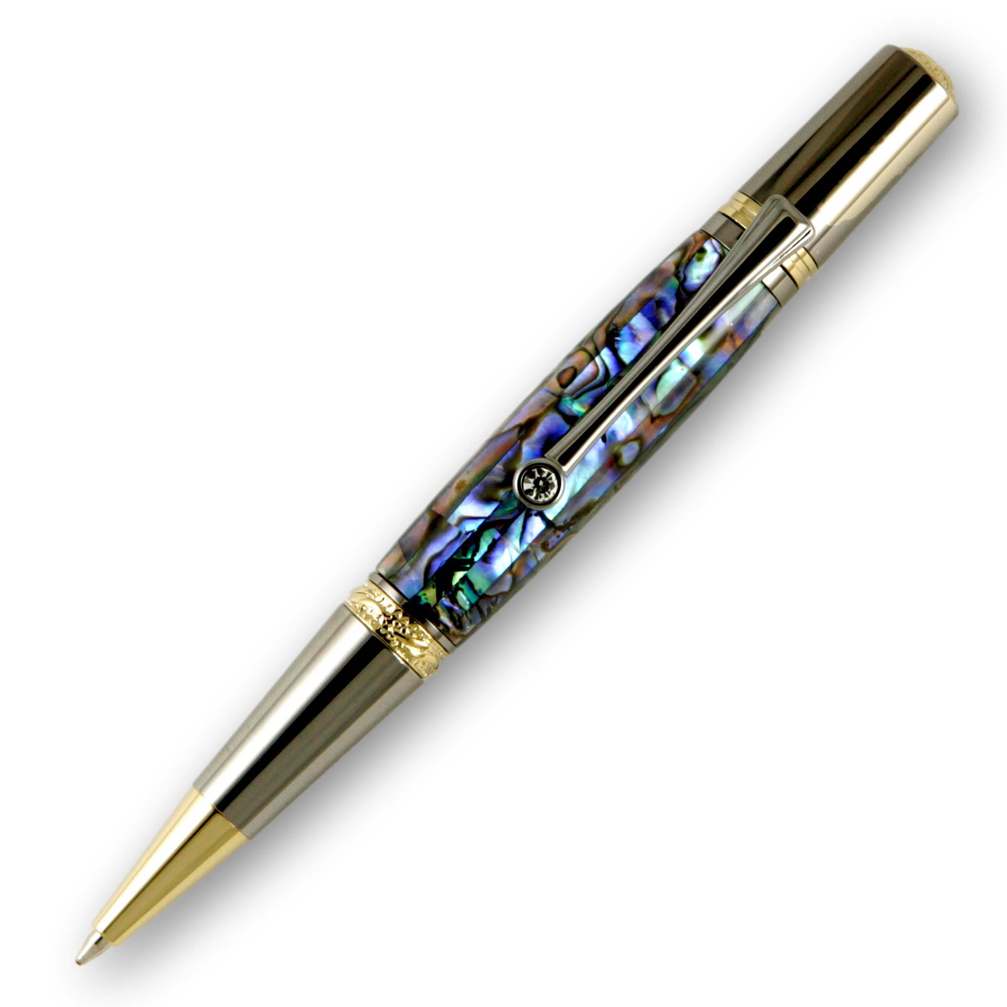

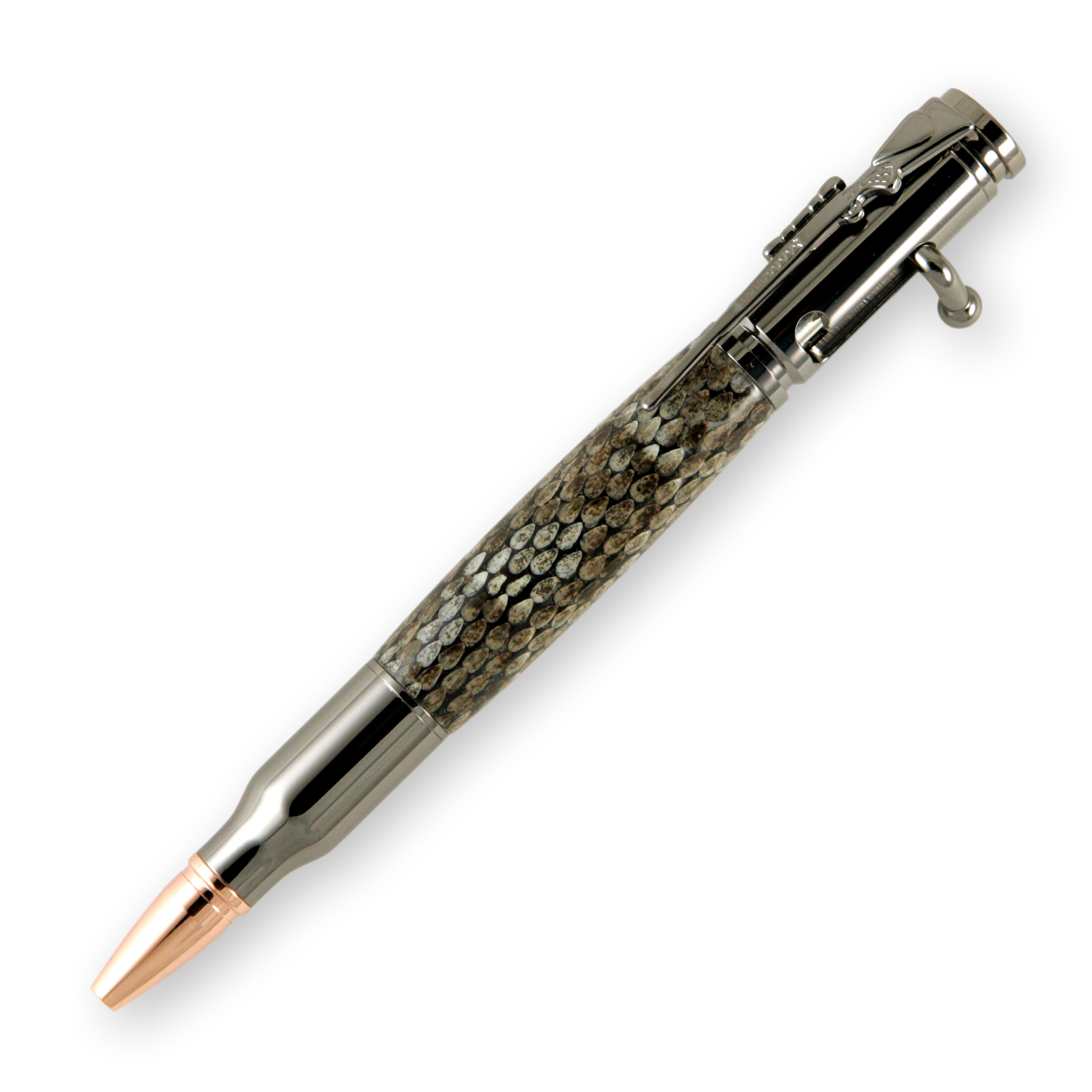

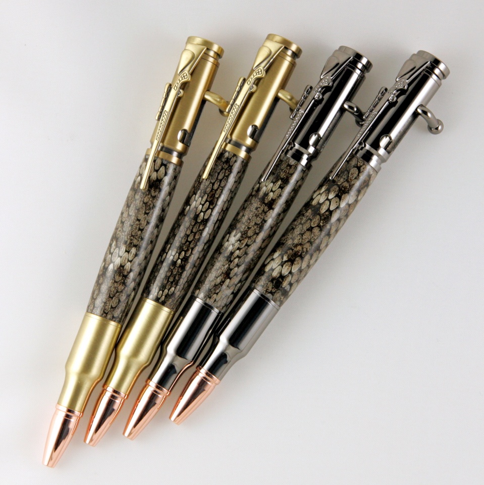

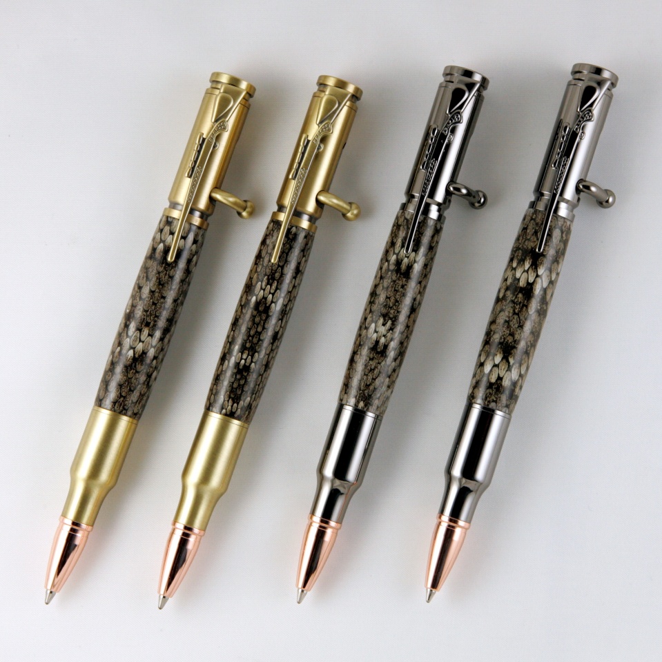

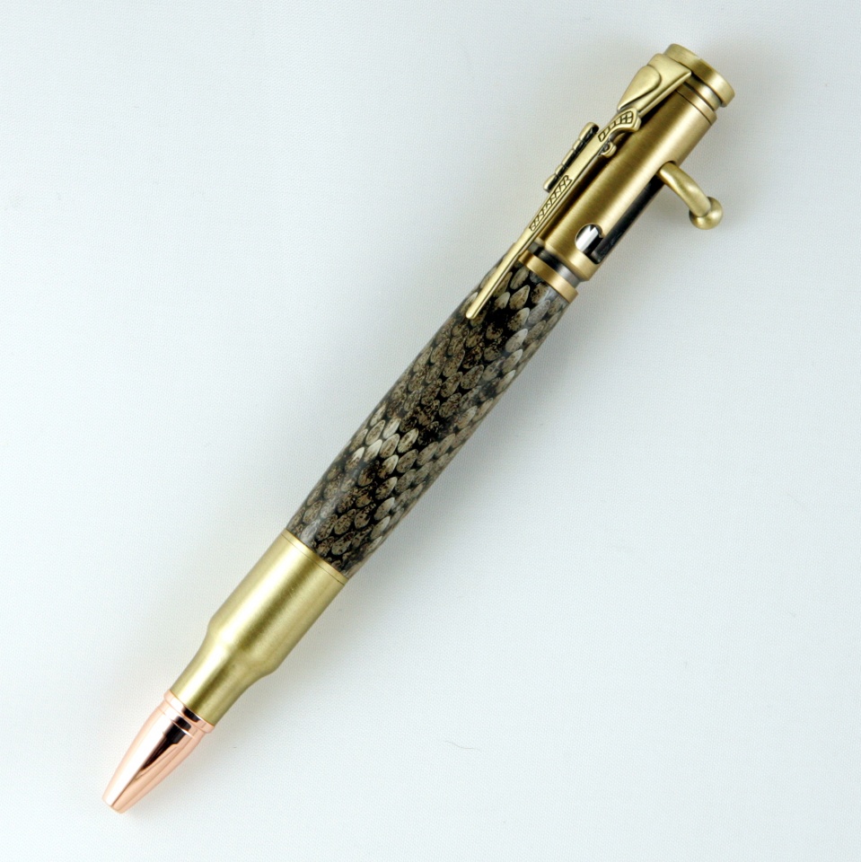

Casting My Own Abalone/Snake Pens!
See more from Rolandranch
Those are all beautiful.
Looks like you figured it out, Great Job !
Those are very beautiful, Seth !!!!! . Congratulations !!!!
Thank you all!! It did take a few different trys to get it right but I have had a great time casting!
Oh, and I forgot to give my younger brother credit for catching/skinning/tanning the rattlesnake skins. He's done a great job with them!
Fantastic Pens, Seth
Magnificent Blanks,

Thank you! My brother that does most of the skins is 15. Actually, all the "older boys" in the family take care of the snakes on the property (we can't keep them around because they are dangerous to our dogs and horses). However, Nate (the 15-year-old) is really into leather work and catches most of the snakes. The snakes that I used for the pens above were caught by Nate (15) and Stephen (13).
Great Job Ronald,

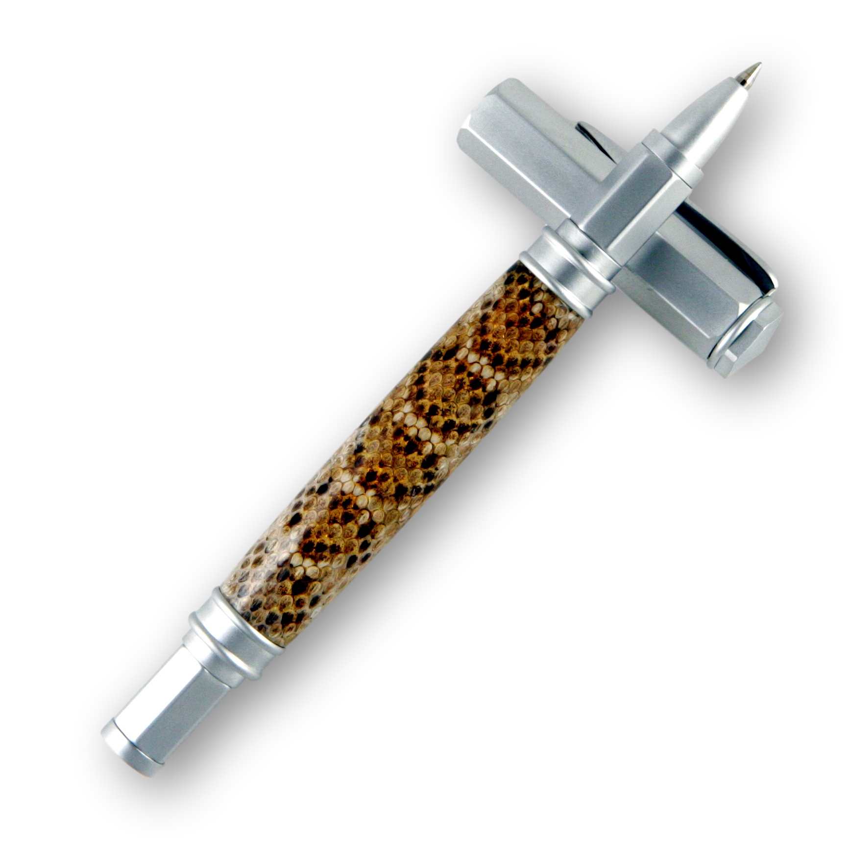

They look fantastic!!! I have a Copperhead skin I'm planning on doing soon. It's pretty see through, did you have to paint your tubes prior to casting?
Steve
Thank you! Yes, you will probably want to paint the tube if you don't want to see the brass. In the pens above, you can see that there are darker ones and lighter ones. The tubes of the darker ones were painted black and the lighter ones were not painted and you can see the tube a little (not noticeable in the photos). I have tried gray but that seems to make it a dull color.

I don't think I'd use more than one layer of skin just to try to save the skin. I have left some of my tubes unpainted and it does give it a bit of sparkle which I don't mind. It kind of adds another dimension to the skin.

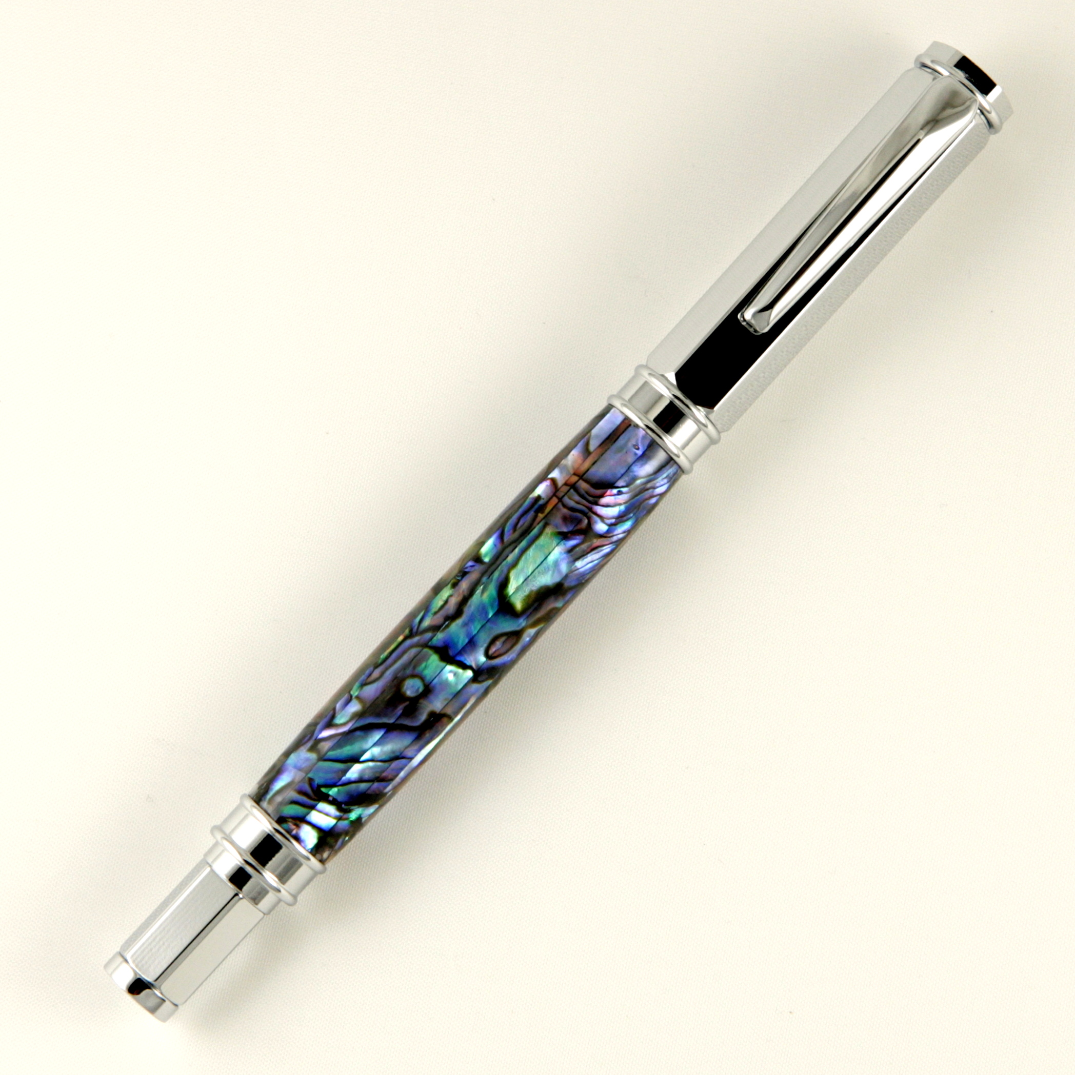

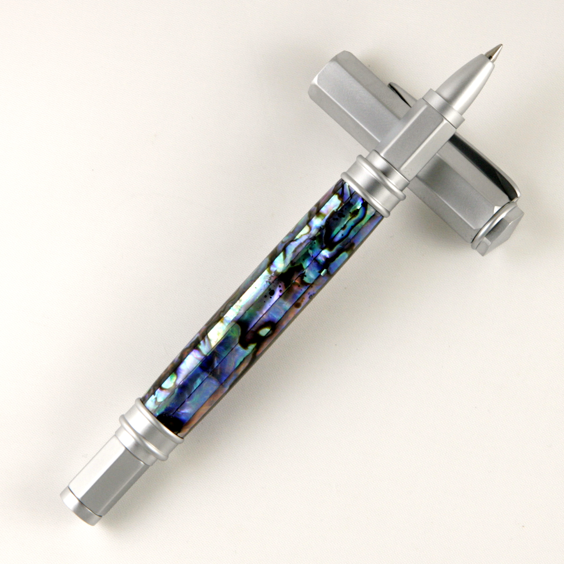

Those are amazing! Can you walk us through your process? I've tried casting snakeskin and had marginal results. After removing the scale casings, do you coat the skin with anything before you cast? Do you use pressure, vacuum, or neither?
How in the world do you get those abalone strips? Are they purchased ready made, or do you cut them yourself?
Thank you. There are articles written on both these topics in the IAP Library that I have learned a lot from. There's a lot of useful information there.
Some people buy already cut strips but I buy whole sheets of abalone and use a razor to cut them.
I have not had consistent success for casting snakeskins yet, though I am getting there. I wash the skins with soapy water first and then descale them. I have tried coating the skins with different things - thin CA and clear acrylic spray paint. Thin CA works better. However, if you are using skins with larger scales, it looks better uncoated. Again, I'm still experimenting and this may not work for your specific skins. It seems that different types of snakes take different methods.
Edit: Just to add, I don't use vacuum or pressure. I use heat. Not too hot, maybe 100-130 degrees F...not exactly sure what temp I use but I've had best success with heat.
How did you cut your abalone parts to fit around the barrel? They are beautiful blanks. Thank you for the pictures.
Brian
Thank you! It just took some careful calculations and a few test runs to get all the strips the same size.

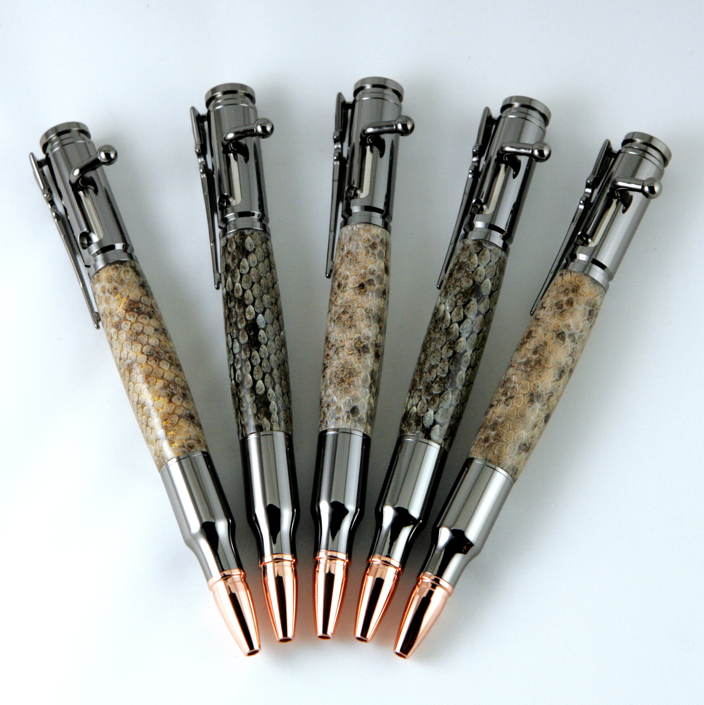

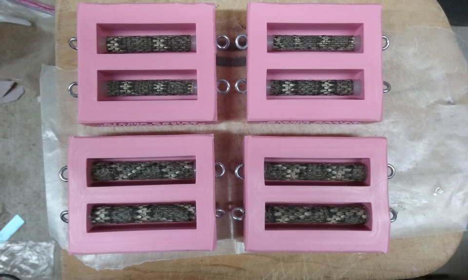

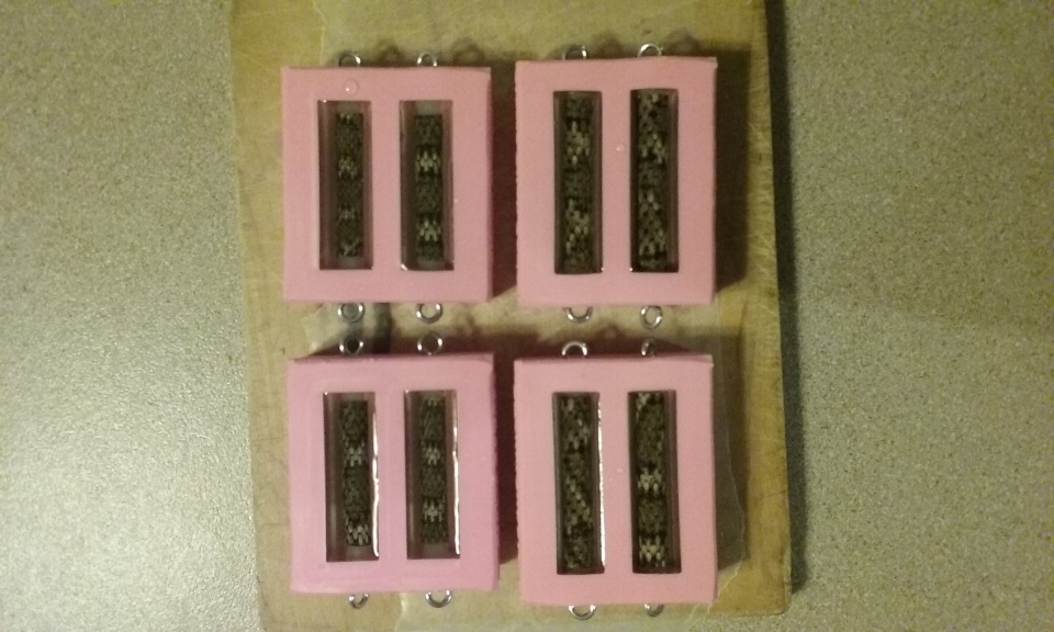

Alright, drum roll. I put 8 blanks in the oven tonight. 4 bolt action and 4 Vertex. We'll see what comes out tomorrow. I got some molds from PtownSubbie and am surprised at how much resin they save. I only used about 4 oz for 8 blanks. Thank you Mr. Ward for all the tips and for taking the time to share your method. I'll post pics soon of how they turn out.

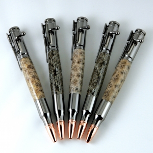

I finished all of the bolt actions last night and they turned out very nice. This is definitely, by far, the best batch of snakeskin blanks I've ever made. Thank you again for all the tips, Mr. Ward.
