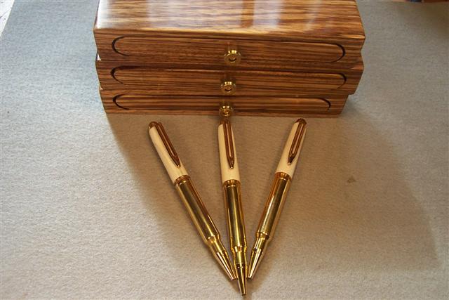

Originally posted by guts
<br />Eagle,do you then drill and add the tubes or do you just use the wood and eleminate the tubes all together?
Glue the tube into a hardwood blank.Treat as any other pen blank.
Mill etc.
Turn it to fit inside the casing,
(this is not a tutorial, I gave you the cliffs note version of how I do it)
I can put just about any kit in any casing (with a little bit of modification here and there.
I am not limited to slimlines and 30-06
!8K gold winchester 338's with wart hog tops, zebra wood boxes
