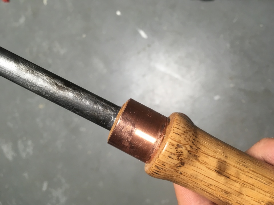

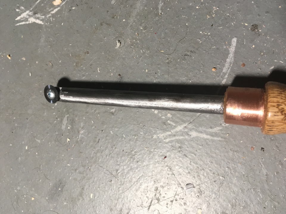

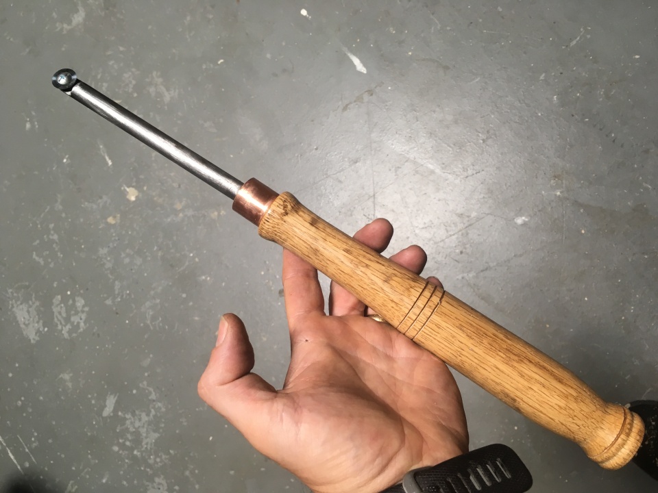

Been looking at carbide tools for a while but they tend to be expensive. After reading more about them, I decided to make my own carbide finisher. It's a 16mm carbide insert on a 1/2 steel rod. Made the handle from oak. The whole thing may have cost me $15. Works great. May not be the prettiest but my next one will be better.

Great job! I have one ready that I just need to finish turning the handle (embarrassed to admit that I've been using w/o a handle for several months). They are pretty easy to make for a few dollars.

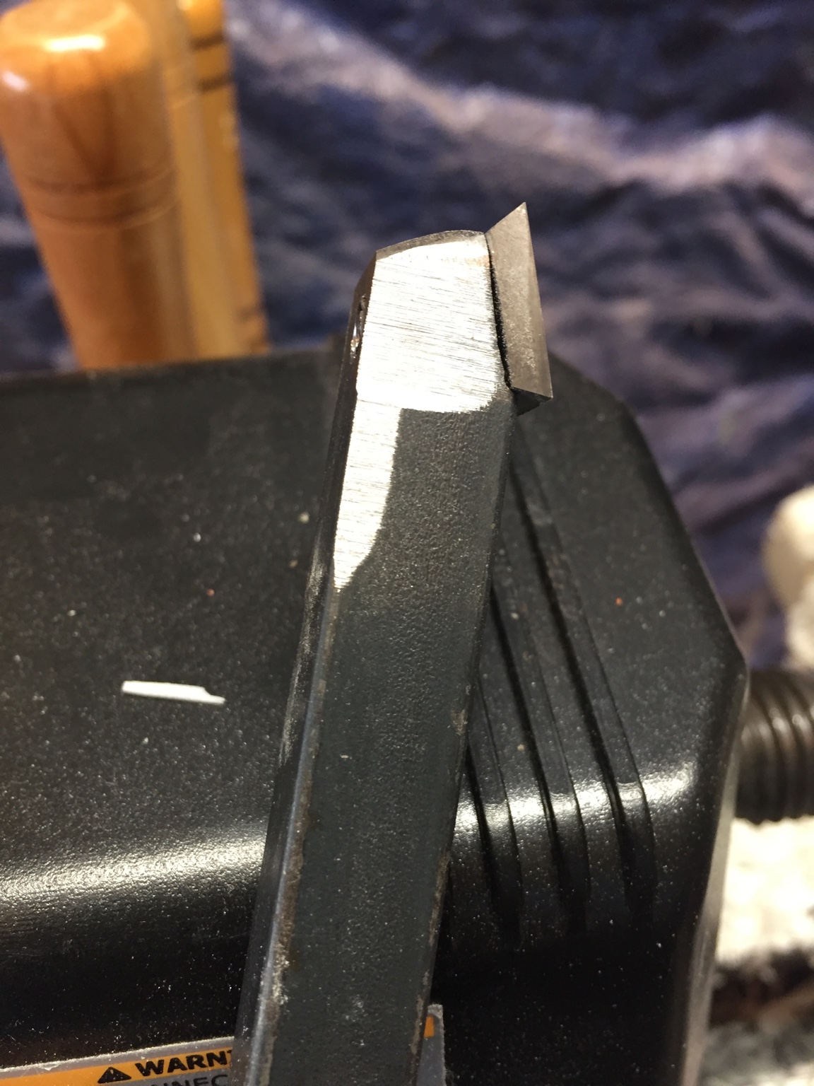

Now that I've made a few of my own, (and painted the handles with "Unicorn Spit", to emulate the red and yellow Easy Wood Tools!)
I'm wondering if I should have used square stock set at an angle like the Pen State Industries "Carbide Magic", "Sorby 45 degree shear scrapers", and a few other manufacturers?
I set my carbides flat onto the square stock, so they are scrapers and not skew like cutters.
Wonder if more and more manufacturers will go to this design, to improve the cut finish?
Guess I'll have to make some more to compare.
AND use a negative rake cutter for the ultimate pen tool! ;>)

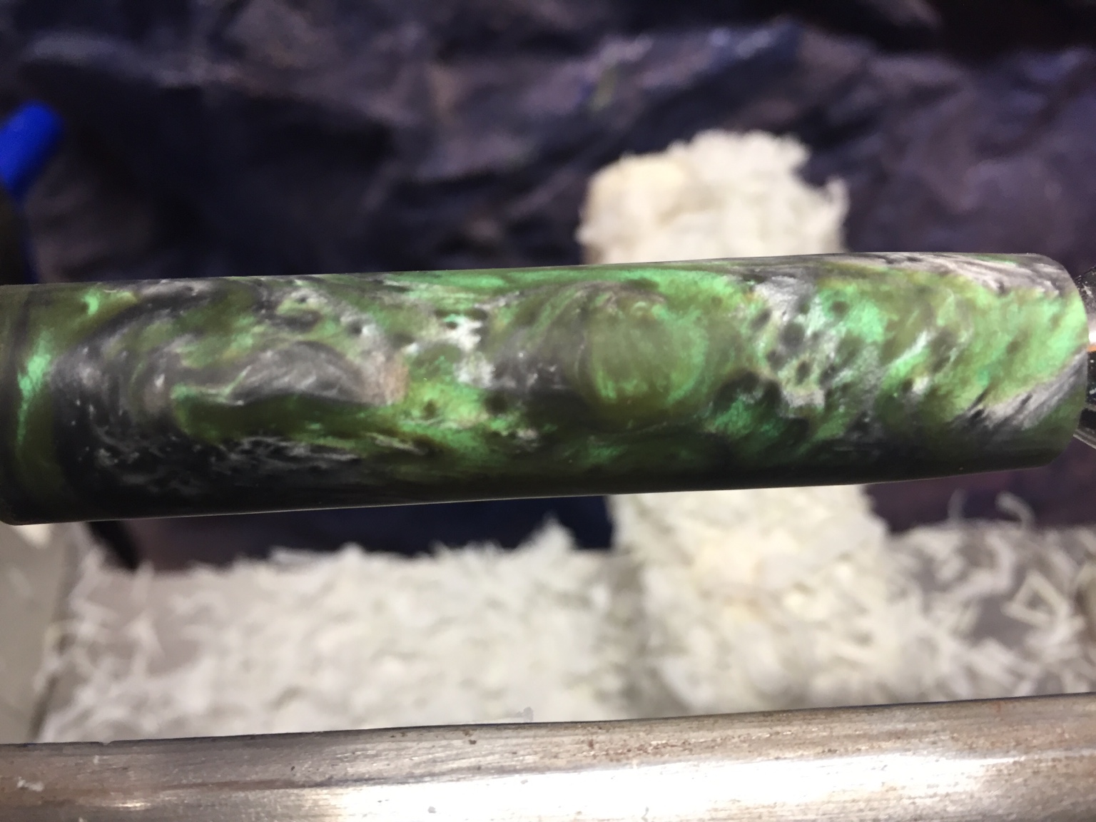

Marco, might as well make a negative rake cutter too. Here is what the "as turned" finish looks like on a piece of inlace acrylester.
This was turned with a $2 carbide insert attached at a 20 degree angle.
