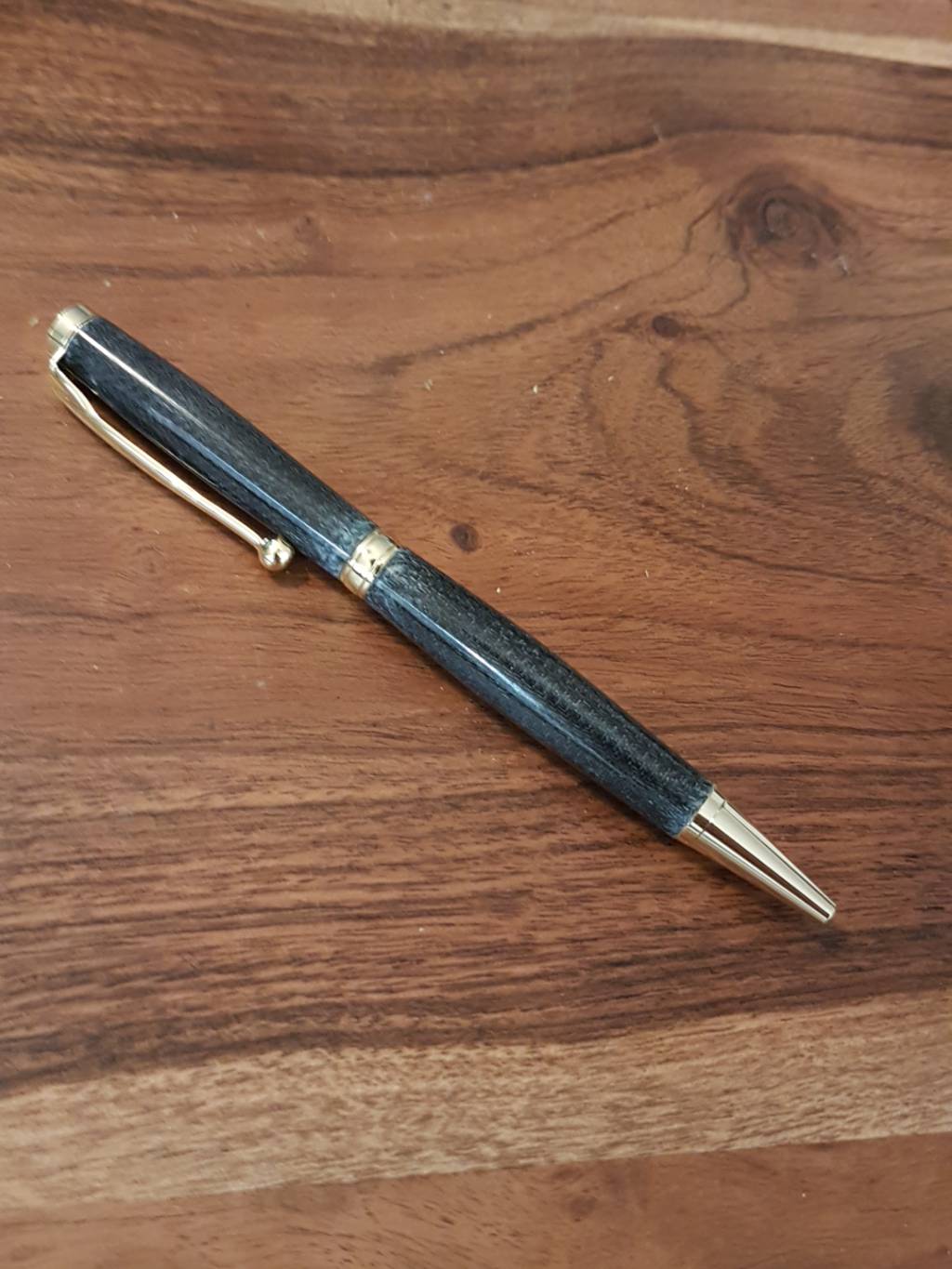

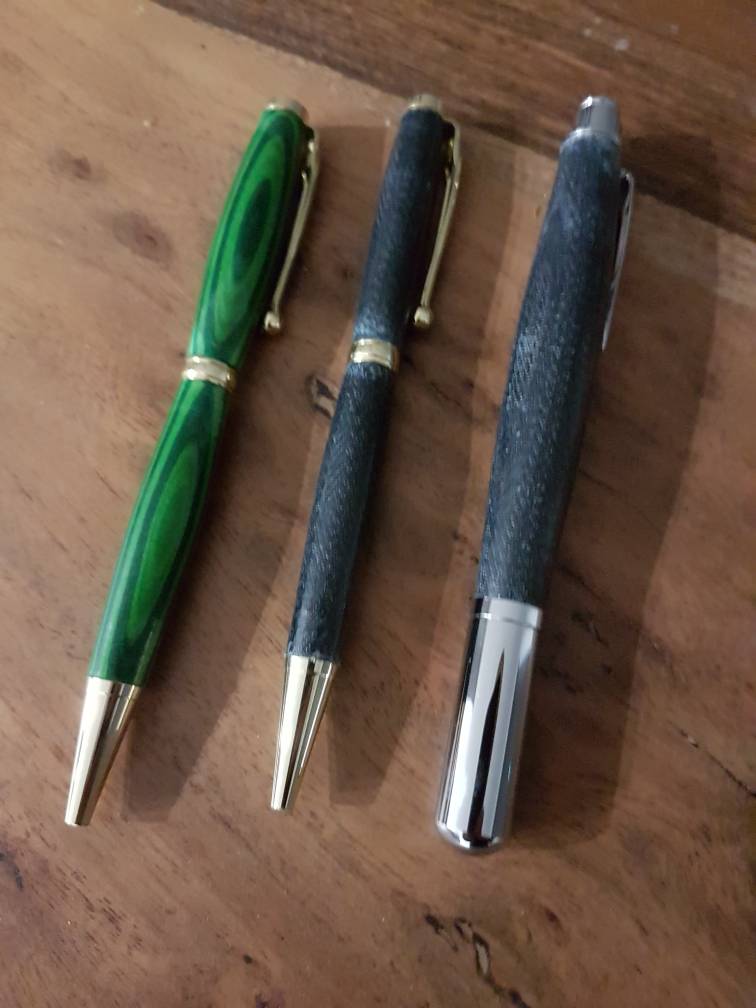

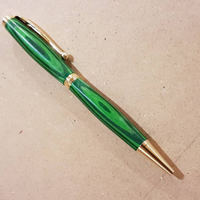

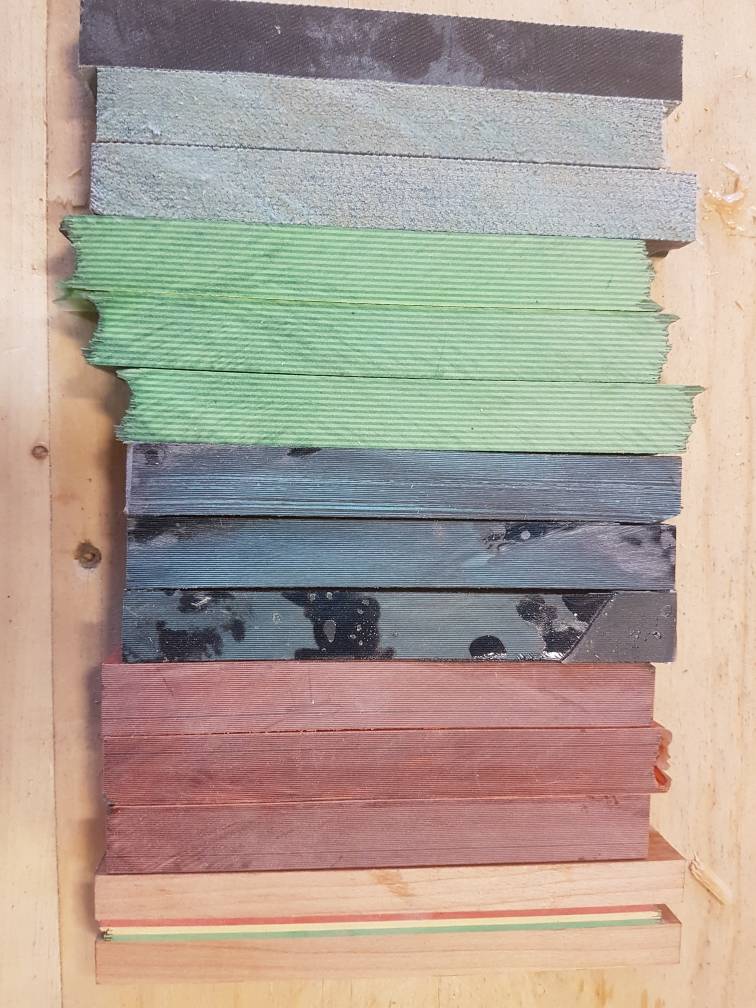

Those are some of the work I made. The blank are all casted by me.
These casting in the picture is a laminated using different material.
Sorry I didn't take time to take good picture yet
Sent from my SM-G930W8 using Tapatalk

See you are on your way. Everyone of those pens had a different shape. You will soon learn too with slimlines the material is way too thin on the ends to use cast blanks like that. Need to step up to some beefier kits. Even cigar kits will be better for your blanks. That is why in pen turning a duplicator is useless. be your own creator. Like I said not picking on you. :)

Those are some nice pens.... Good Work!

First, those are very nice pens. Keep up the good work! Second, thank you for posting this question. I'm sure that several of us newer folks have wondered about Duplicators at one time or another.
