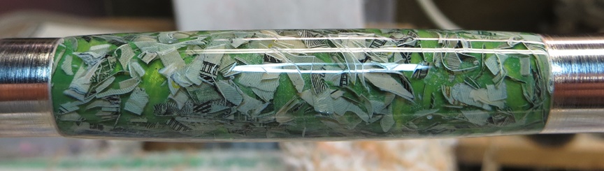

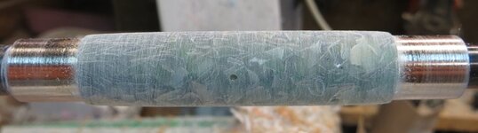

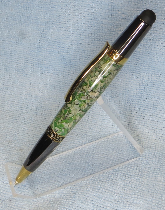

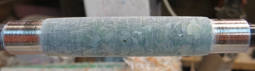

I hate inlace acrylester, and rarely turn it. When I do, I always use sandpaper for final shaping, starting with 100 grit. This money blank is either inlace acrylester, or turns just like it, and I hated it. But my friend was set on a pen with it, so I persevered.

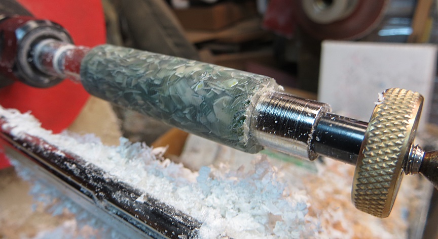

Late to the party; I normally have no trouble with IA (I just ordered some and Karma will get me!:)). Just use the tool below center and peel off endless ribbons. You can't "hog off" material this way, a light touch is needed. My goto tool for acrylics is the lower one below; presented below center.
The negative rake scraper can be used, but it just changes the geometry of the blank to tool contact point.

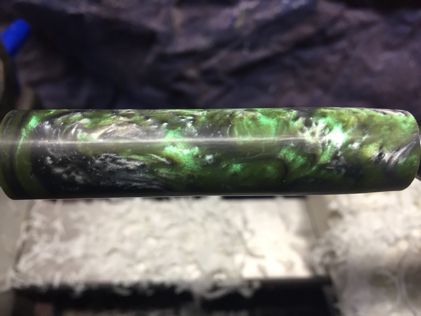

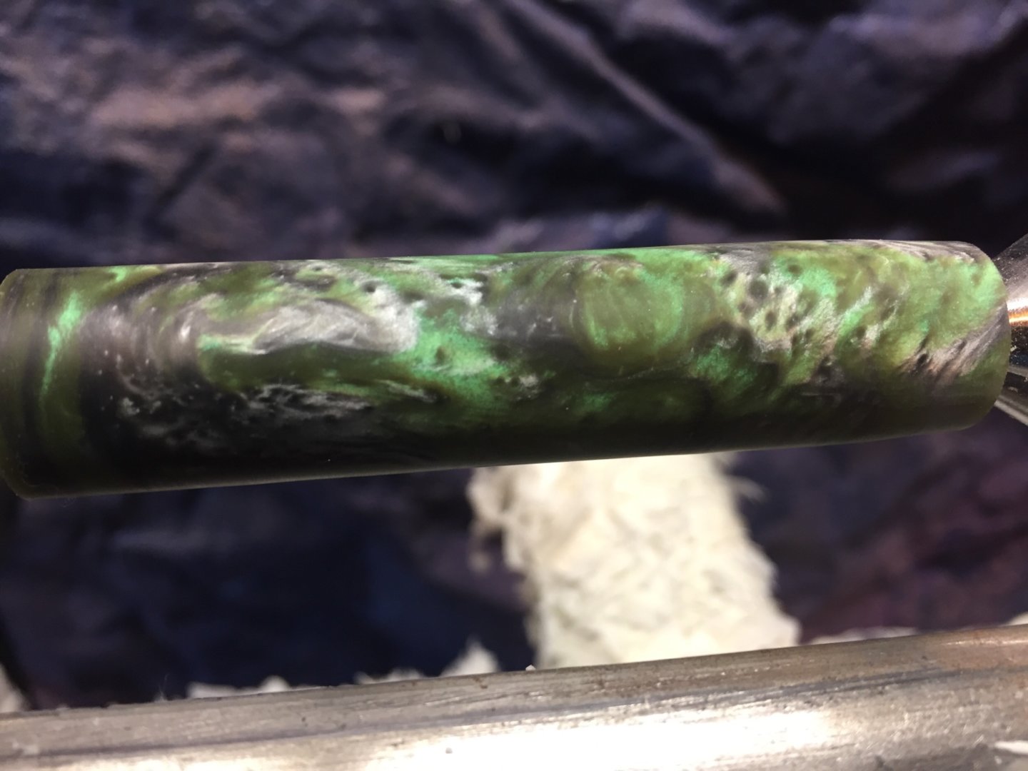

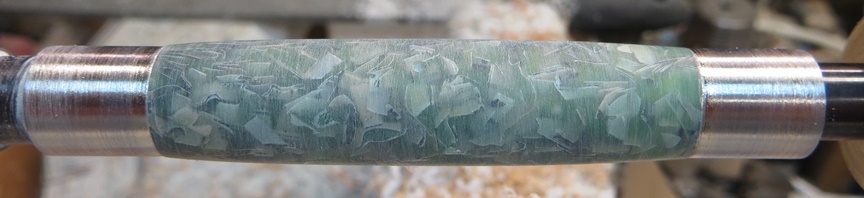

Here is some IA turned with a regular carbide cutter mounted with a 20 degree negative rake. No sanding and only polish on the first picture and as turned on the second.
Sent from my iPad using Penturners.org mobile app
