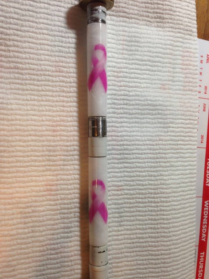

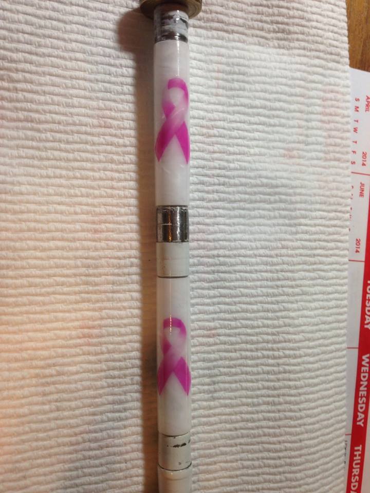

As a survivor, I have made dozens of pens for other survivors. My pal Susan back in Ca just finished all chemo and rad so I made her a Perfect fit in Pink Ivory. I would encourage you do something a bit different; I don't put a finish on them for example...the person isn't finished yet, so neither is the pen! Just something that mattered to me and felt appropriate.
Water slide decals work well.
