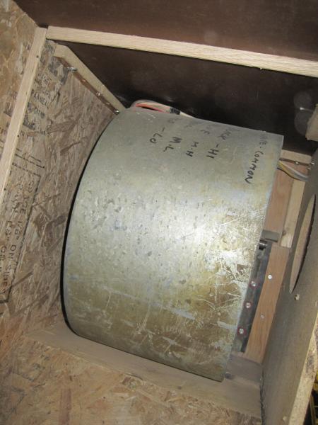

bradh
Mar 9, 2005
688
Aurora, Ontario, Canada.
I am getting a new furnace installed tomorrow. I am debating if I should keep the old unit to remove the blower unit and Frankenstein it up as a DC system? Just trying to figure out how it could be done. I am sure it can, just need to get the plumbing figured out too.
OR is this just a wishful thought.
Yes you can:
http://www.turningshop.com/workshop-dc.html

I used the blower from an old window unit to build my filter system. Box with fan inside sucking through two regular furnace filters to catch the rough stuff then a final #M Filtret purple filter for the very fines. Works great. Two speed motor on the fan allows me to choose what fan speed I need at the time.

are you sure you're not from somewhere below the Mason Dixon line? That looks like something I would have thought up on one of my good brain days! Nice work! I like the speed switching especially :)
Nope, I am from the great white north. I like to see what I can make from other people's trash. This unit has a fan from an old furnace I grabbed before it went in the dumpster and most of the wood was scrap too.
The fan has four speeds, so I just rigged up four switches to power the four coils. It gives me plenty of control of the speed. The beauty of this beast is how quiet it is, you only hear the air flowing into the gates.
