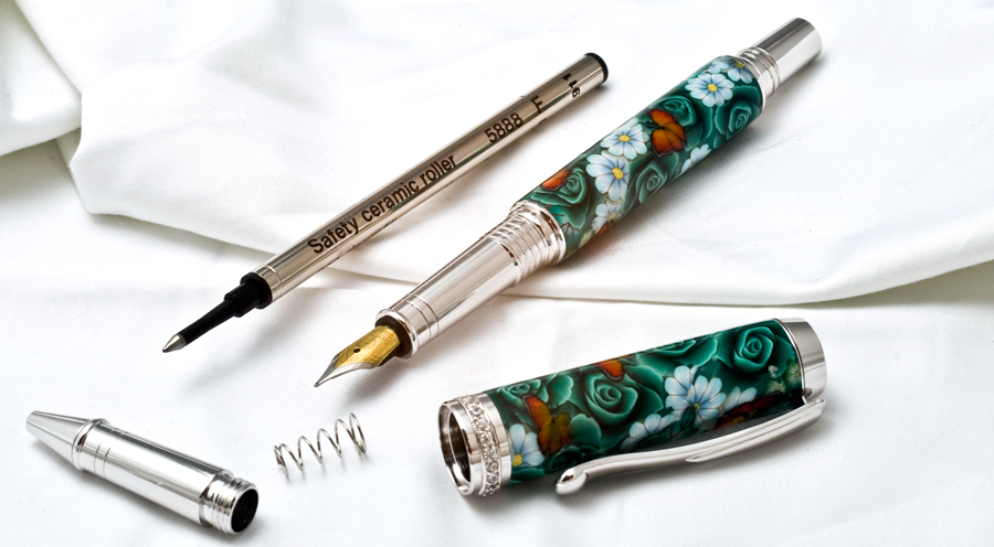

Can a Venus Rollerball kit be converted to Fountian?
Something like this you mean?
attachment.php
OK I tried this this weekend with a Jr Statesman FP nib and the threads are not compatible.. The statesman has a fine thread the the Venus is a coarse thread.
Does the Jr Gent have a different nib thread pitch than the Statesman?
I can just swap the press in ends but I got a Black Ti kit by mistake and the statesman kit I have is rhodium.. My wife likes the black Ti finish so now I need to order a Black Ti Jr Gent FP kit to get the right mix.
