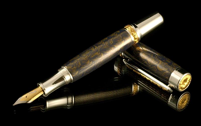

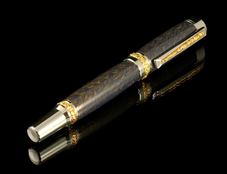

There was a time that I was wondering, what is so special in M3 that it is so expensive. Now I know:)
Mike told a good story about production of this material and why it is expensive in production here, and it DOES help to sale them:)
And actually, this material looks much better in hands then on a foto.
Anyway, one of the pens I made from M3 and that was grabbed instantly by my retailer.

Simply gorgeous pen that you have created there.
Perhaps once you understand and try carbide tools, your opinion may change as it has with your M3 tryout.
Eh... Wrote long response and browser crashed...
Thanks for compliment.
