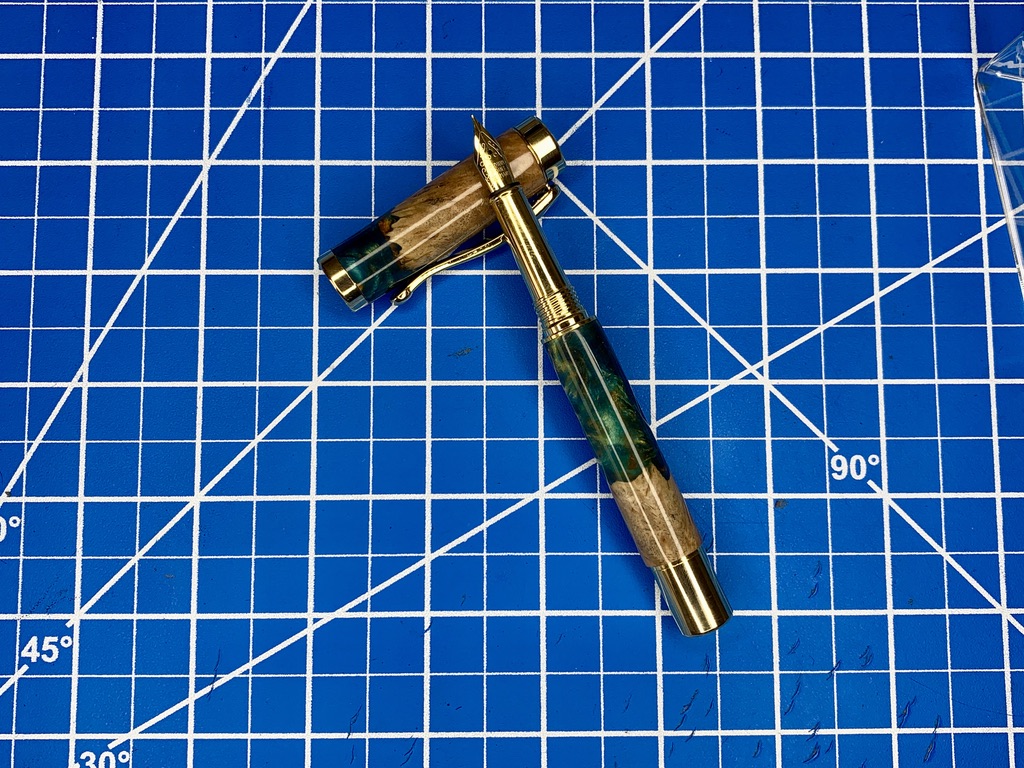

This was my first GluBoost pen. Tried it the other day. I watched Mark's video and this is the result. At first I swear I thought I watched a video somewhere that didn't use micromesh. I got to the point of 3 coats of Orange and said, it needed to be polished. Did it and was very pleased.

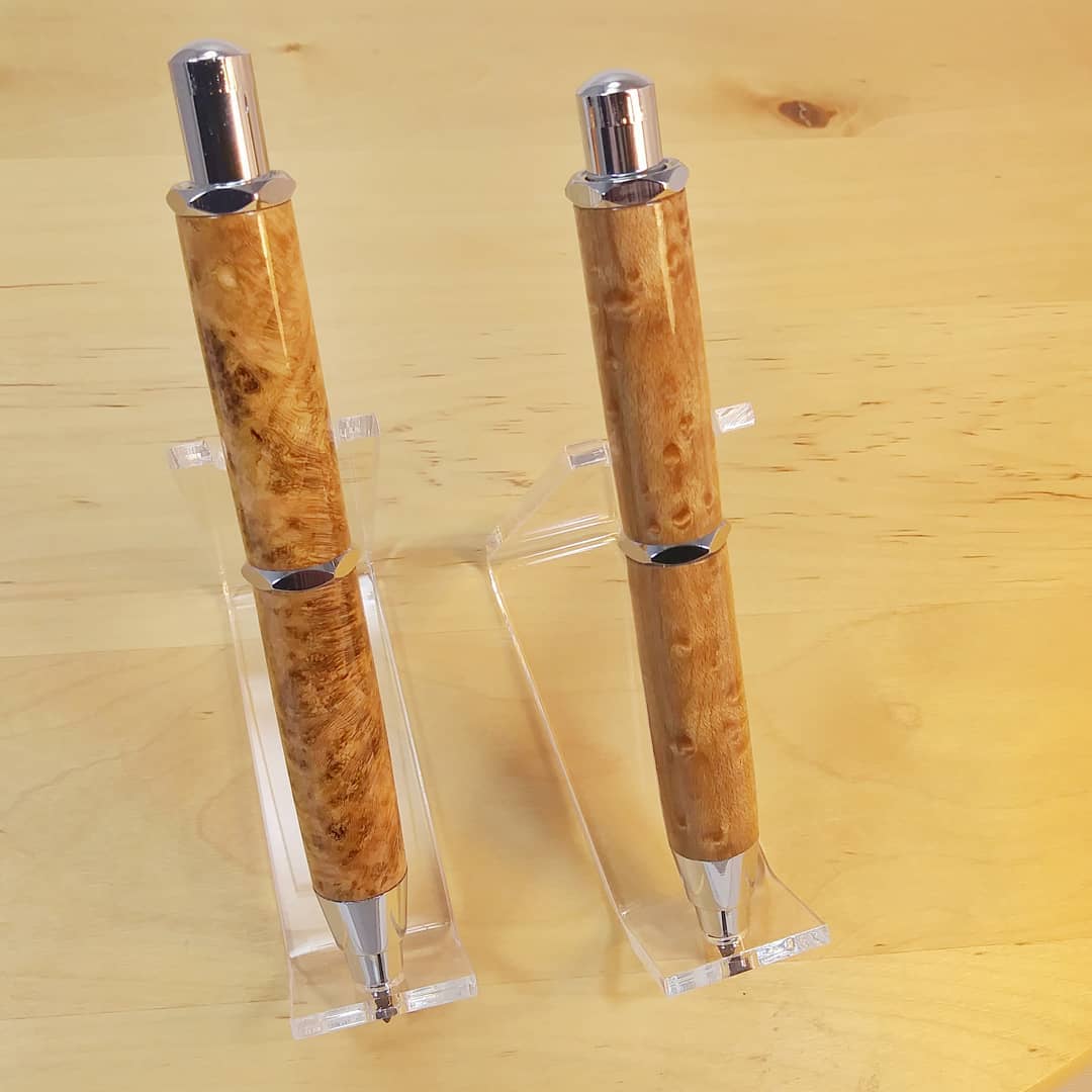

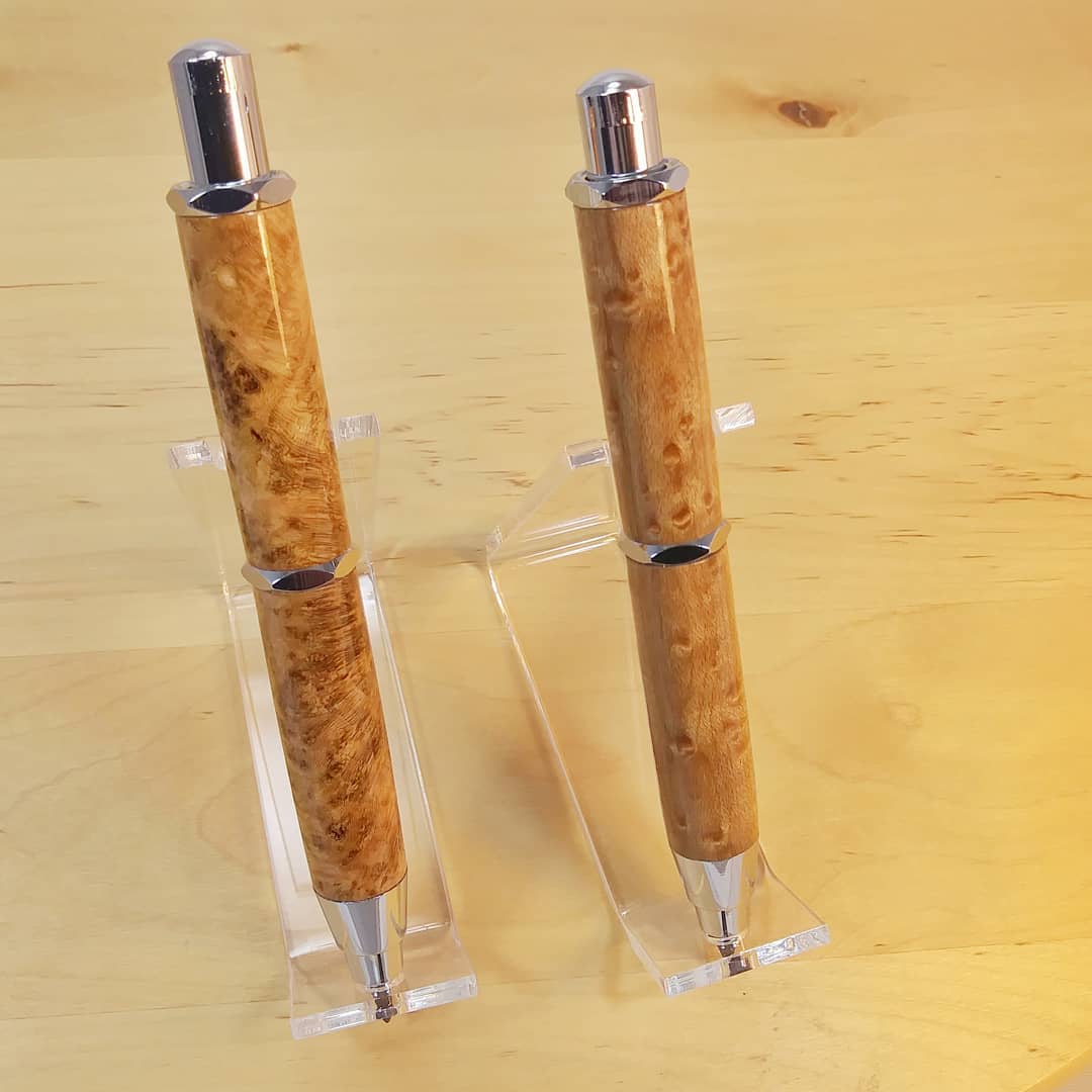

I was lucky in the BASH losers' train drawing and got a certificate to PennState; I put it towards a GluBoost kit, the first time I've tried it.
I made a couple of clutch pencil kits that I found, and finished both of them the counter-intuitive way per the instructions - thick first - thinking to myself the whole time that this is not going to work.
Very happy with the result (full disclosure: I use 3M Tri-mite papers rather than Micromesh)
