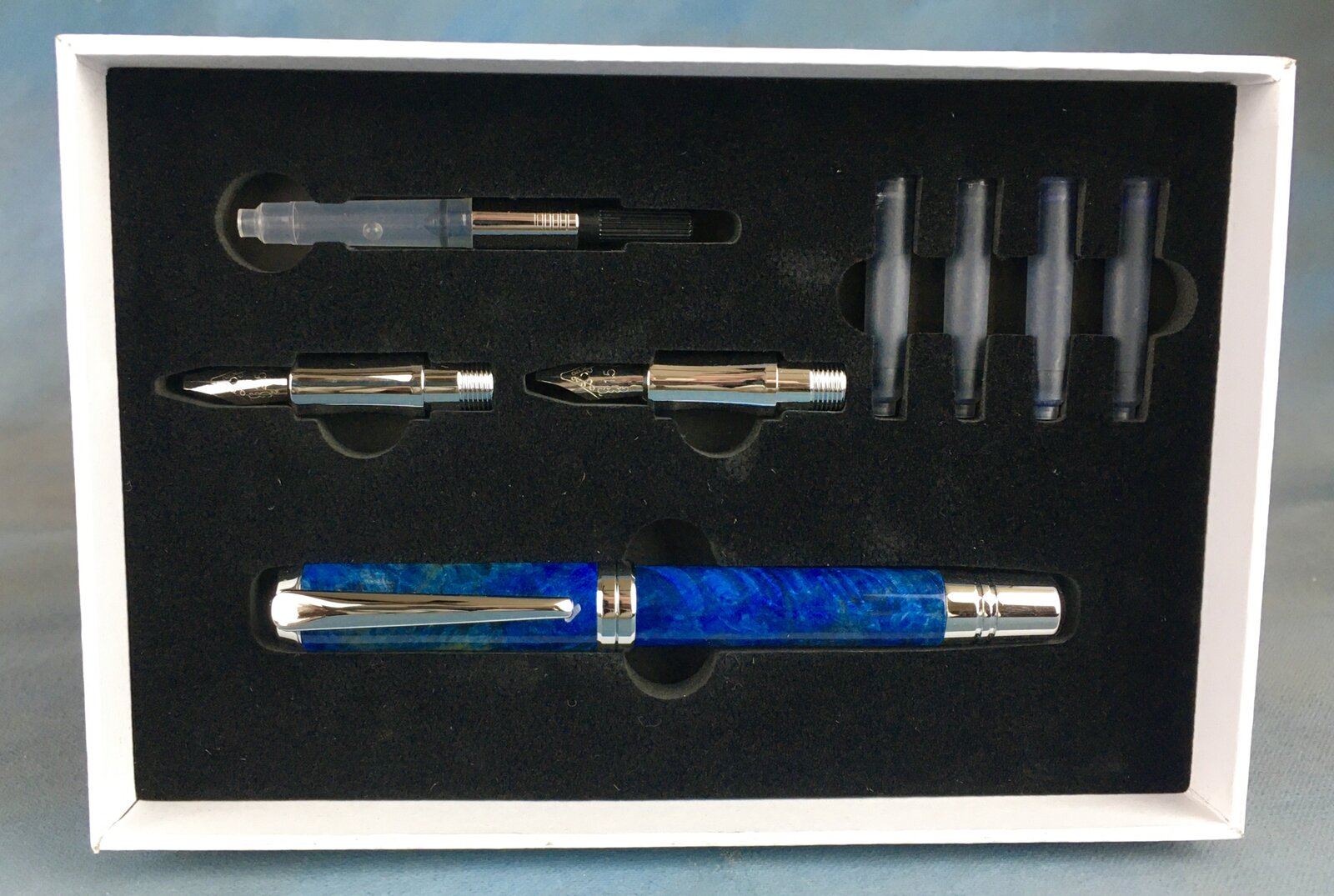

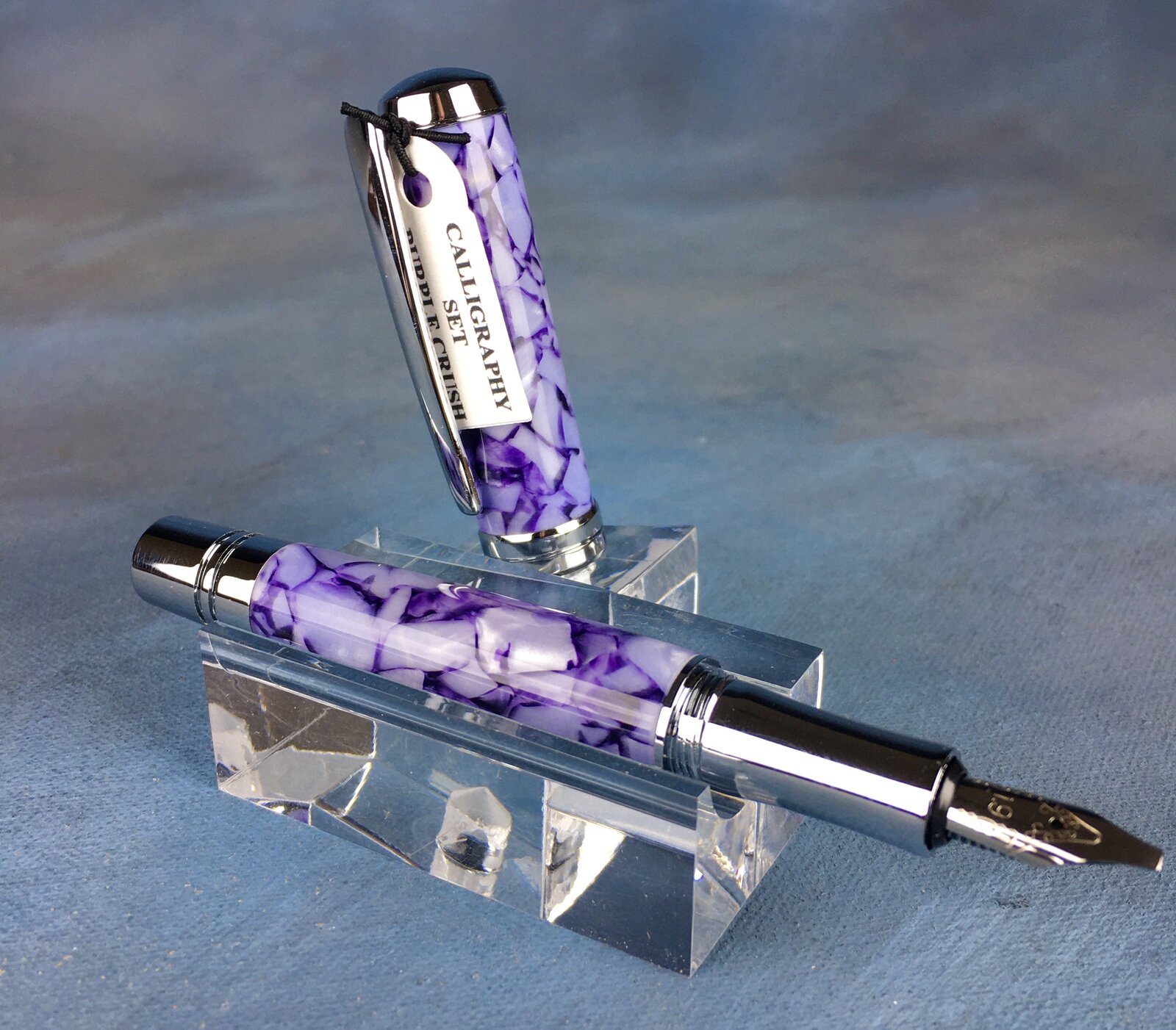

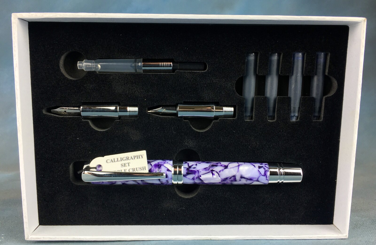

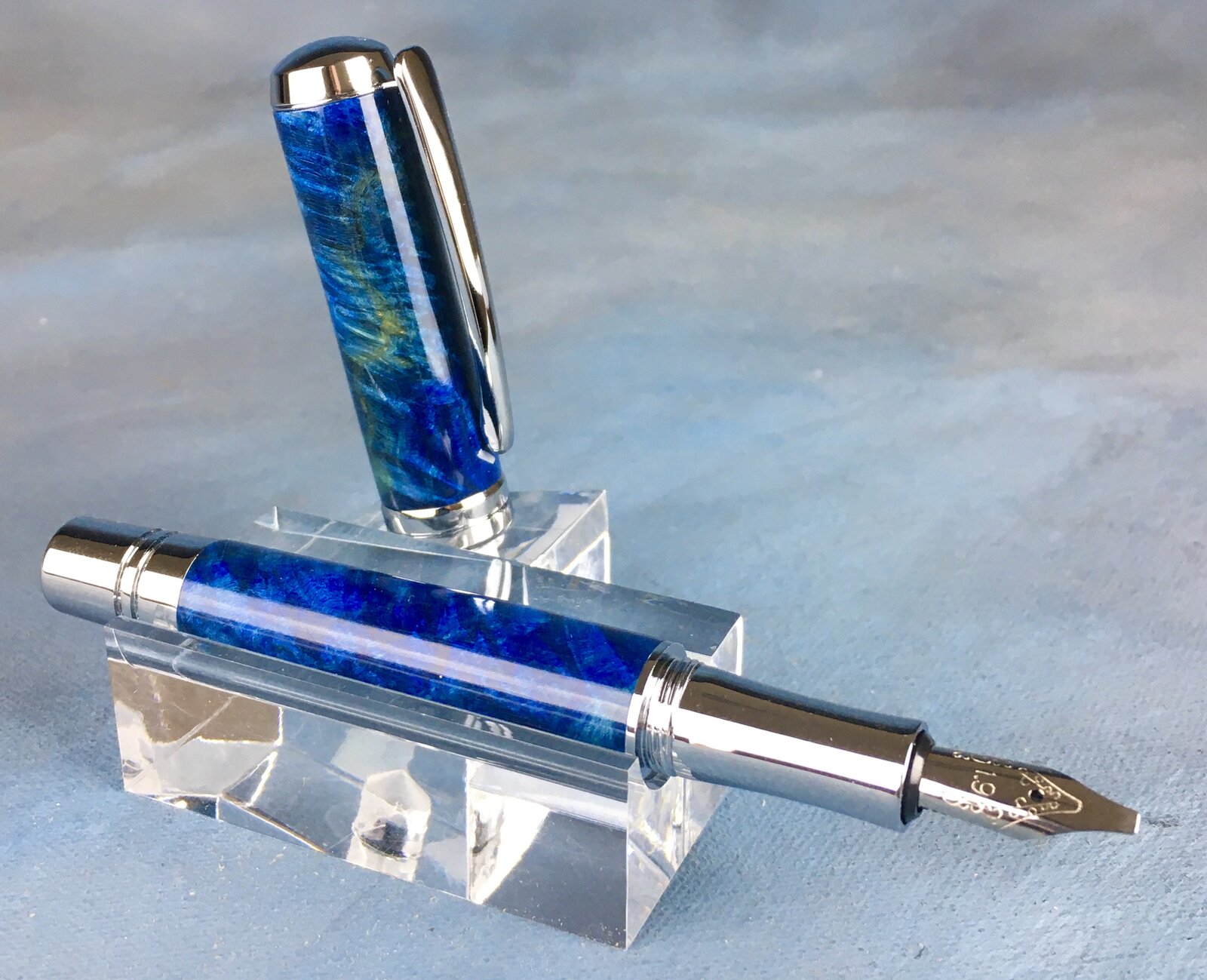

I saw these and it instantly connected with requests I have had to sell calligraphy pens. The boxed set looks great with three nibs included with ink cartridges. I'm making two for now to test the waters.
Shipping takes a bit longer from Canada but worth the wait.
Sorry about the tag as they go on display later today. One is purple crush and the other is blue dyed box elder burl. Finish is four coats thin 5 cps EZ Bond and twelve coats of pen finish EZ Bond 50 cps.

Thanks. It has an odd thread arrangement compared to jr or other 12.5 mm 10.5 tube kits.
Mark, I believe Darrin meant that the nib/feed/housing will unscrew from the metallic section, and those threads match the JoWo #5 housing threads.
I bought some of the kits and hoped the nib units would be either JoWo or Bock so I could swap out nib units if somebody would prefer one standard nib and a couple of calligraphy nibs. (Or steal a calligraphy nibs for one of my custom pens, I've made several that take JoWo #5 units.)
Yours look excellent, I'm especially drawn to that royal blue.
I admit a lack of experience with swapping nibs, but that does not mean I can't learn or don't wish to learn. Please provide a link to a JoWo #5 so I can investigate. I really like to give customers a wide range of options. Thanks for your help.

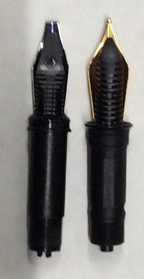

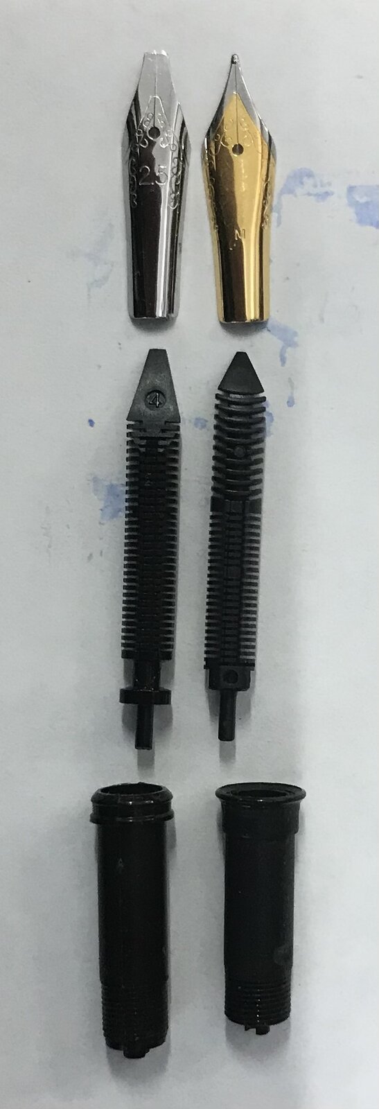

@mmayo
That is somewhat the idea, except that they won't actually swap out by screwing in the feed housing. While I think you can swap out the nibs themselves, the feed and housing are longer with the calligraphy nib. This could be a problem when just swapping nibs, as I believe the feed and housing on the calligraphy nibs are designed to provide more ink for the broader nib.
The thread on the calligraphy housing however, is the same as the #5 Jowo 6.5x.5 (I use a 6.4x. So if you make your own sections, you can create one to fit this nib set.
That being said, I just checked and it appears that the metal section of the Eros set is a 9x.75 thread, which I believe is a much more common tap available at Victor Machinery
You can purchase the sections with nibs at William Wood-write, individually, for an excellent price.
It looks like you can get the Jowo tap at Turners Warehouse, or FPNibs.
I hope this helps a little.
@mmayo
View attachment 301619View attachment 301618
It helped a lot. I'll visit William Wood-Write to determine what to buy. It would seem to fully populate the kit with both regular writing nib AND the calligraphy nibs might be a very good call. Thanks
