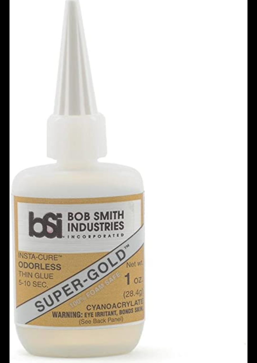

BSI (Bob Smith Industries) Super Gold Thin.
No odor, no cracking and no chipping when removing from bushings.
