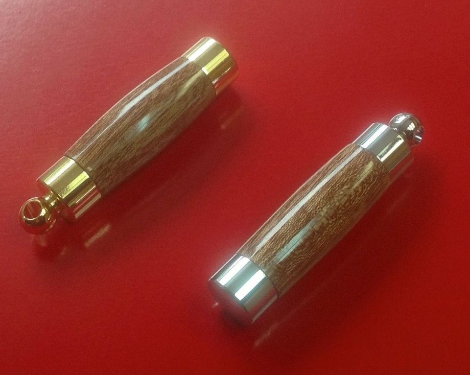

Newbie's $.02 worth
I hesitate chiming in here, because I undoubtedly have fewer hours in the craft than anyone on the forum, but....
I had issues with CA finish when I first began. I am quite sure it could be traced to the brand of CA I was using, since I changed brands and the problem went away.
For what it is worth, my procedure gives me excellent results. It is basically the same thing I remember when I watched Barry Gross's finishing tutorial at a recent Woodworking Show. If it isn't, it is my error, not his.
First, I sand the blank at a high speed, starting with 150 grit, going down to 400. For me, this is a critical step, because my work with the carbide tool sometimes leaves tiny defects in the surface that show up later when I apply CA. I spend more time with the lower two grits, making sure that the surface is completely smooth. The other grits, just enough to remove the sanding marks left by the previous grits.
I vacuum the blank and the whole lathe area to remove any dust. I then thoroughly clean the blank with DNA, using more than one cloth if needed.
I then apply multiple (8 or 9) coats of medium CA, using accelerant VERY JUDICIOUSLY after each coat. (Could I emphasize JUDICIOUSLY more?)
I then go directly to my micro mesh pads going from 1500 to 12000, and I always sand wet. I have never had a problem with the wet sanding. The finish is mirror-like.
Like I said, others will not agree with my procedure, but this works for me.
