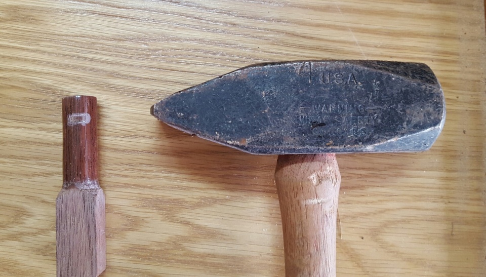

Over the last year or two, I've heard several people question the overall durability of CA as a finish, so I though I would do a little test. While fairly simplistic, it still shows how well CA can hold up.
I turned the end of a piece of walnut and then finished it with thin & medium CA. This was just a quick finish and not the quality for pens, but enough for this test. The walnut was in my garage and was about 45 degrees. In order to simulate weather/temp extremes, after finishing I put it in the freezer for a few hours and then placed it in a coffee cup where I let the Keurig dump 192 degree water into it. After letting it soak for 15 minutes, I took it out for inspection. Even without sealing the end grain, it looked the same as when I took it off the lathe.
Not quite satisfied, I wanted to see how well it would stand up to an impact, so I hit it with a sledge hammer. Of course it dented, but the surrounding CA is still intact.
While not an "instant" finish, it is one of the faster to apply and makes a very durable finish.
--Robert
--Robert
Now THAT is a "convince me!" post!!! :eek:
You, Sir, have made heck of a point there and I'm quite happy that no coffee was harmed in the making of this post.
