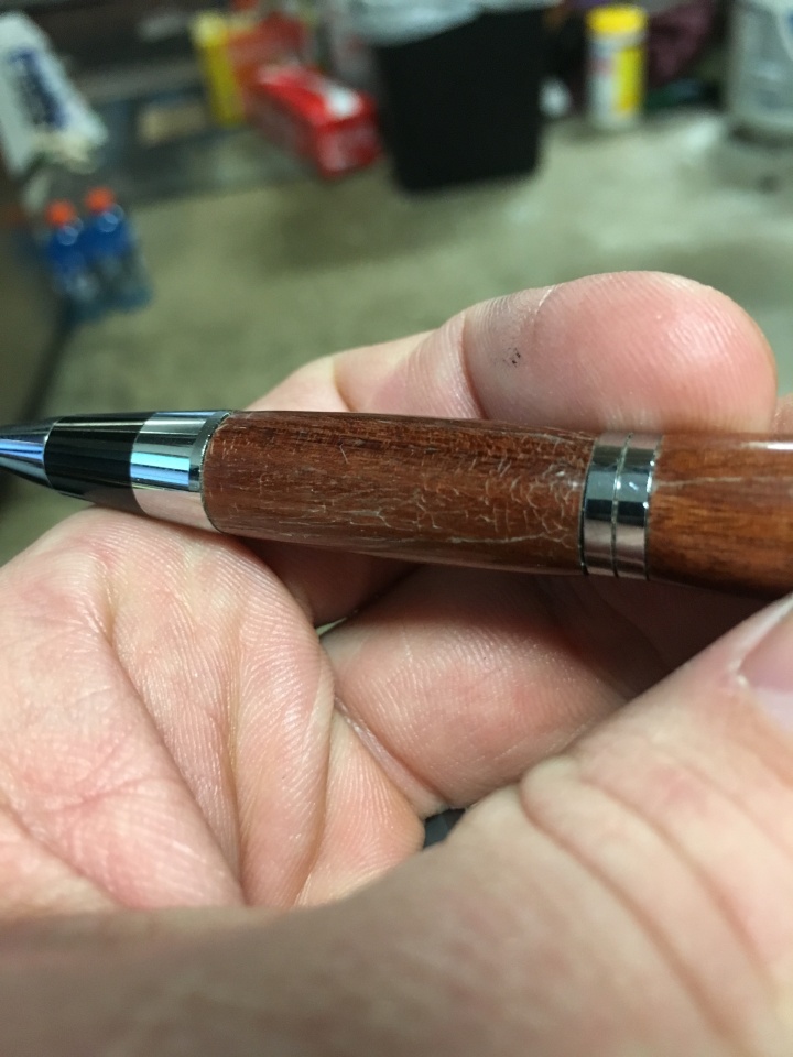

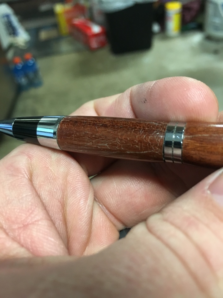

I've attached an older pen showing some of the issues I've seen.

Hi Ken - If you have the time (and are willing to invest it in a pen finish), then more traditional wood finishes (polyurethanes / lacquers) can give super looking and very durable high gloss results. They can still be dinged up by abusive treatment (just like fine furniture), but in my experience are more durable than CA over time.
I'm partial to the lacquers because they polish easier than polyurethanes, but the fumes are a major drawback.
Another alternative is encapsulation in a clear resin.
Ed

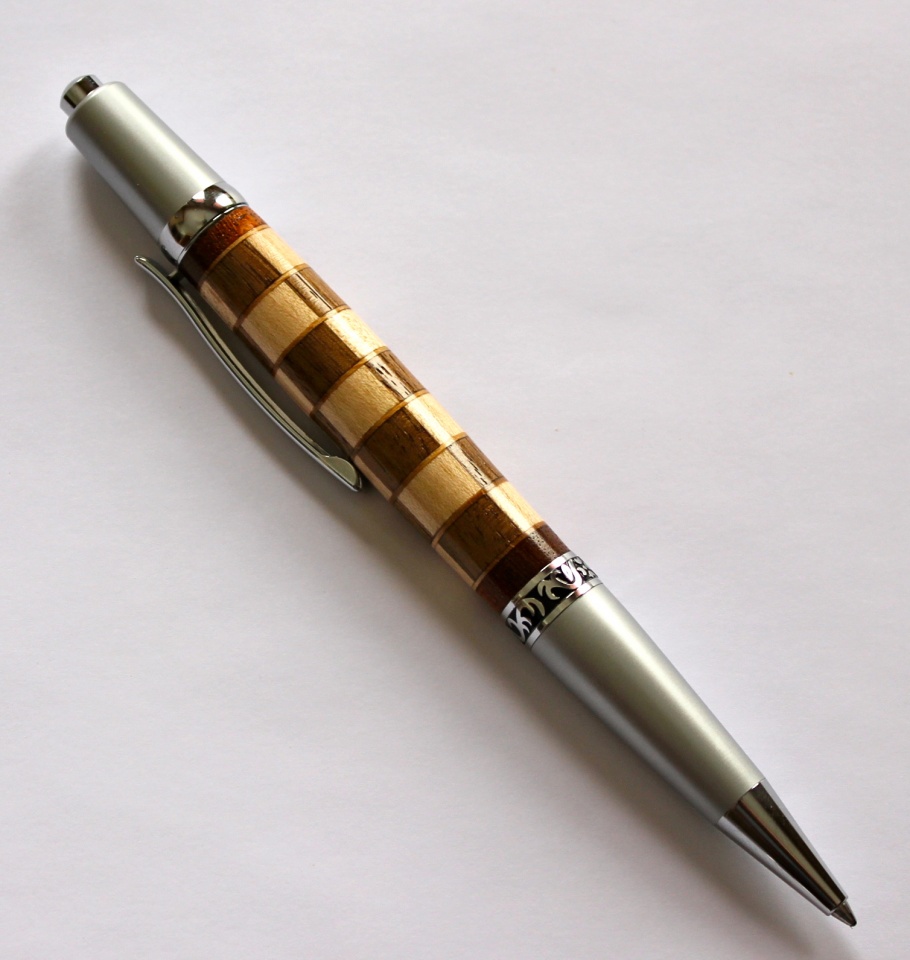

After have some problems with Pens Plus, last month I started to play with Wipe on Polyurethane. I have used it for my last three pens and really like it. But... I did wait 2-3 hours between coats, finishing over 2 days.

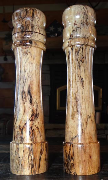

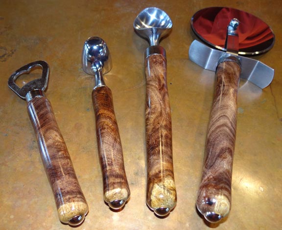

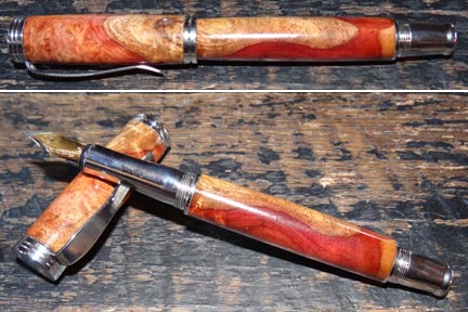

Here is another option for a finish and one that is my goto finish now. As a disclaimer, I am not a fan of the thick buildup, glass/plastic look of a full blown CA finish but instead like a gloss finish that lets the wood still feel and look like wood.
So here is what I do... after sanding with 400 grit sandpaper, at 500 rpm I do a soaking coat of thin CA (as in delay the accelerator to let the wood soak in all the CA it wants). After that I hit it with accelerator and sand down with a 500 grit Abralon pad to ensure that everything is nice and smooth and flat. Now, still at 500 rpm, I apply 5 to 6 coats of gloss Craft Coat (available at Exotic Blanks) using the same saturated portion of a blue shop paper towel waiting 1 minute between coats. After the last coat, I let it sit for 5 minutes to more completely cure before I remove it from the lathe. I usually let it continue to cure for about an hour before I handle it enough to do the hardware assembly.
From the manufacturer, "Craft Coat is a waterborne linseed oil modified wood finish that self-crosslinks when exposed to oxygen to develop an extremely durable film that exhibits outstanding scratch, mar, water, and chemical resistance." The rest of their description says that it is a modified polyurethane based finish.
The CA gives a nice hard base as well as really making the grain and color "pop." The Craft Coat then gives a very durable, hard, water resistant high gloss finish without the "plastic" look of CA.
Here are some recent utensils, mills and a Desire fountain pen using this method.
Mike
