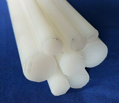

i just e bayed for HDPE rod , here's the uk answer
thats for 16 mm diameter by 150mm long should be enough. Whilst you're at it make a tapered tube insertion tool for good measure!
