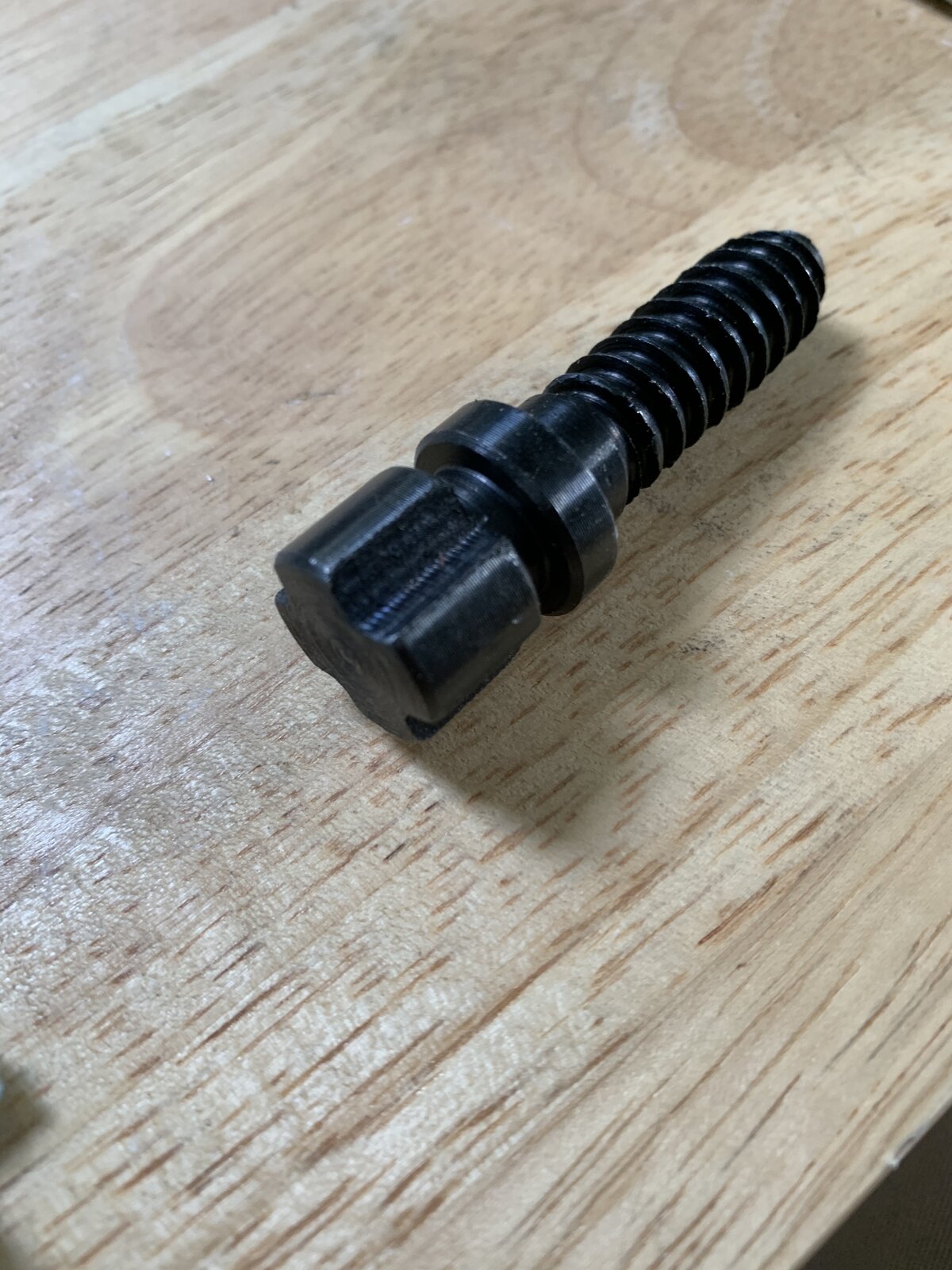

I found this in some of my older turning box and can't remember what it is. could have been put there by mistake. Anyone know what it is?

Parallel threaded screw chuck fitting. For use with 4 jaw scrolling chuck . Drill a hole in a bowl blank cross grain ( NOT end grain ) . Put this i. the chuck jaws and secure by closing jaws then thread the blank onto the screw. Always a good idea to put a cork washer between blank and chuck so if it starts to loosen at any point you remove the washer and turn the blank a bit more onto the screw.

Thanks for the helpful information.
