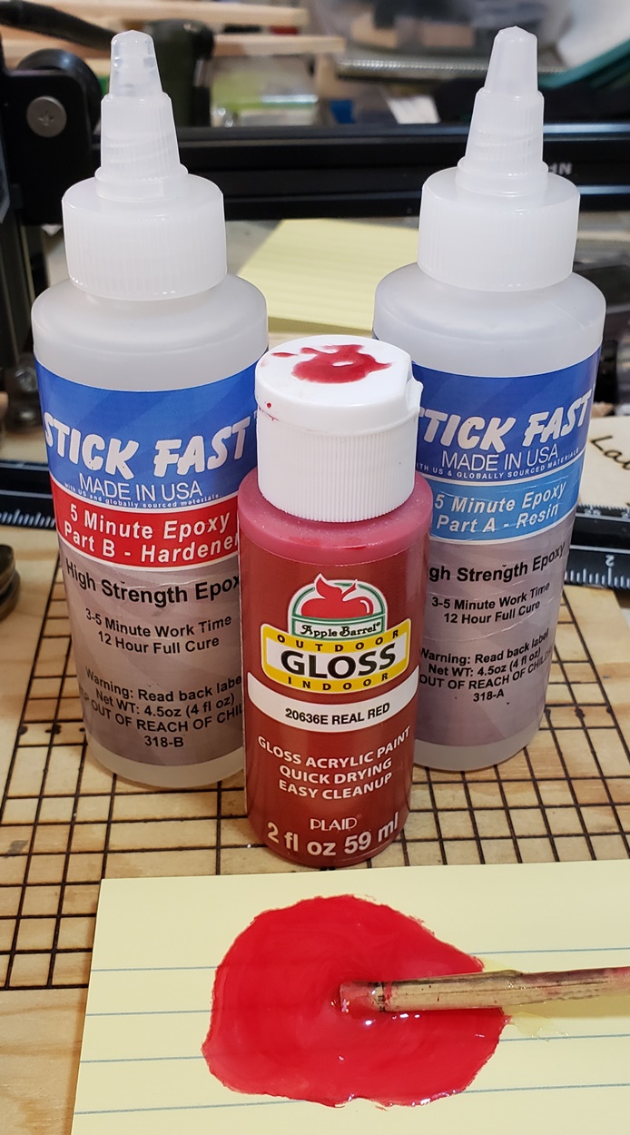

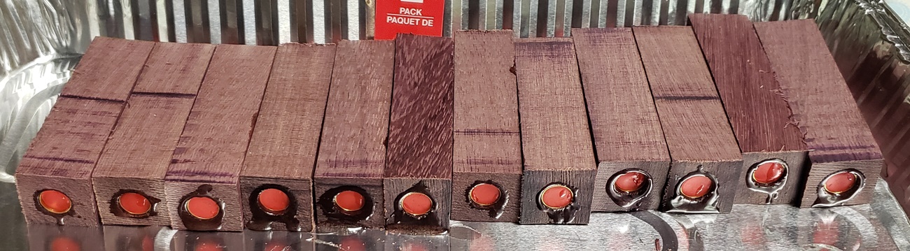

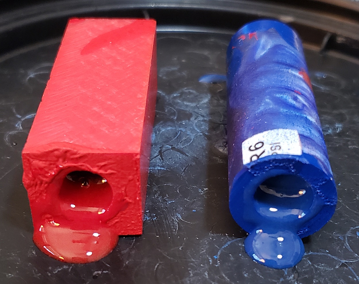

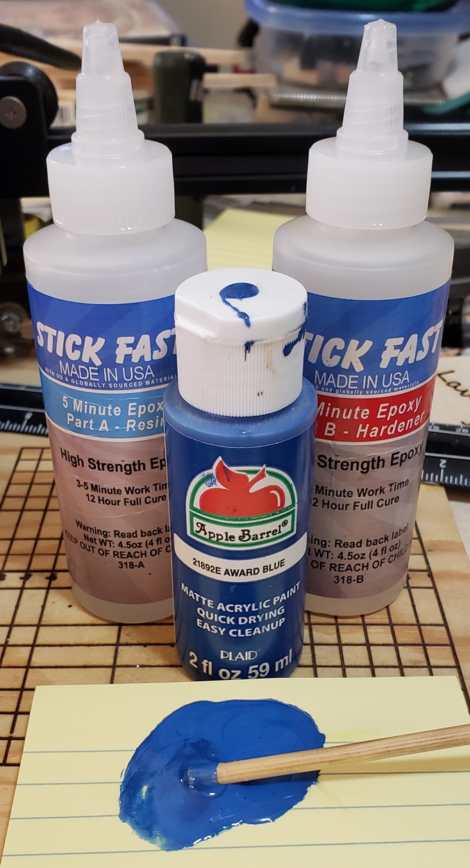

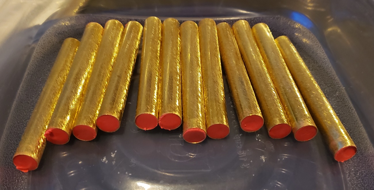

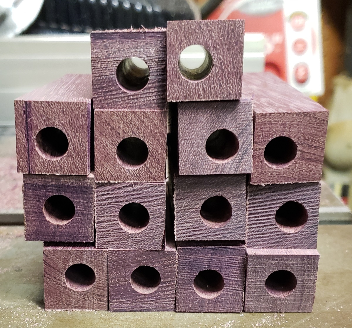

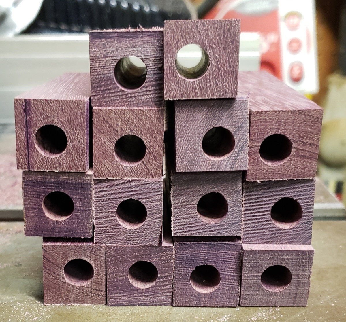

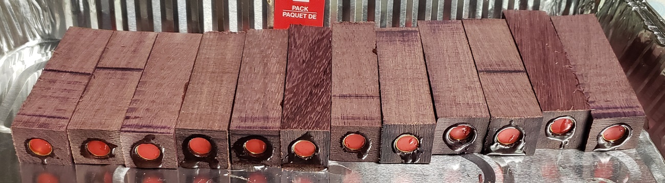

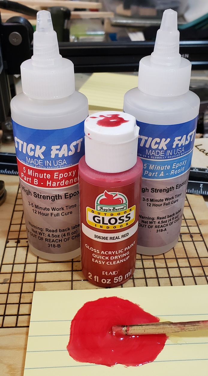

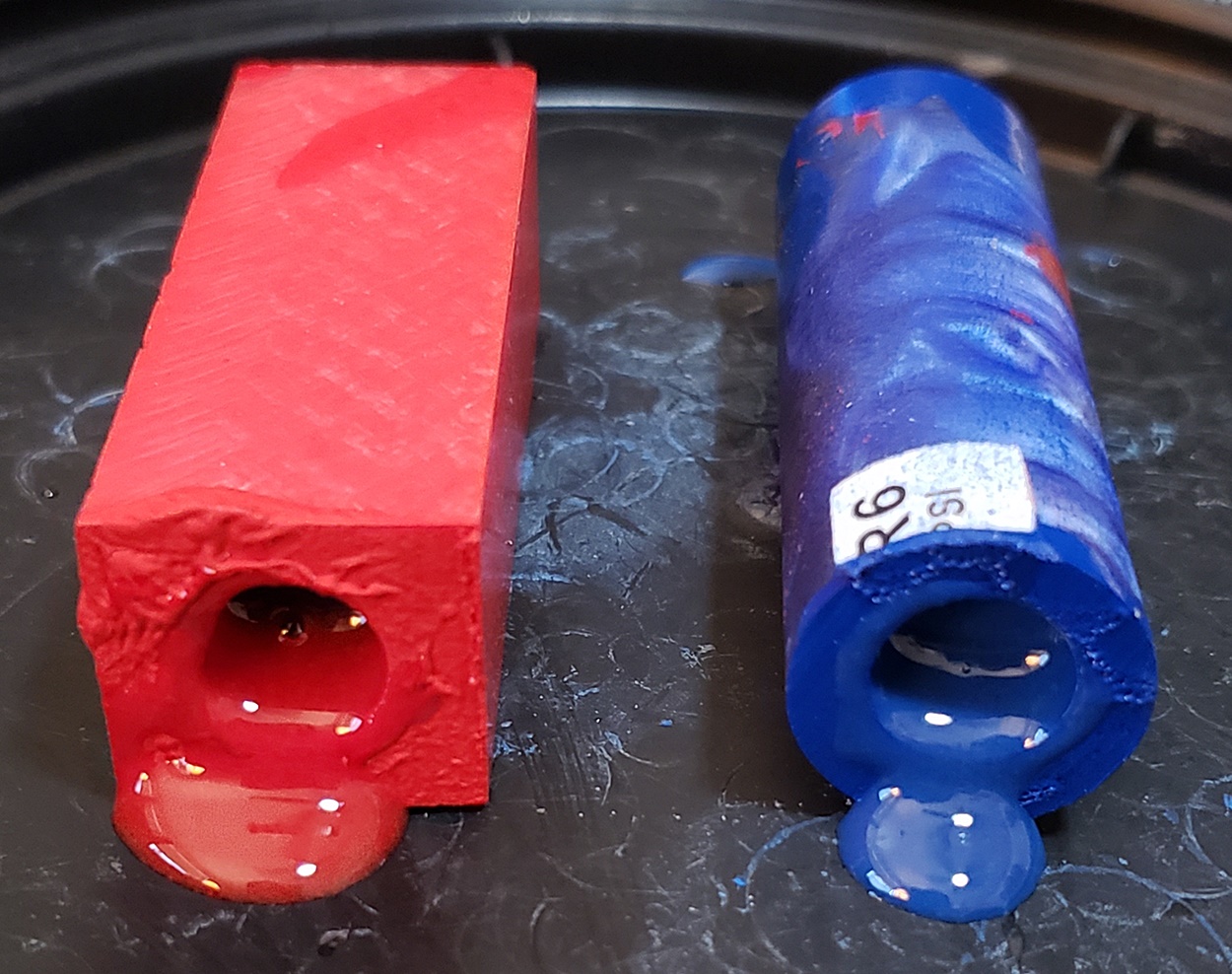

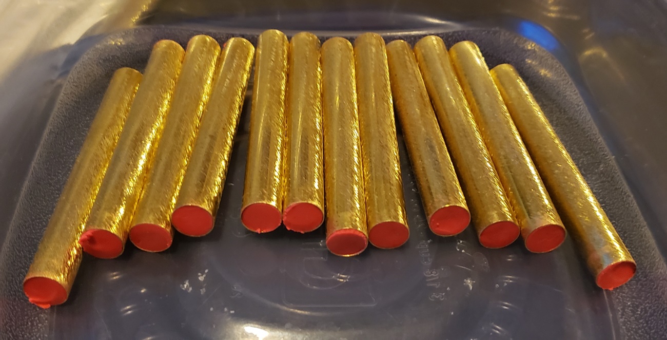

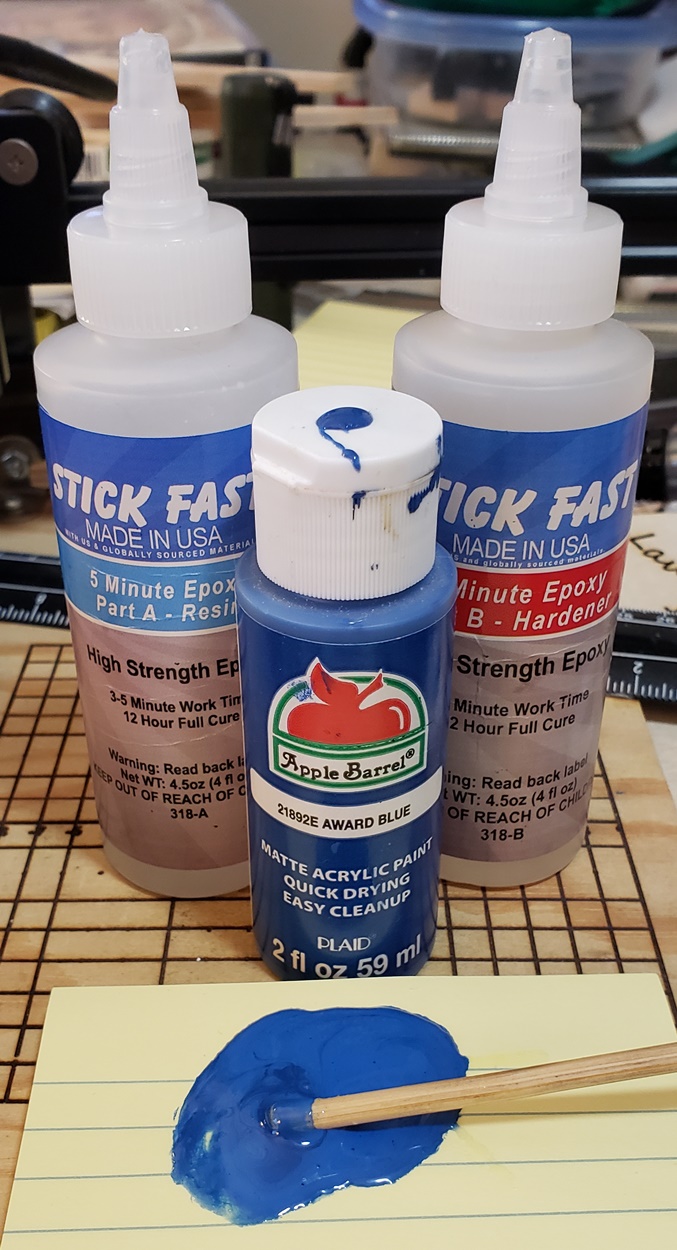

In my opinion, two-part epoxy is a much better and forgiving alternative to CA. Back in 1999, when I first started turning pens, I used CA. But after a couple of tubes got the dreaded "grab", I switched to epoxy and that's all I've used since. It has an odor, that may be unpleasant to some (my son hates the smell of epoxy), but no toxic fumes. I normally use 5 minute epoxy for one or two pens, but for the odd times I need to glue up more, I'll switch to 15 or 30 minute. Plus you can color epoxy if needed for acrylic blanks with artist paint (50 cents a bottle at Walmart). Can't color CA that I know of. If you're in a hurry, I've started turning a pen in 10 minutes before with no failures, but I recommend waiting at least a half hour. Epoxy is more forgiving, no fumes, and gives you all the working time you need. Oh, and it won't glue your fingers to your face. I see no reason to use CA for gluing tubes.

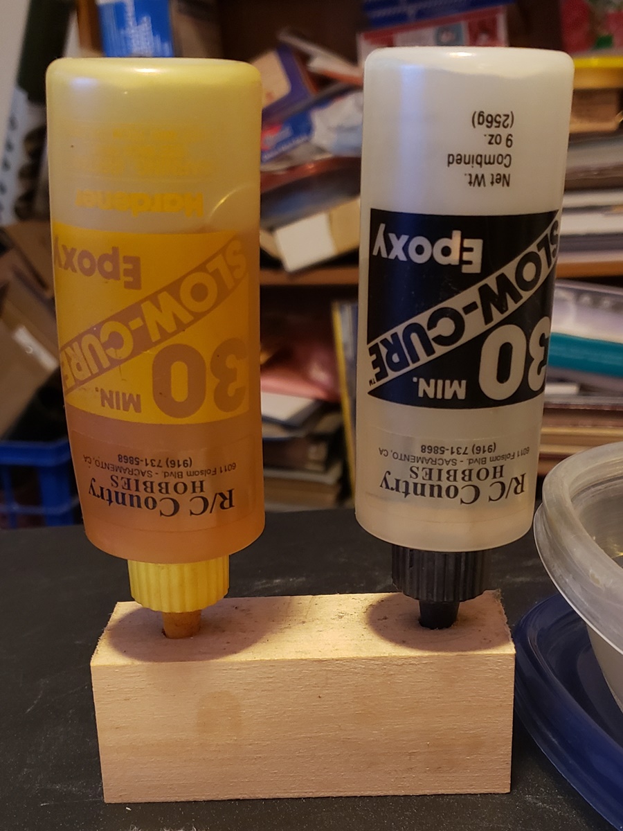

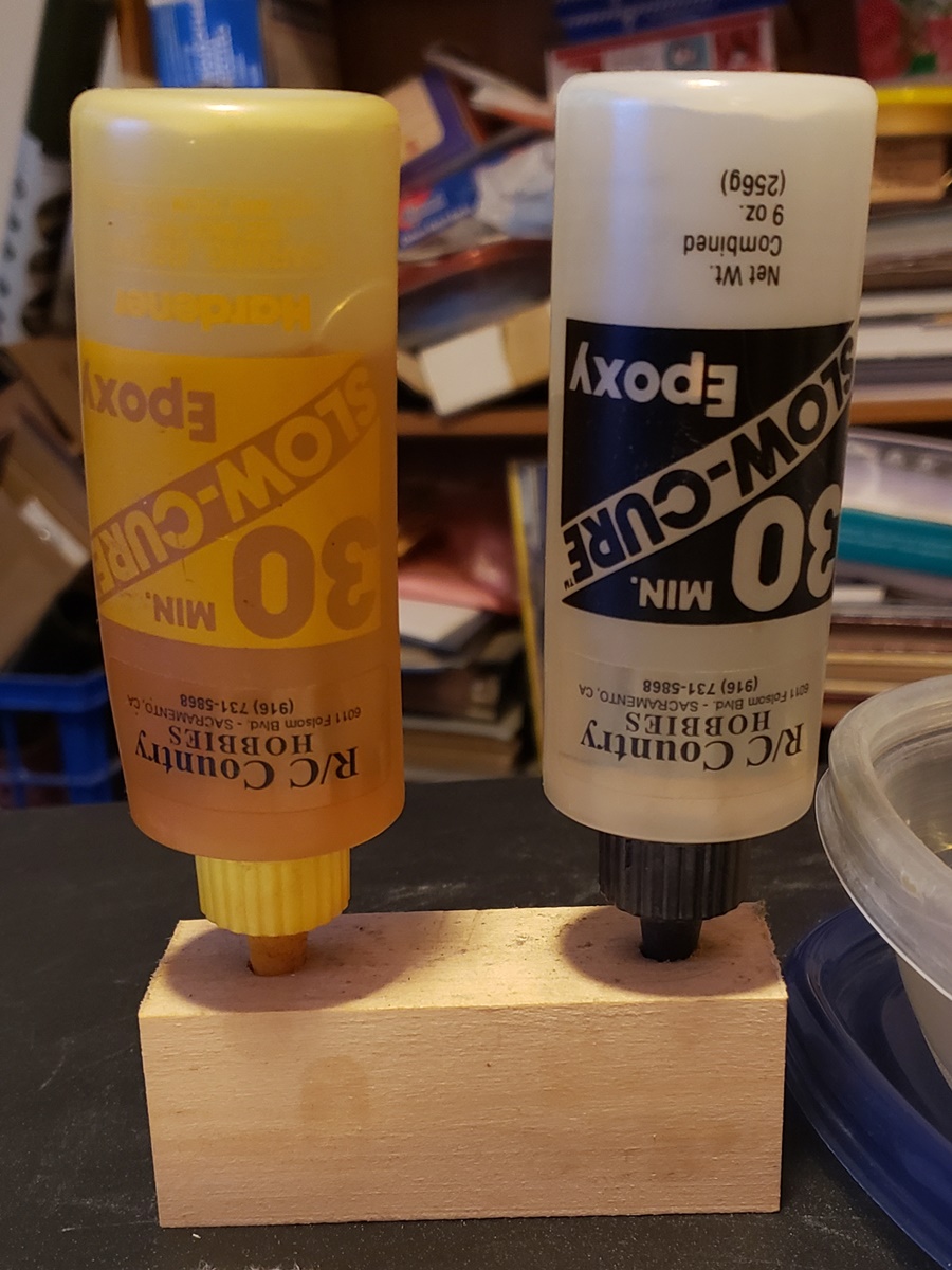

Also, I have used many different brands of epoxy over the years, for both pen turning and rocket building. The only one I've ever had a problem with was Great Planes brand. Twice I've had entire bottles turn hard, before being mixed. I've got some Bob Smith (BSI) 15 minute epoxy that is at least 10 years old. No problems with it. My current favorite, though, is Stick Fast. I like the tips.
