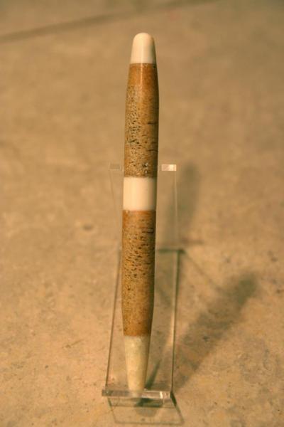

A very interesting thread. Speaking as a beginner in the world of pen turning, and currently gearing up to hopefully produce many more, I think the idea of an IAP 'starter kit' is a great one.
I've only made 12 pens so far (picture below), and they're all the dreaded slimline ones. Why did I choose these as my first outing in pen turning?... Simple answer, price and availability. My logic was if I messed up it would not cost too much, and they were easy to buy via the eBay/Paypal route. I've since bought a couple of Sierra, Jr Chairman and American kits, but as my last lathe is consigned to the bin and I'm waiting for a new one to arrive I'm waiting to get started again. I'm very interested in using and casting resin for my pens and have recently bought a pressure pot to help with this as I see it as a major activity in my future and I'm very enthusiastic. I want to create unique and very desirable pens.
Here's most of the pens I've made so far... left to right, purple heart, chocobolo, elm, elm, zebrano, elm, mahogany, laburnum, elm and resin.
Appreciate any comments... :rolleyes:
