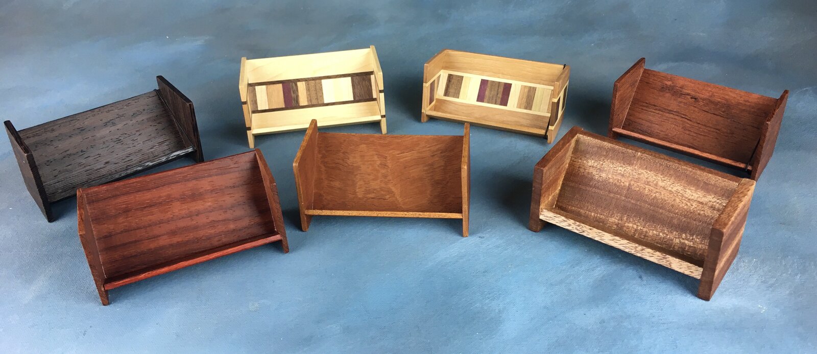

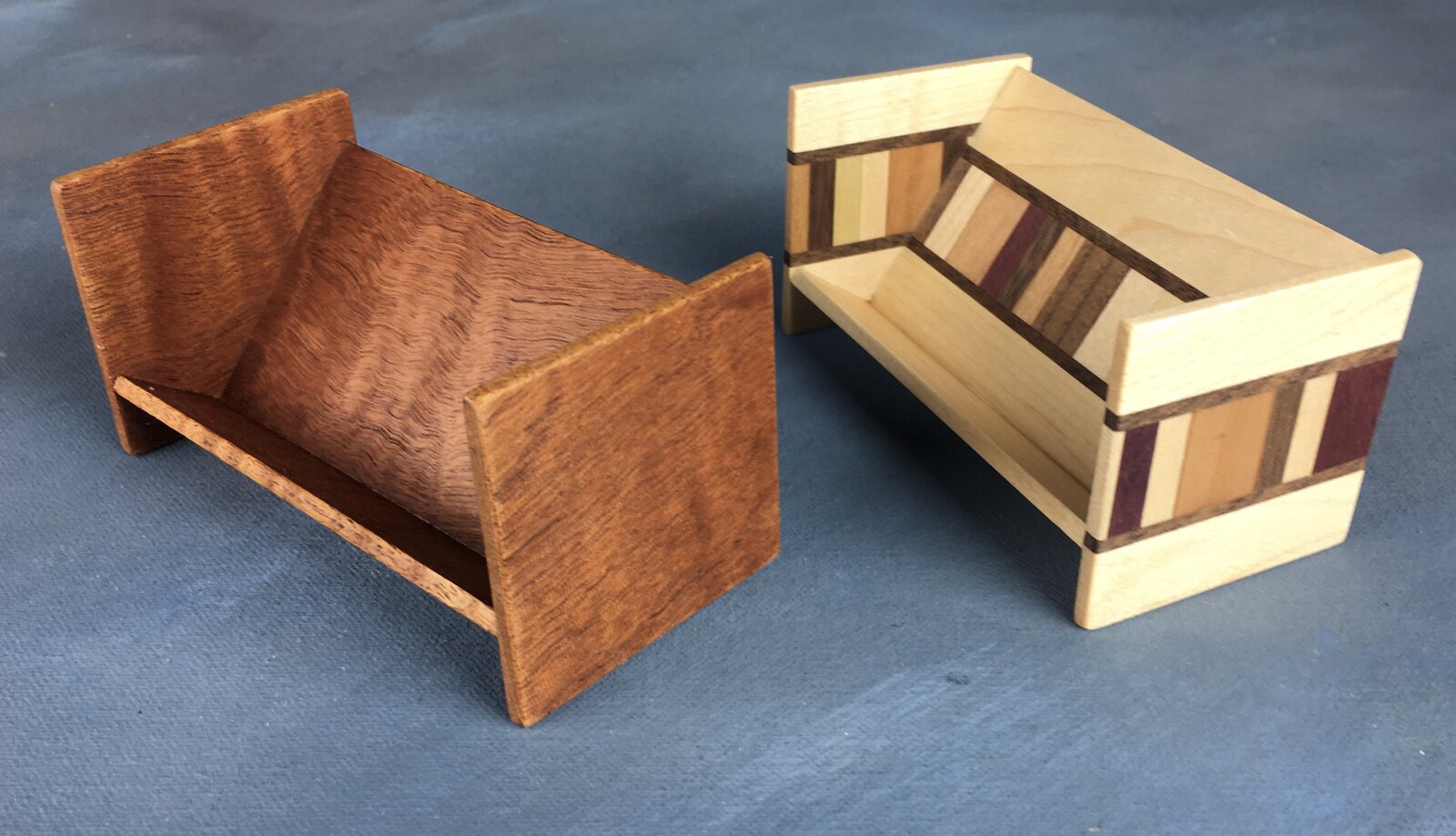

I saw someone at IAP who made a business card holder so I decided to design one. I needed something that did not take up a lot of real estate. Here is my creation.
Thin wood is best like 1/8". Even with the thin wood they are tough and very light.

Even though it may seem insufficient, butt joints were more than strong enough to hold cards. When glued up with sufficient curing time, I sanded then flush in case of slight out of square. They are tough, more than tough enough to hold 50 cards safely.

My pieces came from my cutoffs from other projects so all were not exactly the same dimensions, but close. I hated seeing wasted cool wood. I also hated my clear plastic card holders, so not wood.
Center section 3-3/4" x 2" and 3-3/4" x 3/4" joined to make a 90 degree angle. The two ends are 2" x 2". Join the center pair of pieces and clamp well. I like Titebond Three glue. Sand the ends flush in case you didn't get them glued perfectly. They should be rock solidly in one piece. Apply glue to the ends and angle the center piece to match the ends. Clamp firmly. Of course remove all glue you see. It sounds harder than it will be. Dry fit it and you will see.
