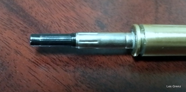

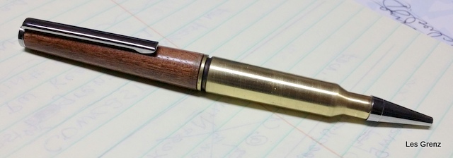

Yesterday a friend of mine gave me a couple of Mauser empty cartridges. I just wanted to experiment to see how a slimline kit would work with it. Unfortunately I do not have access to bullets so I just used what I had, a slimline nib. The experiment was not quite successful as the cartridge is too short. I was only able to press the tranny in a very short way and the refill does not back up into the slot properly. I thought of stretching the neck to fit the nib but was afraid I might split the neck. I think I will be able to use a 30-06 if I can find a re-loader. I would also like to use a copper clad hollow point if I can find one. i can go a re-loading shop and purchase them but will probably have to buy a bunch. I don't know if they are sold by the 25's, 50's or 100's. I just want to try it. I'll inquire t a gun shop not far from me. Anyway this is my little experiment for today. It is 11 PM. Good Night.
Nicely done. :)

Many thanks for the replies and suggestions. A kind turner on this site has offered to send me several 30-06 cartridges for further experimentation. as you can see from the attached photo the first experiment failed because I should have extended the brass tube in the cartridge further to allow for the transmission and reduced the length of the brass tube in the wood blank. Live and learn.I have a small machine shop and can turn a bullet shaped nib from aluminum or stainless. I see bullet pens on ebay supposedly made in the USA selling for under 20 dollars. If it is true someone is not even covering their costs considering equipment and supplies. Pens are just entertainment for me.

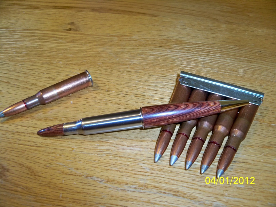

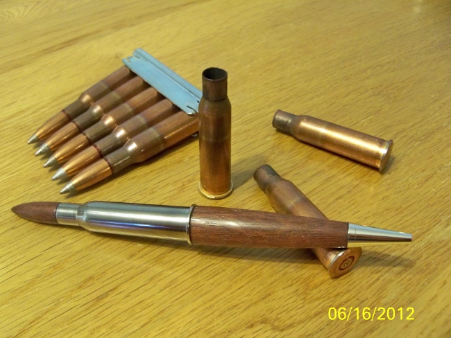

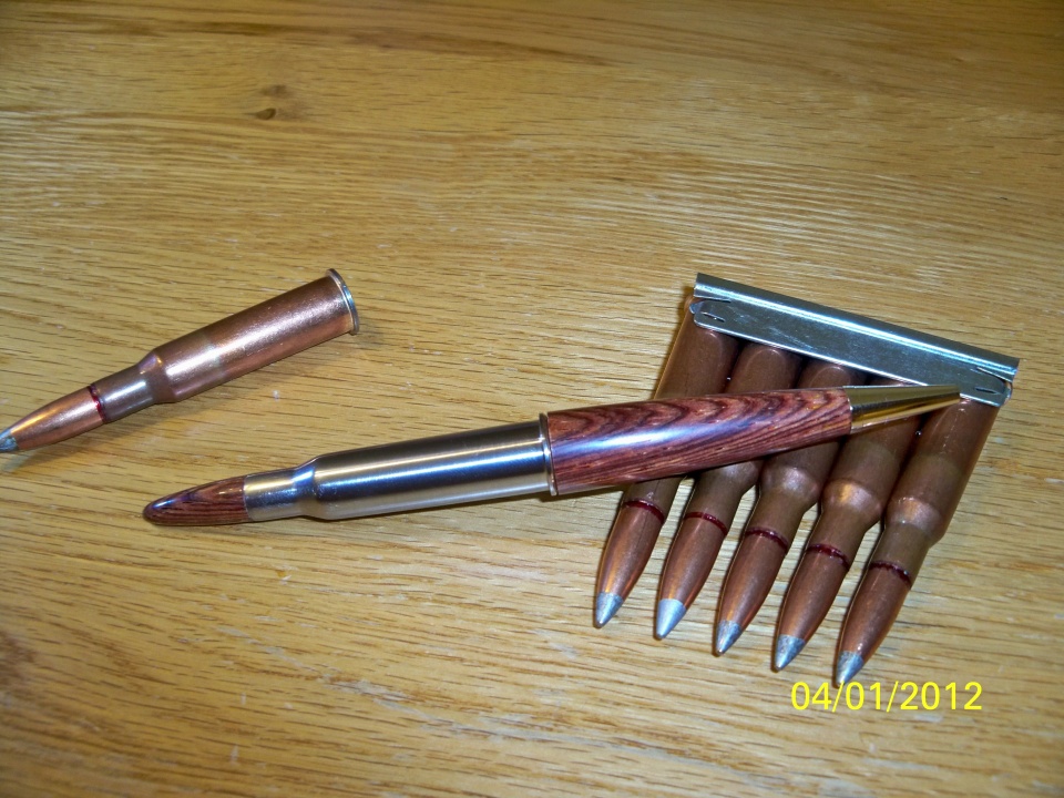

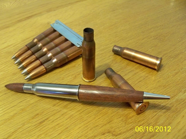

I make bullet pens, and I usually sell them for $15. Though, there's a few reasons why I can charge that low of a price. Some of the ammo I shoot is steel cased. It's cheap, but not really reloadable so it's basically trash after being fired. I don't have the tools I need to accurately bore out a bullet, so I make my own which is cheaper than buying the real things. Mine don't have a clip, but that doesn't seem to bother most.
Here's a few of mine made from 7.62x54mmR

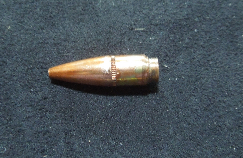

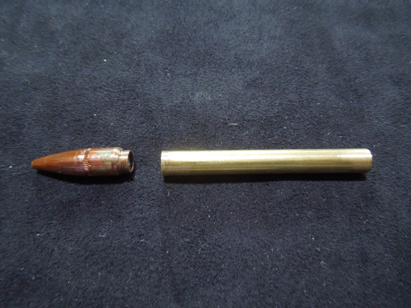

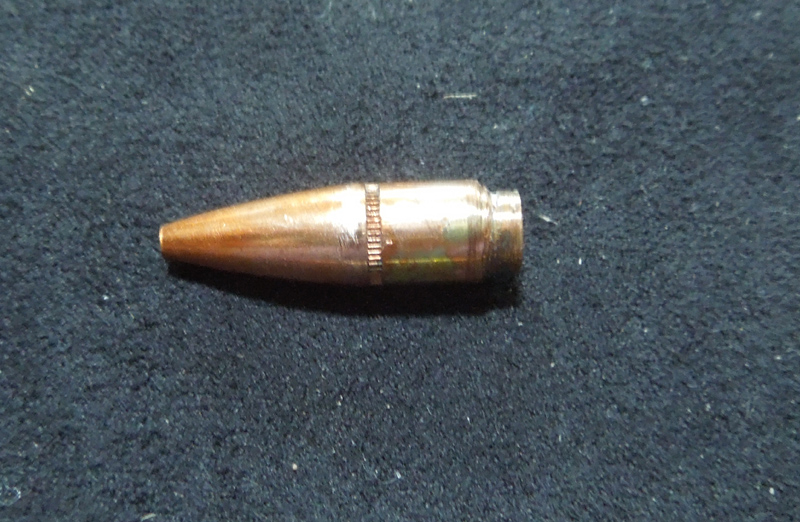

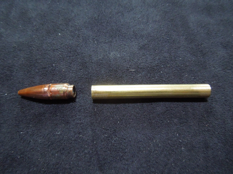

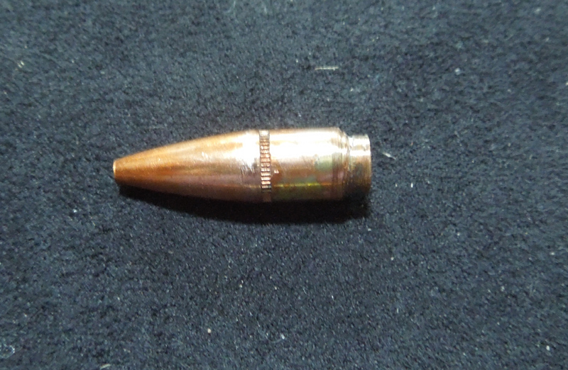

I can make slimline style bullet pens pretty cheaply (not including labor).
Here's what I found works good for me.
I buy 150 grain FMJ 308 dia. bullets from Midway USA. Box of 100 for
$ 22.99. Once-fired brass from Ken's Brass. 21 pieces for $ 8.88. I can put a nice rifle or deer clip on it, and still have only $ 5- $ 6 into it. Most of the ones I make are of deer antler.
I turn a tenon on the end of the bullet first. Then melt out most of the lead with a mini-butane torch. Then drill out the tip.
The brass I go in down the next with a bit through the flash hole, knocks out most of the primer. Then size the primer end to fit the transmission.
Solder the bullet to the tube, then glue or solder the bullet/tube into the brass. Might have to round the neck of the brass a bit on some, but it's pretty simple.
-gary

Whoops, posted two of the same pics in my last post. 2nd pic was meant to be this one.

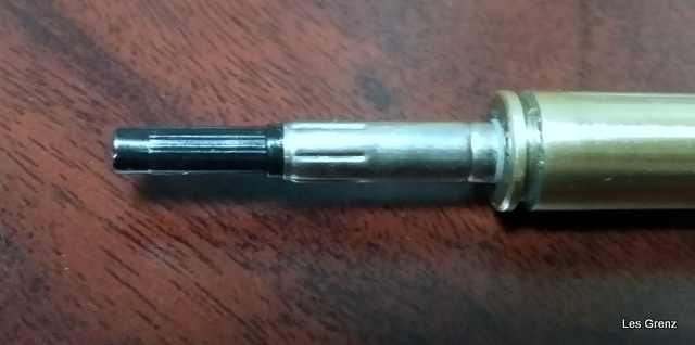

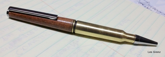

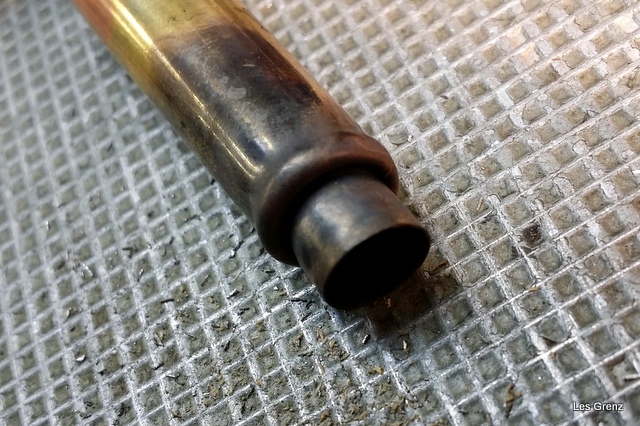

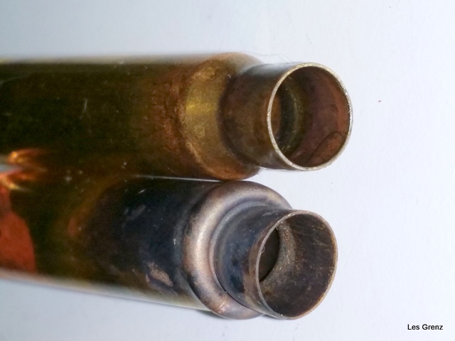

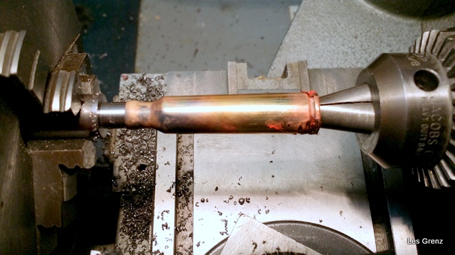

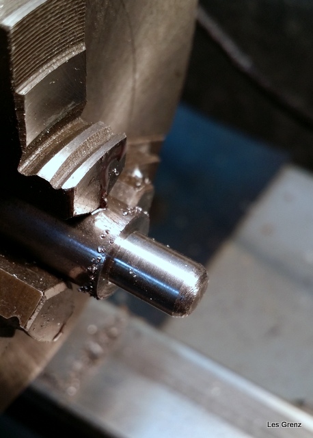

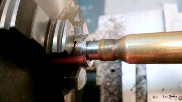

Thanks everyone for the many replies. It's a been a good education on rifle cartridges. I have attached a few photos of what I did today. I made a die of 12L14 and used the tailstock of my lathe for a ram. It works OK. I made a successful stretched neck but is it worth the work? I don't think so. But it is fun just to see what will work, and it did work. The photos are as follows:

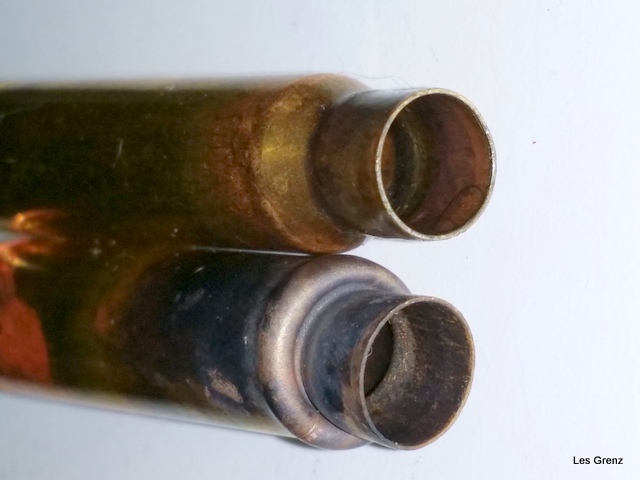

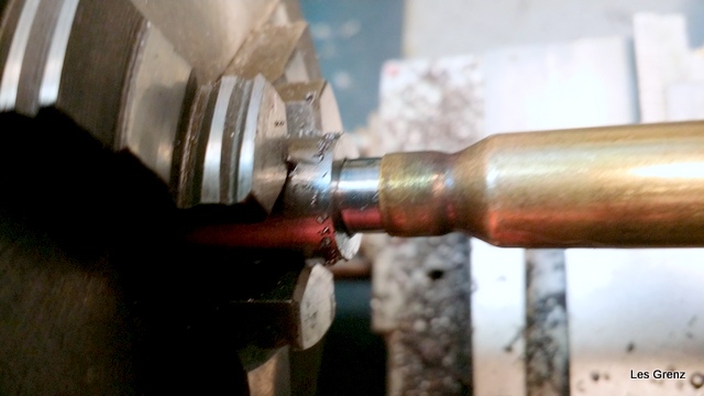

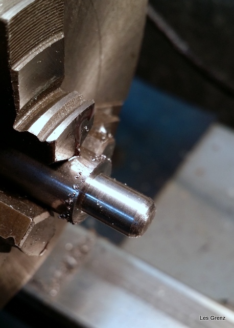

1. This is the die I made.
2. This is the first stretching I tried.

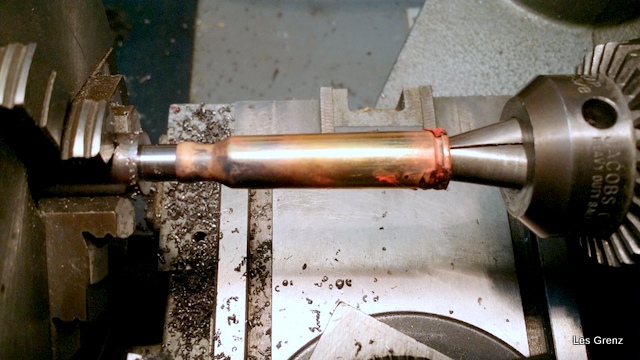

3. O CRAP! I annealed the neck as well as the shoulder of the cartridge. One lesson learned.

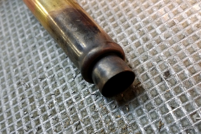

4. Having a bit more luck. I wrapped the cartridge in a wet shop cloth and re-annealed the neck. I did this several times because with each press of the neck onto the die the brass work hardens. But at last the neck went onto the die. I know nothing about bullets and reloading but I doubt anywone would stretch the neck .025" which I did.
5. Which die has the Toni. If you are under 50 you will probably not know what that means. Most of us older gentlemen (I use that loosely) know. The top worked out perfectly. The bottom?
Thanks again to everyone for some interesting reading of which I do a lot.
Kindest Regards. Les
