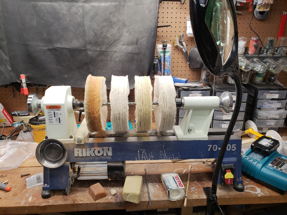

Nice. I just picked up 12 inches of half inch threaded rod. I’m hoping I can fit three wheels on there but might have to settle for two. Will post some picture when I get it set up.

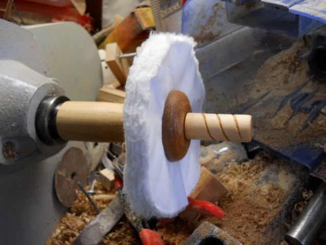

Your wheels will be rather close together and you will risk cross contamination from wheel to wheel. You are better off with a system pictured above by Dogcatcher. I have a similar setup using Beall wheels and compounds.
You will need a set of wheels for your sterling silver and another set of wheels for CA finish buffing. You also need a separate wheel for each compound.

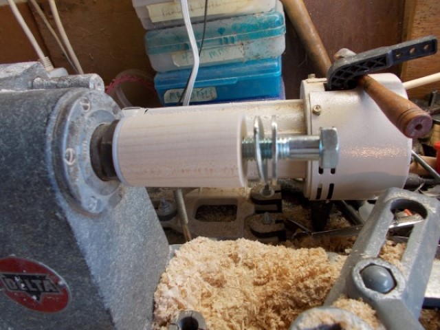

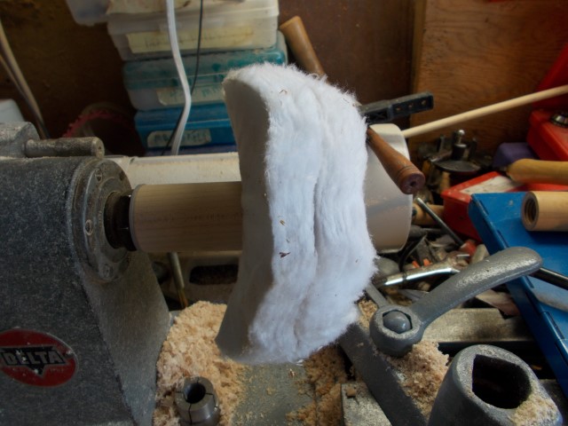

A 12 inch rod, 2 inches lost to the chuck/driver end and at least 1 more on the tailstock end. That leaves 9" to be divided by 3 wheels. With only 1/2" wide wheels, you are right on top of each other with a little more than 2" between them.
Get some 1.5 squares blanks about 3" long and drill and tap like in my pics. Use the rod in place of the bolts, or make some like this using the all thread rod.
This is also drilled and tapped, but the left side can be a piece of the all thread stuck into a chuck with a nut and washer, and the right the side the same, I do recommend a block of wood on the tailstock end to protect the point of your live center.
I have a BUNCH of them. My wife made jewelry, so I buffed it on the lathe with a few different wheels, 3 for the basics until Tex at Durango's article I linked to, that added more buffing wheels. I also made knives, that was more buffing wheels and compounds. Every wheel and compound had it's own zip type plastic bag.
