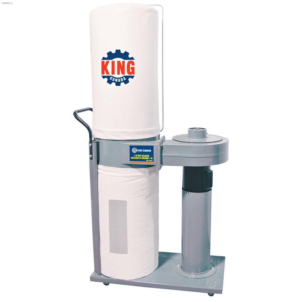

I need some feedback on what I consider to be excessive dust from buffing CA finishes. It resembles fine talcum powder that gets all over everything.
Now don't laugh, but my "shop" is in a pantry in our condominium apartment, 4 ft. x 7 ft. is stretching it - so all of you dear folks who are complaining you don't have enough space ..... well, DON'T!!!! ;)
I have this equipment for dust collection:
And I am using the Beall on-the-lathe buffing system. I am careful not to charge the wheels too much but still am getting a great deal of fine dust to the point where I thinking of selling it.
Any comments would be greatly appreciated.

I am not the expert on this by any means, but that looks like overkill for a 4x7 room. It sounds like you need an air filtration system or a finer filter bag for your DC.
That DC should suck in every particle of dust, but without the right bag - 1 micron bag, the extra fine particles will blow right back out.

Thank you for your suggestions - I do in fact have a 1 micron HEPA cartridge filter on my DC.
