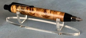

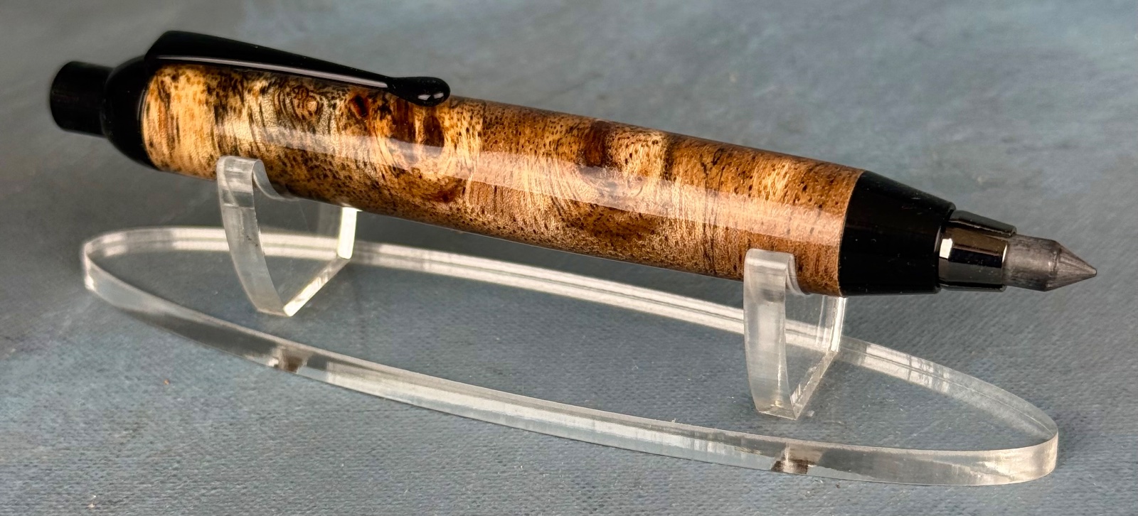

I make a lot of exotic wood pens, and they're all finished with CA Glue. After you sand, the pen blank it's important to buff it to a glossy finish.
If you use micromesh pads and water I hope you move up the the Beale buffing system. I've been in the micromesh camp, but will never return.
The finished pen is shown below.

I'm with you Mark - quit using the micromesh process a couple years ago!
I stopped using MicroMesh but have adapted to Zona and a multi-grit auto finishers abrasive paste then buff as my finish process. I only use a two wheel buff with blue compound. I do use GluBoost instead of CA also, but don't think the process is different.
I still use MicroMesh BUT only the MM sheets (cut down to about 2"x4"). I use them dry and they really produce a nice shine. I follow them up with Magic Juice from Michael Hardin and usually buff them out with my Beall system. Sparklies all around.

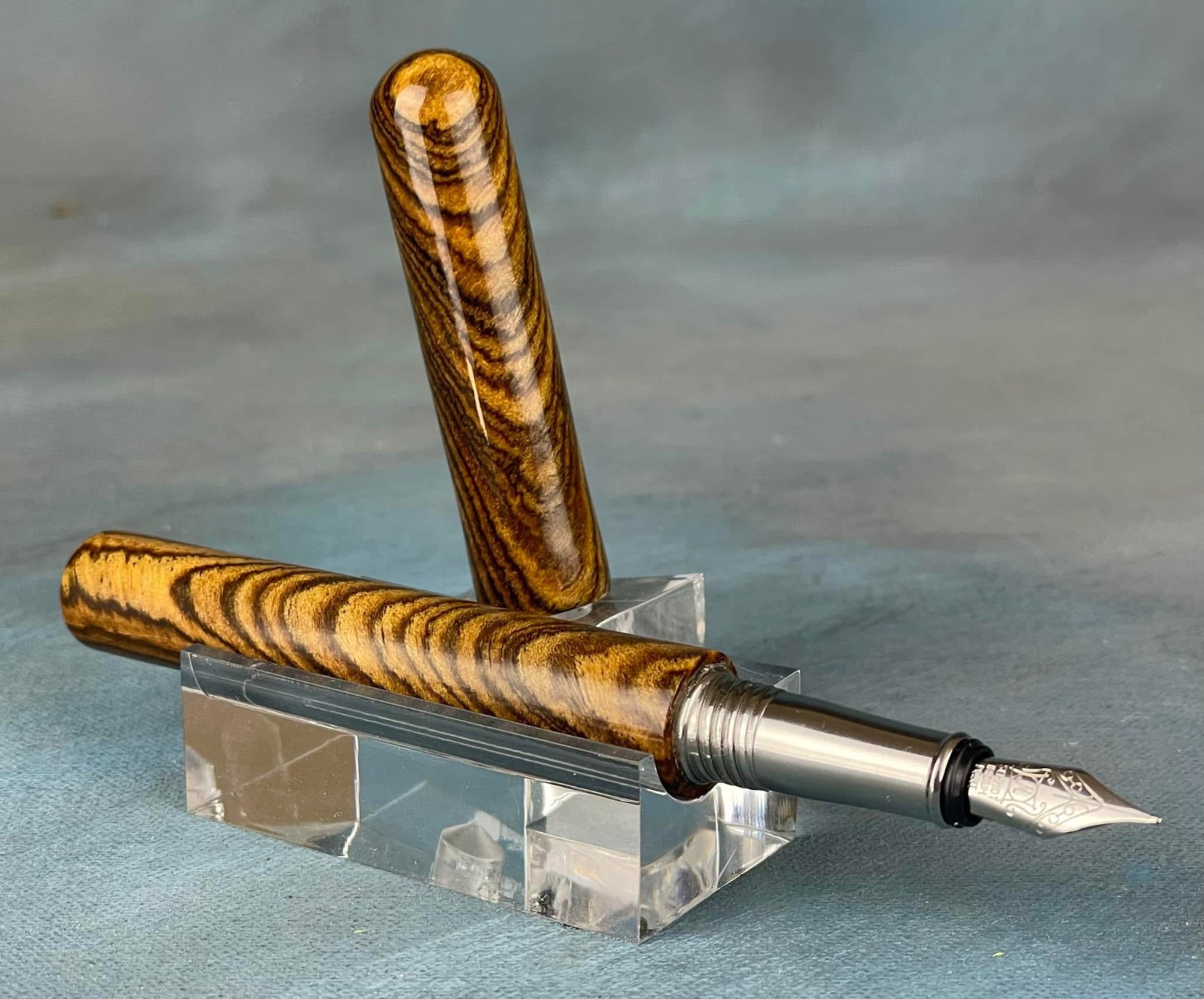

Thank you Mark. I dry sand to 1500 or 2000, then tripoli, white diamond, then 2 finer grits. I have 4 wheels on the same axle. Your finishes are o/s.
