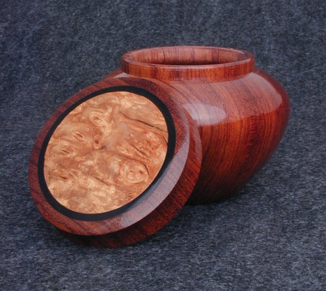

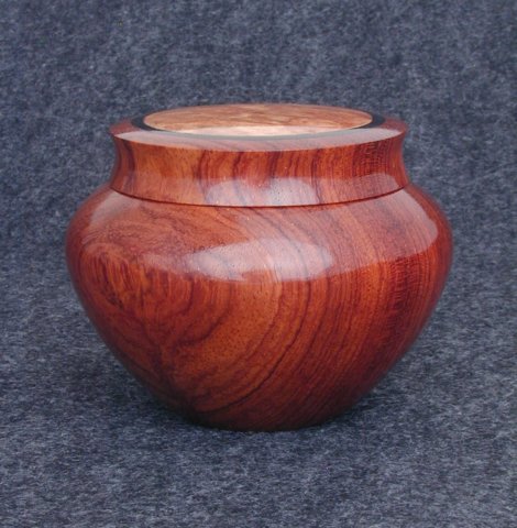

Bubinga Inlaid Box
See more from Ron in Drums PA
Jan 27, 2005
2,372
Drums, PA, USA.
Bubinga Box with Maple Burl and Ebony inlay. About 4" tall
Thanks for looking

Excellent work Ron. Awesome job all the way around. The inlay work turned out fantastic.
Thank you for sharing it with us.

Ron,
I fine example of your talent. That inlay work is amazing!
Is the Ebony a solid/single piece? If it is...I know you put a lot more work on this than others may appreciate.
Great job!
Yes, it is a solid piece of ebony. I have some ebony that measures 3"x3"x18" that I slice off a 1/8" piece like one would slice baloney. I do the same with the burl.
I mount these slices on a wooden face plate using double stick tape and use a parting tool to cut the ring. I just have to be careful of my dimensions, otherwise this is probably the easiest way of making the inlays.

It's incredible. I'm mesmerized by it's beauty. I'm having difficulty getting my head around how the cut was made separating the lid and base. Also, why is it called a "box"? I don't think of boxes as being round.
Jan 27, 2005
2,372
Drums, PA, USA.
Thanks Richard.
I've always wondered why it was called a box also, historically that's what they have been called. One time, 100 years ago, these forms where mostly made from boxwood. Maybe that has something to do with it. To me it looks like a jar.
I separate the lid using a very thin parting tool. Then I turn the tenon on the base. The trick is getting the grain to align, which is more luck than skill.
