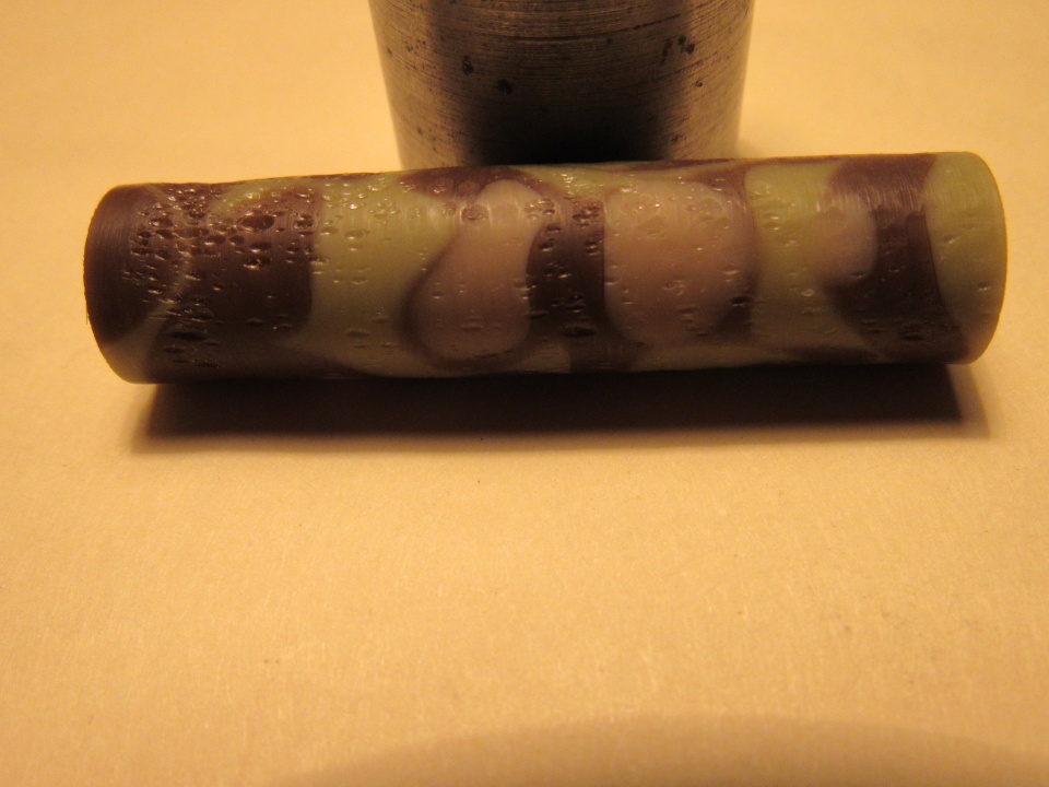

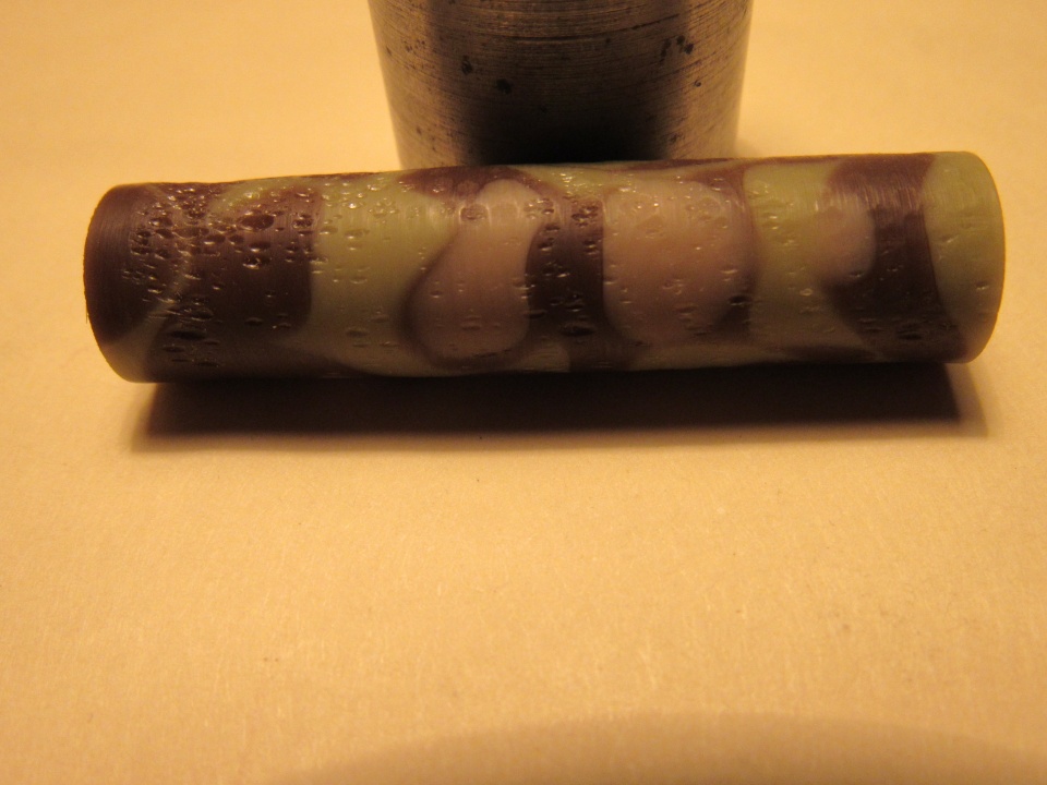

Is this what you see?

Yes but not as bad. I only had about three little divots. Maybe they are tear out but I didn't notice them until I started sanding so thought I had sanded through a bubble. I could have had tear out and just didn't notice until later in the process.

I found that I was moving the spindle gouge too fast across the blank. Made sure it was sharp and went much slower. End of problem. This was a two piece pen, second piece came out perfect.
