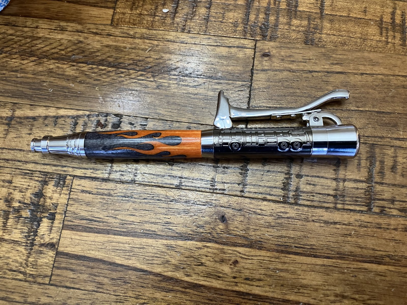

Has anyone else had a Berea Fireman lever click quit working? Had this one returned because the ink will not stay out, only slightly comes out but will not stay. When lifting the axe up there is no "click".
Emailed Berea and got a response that said no individual parts were available.
From what I can tell, there is no way to access the mechanism to attempt a repair. Any help or suggestions would be greatly appreciated.

Guess what arrived in the mail today. A new click top for the Fireman pen from Jim at Berea.
Here's a big THANKYOU to Jim.
