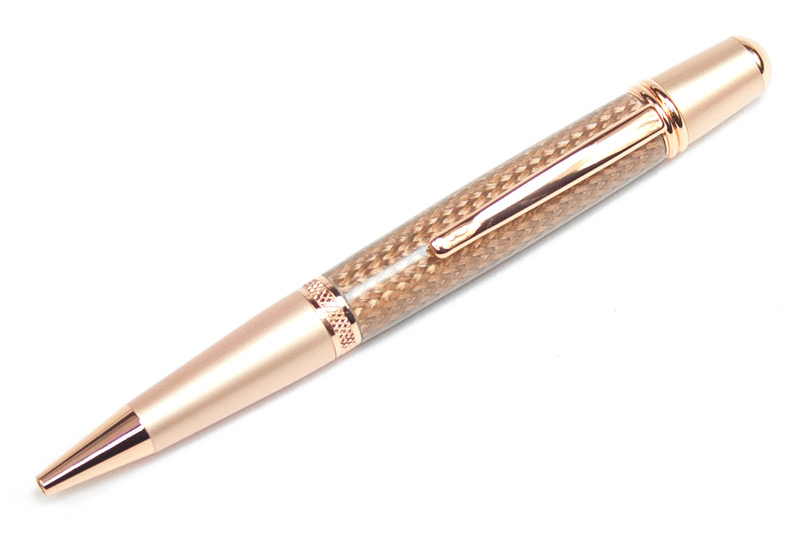

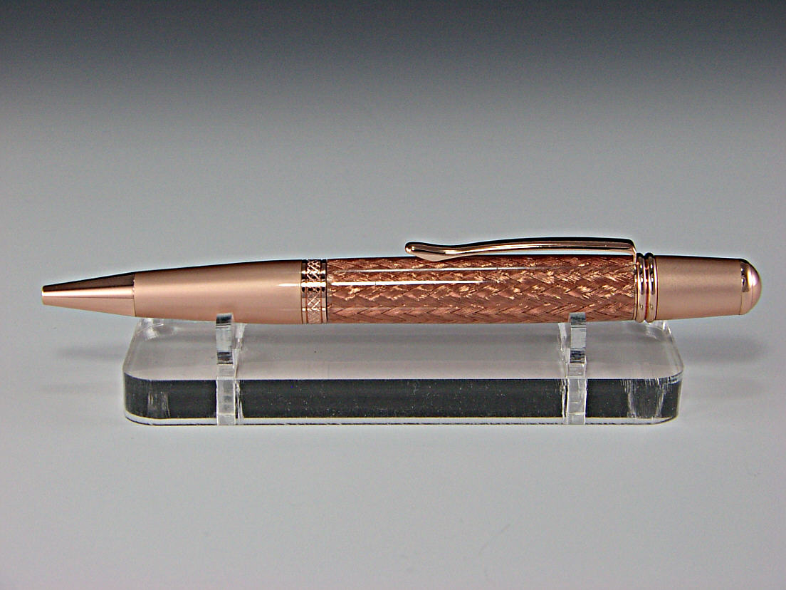

I know you prefer bright copper, but here is a Sierra, overall copper, which has a combination of satin copper and bright copper ...

The Gatsby tube is compatible with the Sierra. .
They both use 27/64" diam brass tubes.
The twist versions have tube lengths of 2.20" and the click versions have tube lengths of 2.42".
There are other variants of the Sierra, such as the Elegant Sierra and the Sierra Elegant Beauty, but with same tubes.

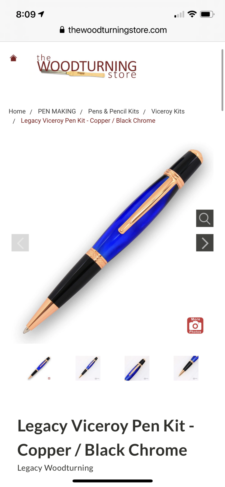

The Legacy Viceroy also uses the same tube.
