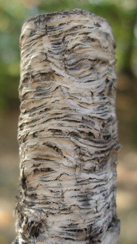

Hey toni do you think you could make a one inch round (no tube needed) poly clay thing that looks like this picture? It would need to be able to be glued onto wood and stand up to some turning to size and sanding and finishing with CA. The picture shows a cigar ash and it has some texture to it and is irregular in shape, I am just looking for something round that will look something like that once I turn, sand and finish.
I didn't know how to send you a picture in PM so I'm posting it here. You can PM me back with if you can, cost, etc.
I am looking for two to four pieces like this 4 to 6 inches in length.
you can email me at Toni@exclusivedesignz.com and figure out something hopefully:question:. Why dont you just turn the cigar ash?

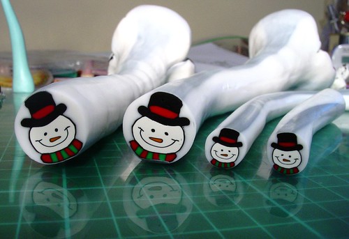

Just stumpled on this thread. I noticed it says to cut the canes thin. The canes come as round tubes,correct? Do you cut them length wise or slice them like lifesavers? I am trying to get a mental picture as to how they go on the tube.
If you look at the above picture with the snowman you are cutting them like you slice the pillsbury doh cookies, you know with the design all the way through. When you have them sliced you just pick it up and place it on the tube.
