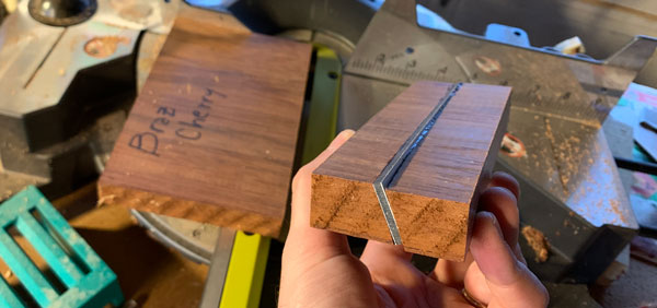

I'm playing with Aluminum Composite ACM material found at HomeDepot.
Happy to report it held to Brazillian Cherry just fine using CA glue. YMMV.
Thanks for looking
- Cullen

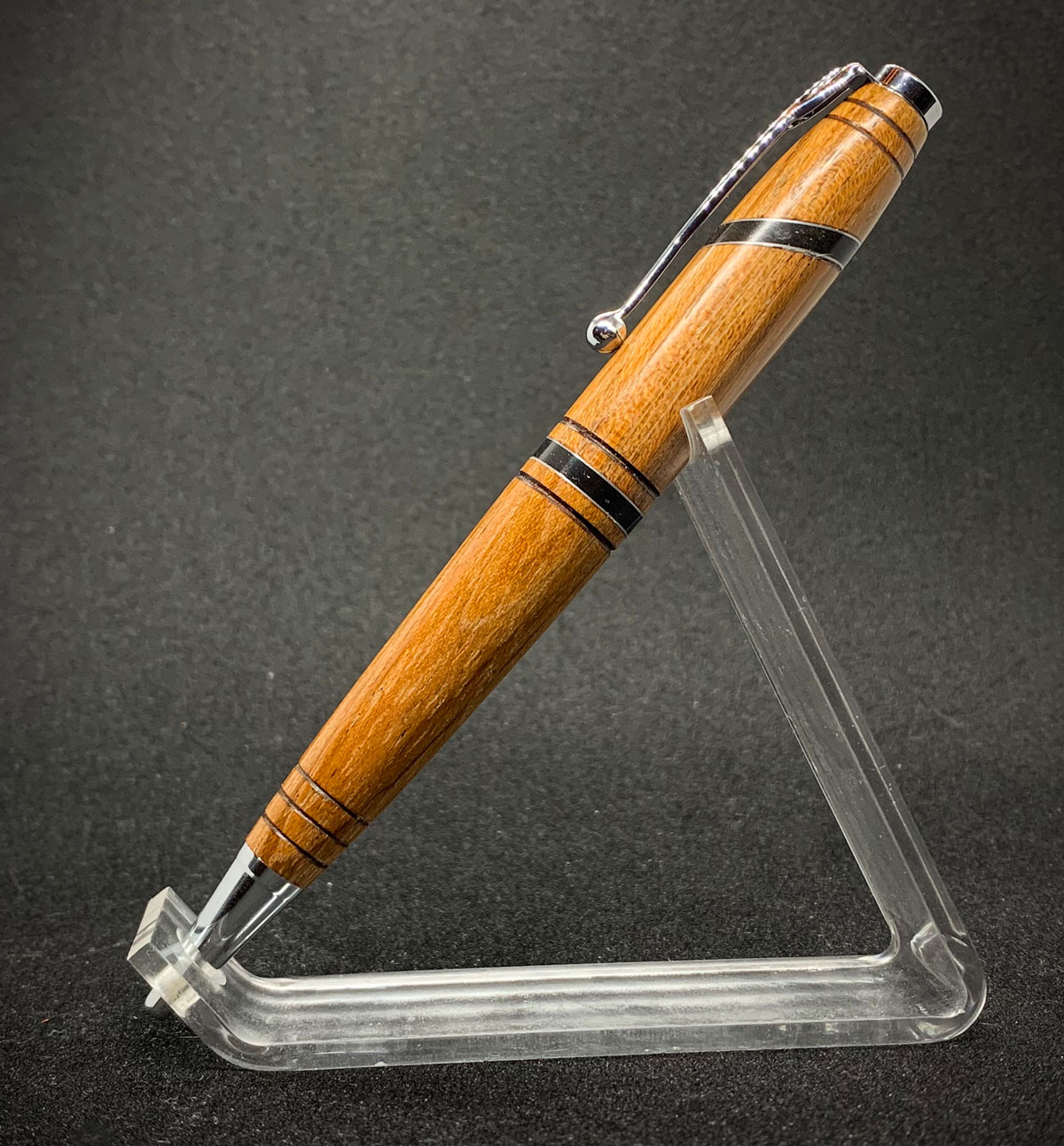

Pen details:
  • Brazillian Cherry with Aluminum Composite ACM segment and centerband
  • Slimline kit
  • Thickest width= ~0.5"
  • Wood burned rings using wire
  • I'm making a series of these as gifts and assembled multiple blanks at once.

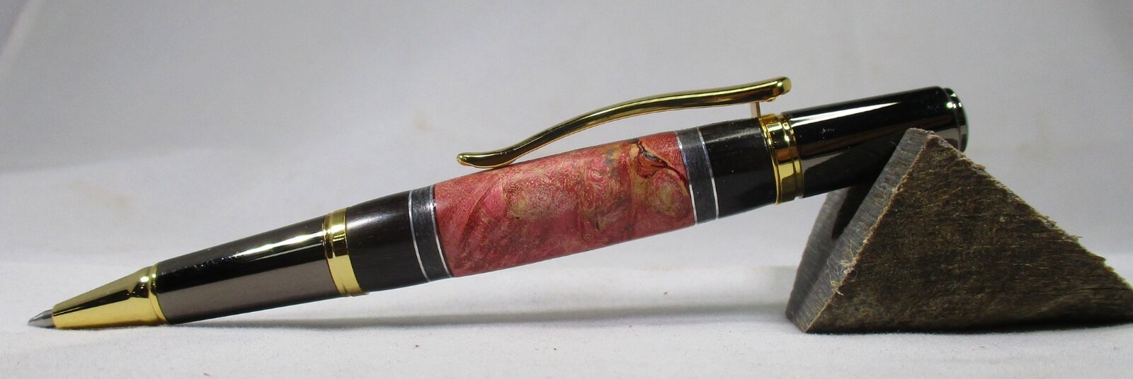

I don't know about cheating so much as it's a bit easier.
I have used it in the past and found that the material between the aluminium doesnt take a finish too well. I forget what finish I used, it was a couple of years ago, but whatever it was it had a reaction. It turned out ok.

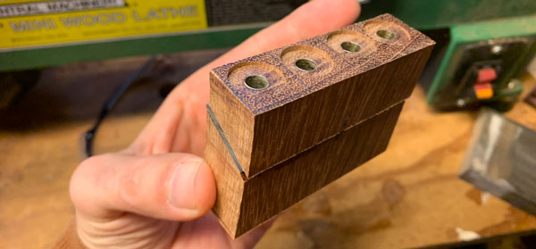

I think that the separation between top and bottom barrels is right at the very top of the central lamina . . . right ? ?
Mal- Right. Carving on the mandrel lets me play a little with how the center band gets incorporated into the overall look. This material is a little thin, so it's nice to be able to easily "beef" it up by making the upper and lower sections seem to be part of the centerband.
