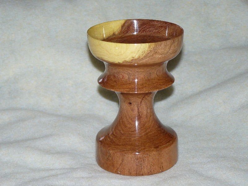

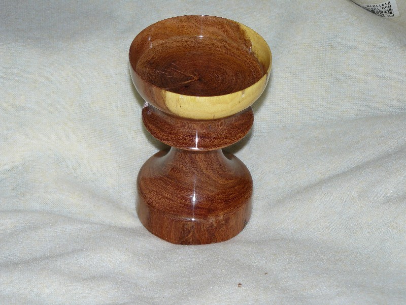

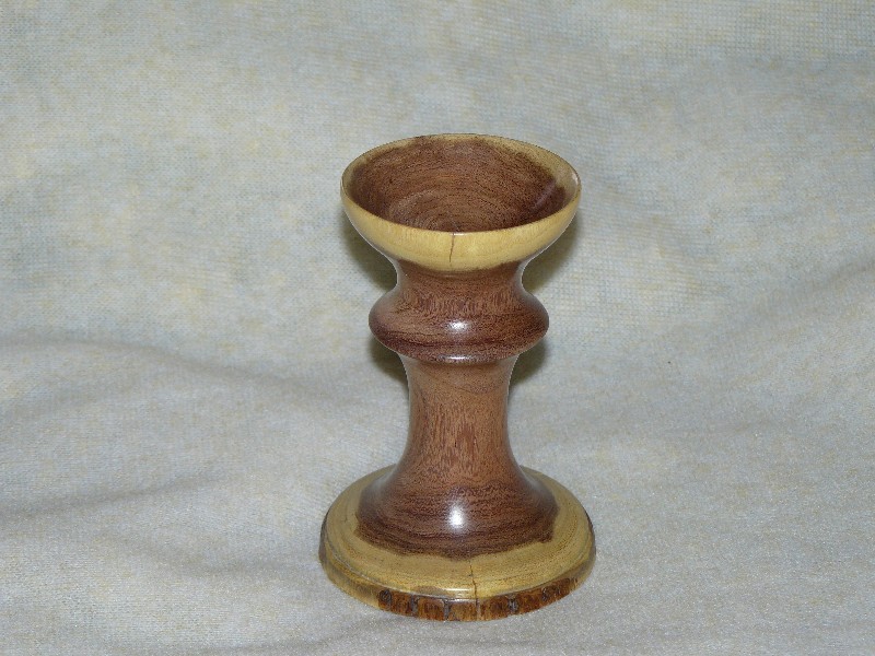

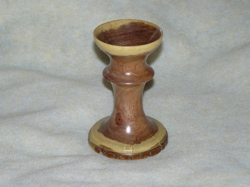

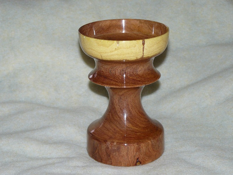

These are a couple of things I tried last couple of weekends after I got frustrated with the celtic knots I tried. They are made from some mesquite I cut from my property. Turned out not too bad. The short one is about 4-1/4" tall and 3" round. I like the look of the bark still on the base. Finished with Myland's sanding sealer and wax. MM'ed to 12000. The second is about 6" tall and 4" round. MM'ed to 12000 and CA'ed with 2 thin coats and 8 medium coats. I also like the yellow sap wood on both of them. All comments and critiques are very welcome. Thanks for taking a peek.

Dad, nice bowlish vase looking things:biggrin: I am impressed!!
Guys, you have to remember that he has been turning for less than six months, made some great pens and is already moving into bowlish vase looking things:biggrin:, so i am impressed! I have turned a few bowlish vase looking things but have yet to finish them. I need to get to work huh!! Dont think you are going to out do me dad!!:mad:
Again these look great and your skills seem to be improving quickly.

I forgot to add that the larger one took flight off the lathe when my gouge dug in on the bowl part. Pulled it loose from the screws so had to remount it and re-turn the whole thing as I couldn't get it centered exactly. Lost alot of the sapwood due to that.
