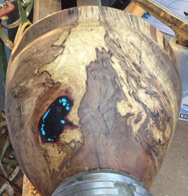

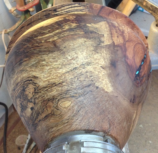

A few weeks ago I asked for some help when the tendon on a bowl I was working on broke. I received some fantastic ideas from some great turners. I decided to use the Cole jaws and a 2.5" forester bit to make a recess I could expand into. One suggestion was a donut chuck and I need to make one of those, anyway here is the large bowl still on the lathe. I put one coat of poly and waiting for it to cure and will finish. The black is espresso grounds and CA with some turquoise chips.
C & C welcome Thank you for looking

The correct term is tenon, like mortise and tenon. The tendon is a body part. Expanding into a mortise has it's own hazards. If you remove too much material on the outside diameter of the base, then that becomes weakened. So proceed with caution on a piece that has already broken once.
That's funny. I thought I wrote tenon so I don't know if I mis-typed or spell check did something. In any case, thanks for the correction. We don't need people turning off body parts!:biggrin:
This is very true. While I've had bowls break off at the tenon, I think I've had more problems with mortises. One little catch and the bowl comes off, mortise blowing apart, etc.
Another option for shallower bowls and dishes is a glue block. Easy to add and you'll lose much less material....
