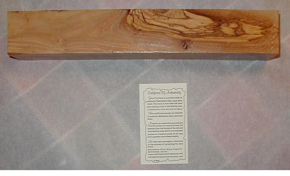

Finally reaching the end of the ornaments I have to make.
I do have one wood in particular that I would like to post about.
I have always been a great admirer of Bethlehem Olive Wood, and several months ago I ordered several 2"x2"x12" turning blocks from Diane at BOW (see the IAP homepage for link). If you haven't ordered from BOW, not only is the wood some of the most beautiful on the planet, but Diane and Ghasan are some of the friendliest and most caring people you will ever have the pleasure of ordering from.

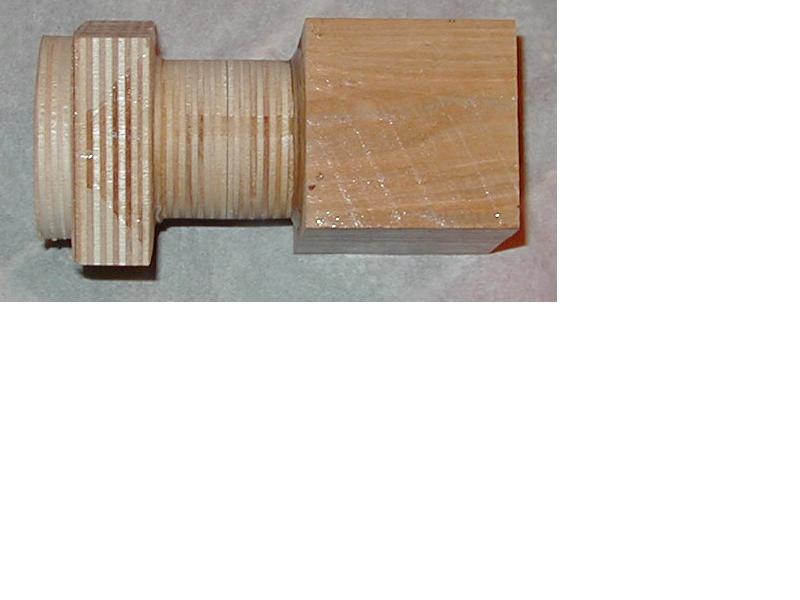

pic-1)Start with a nice BOW turning block.
pic-2)cut/glue a 2"x2"x2" block to a waste block

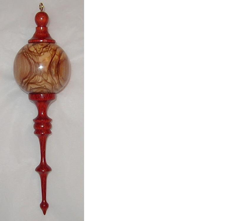

pic-3)and you have an ornament
The finial and icicle are made of bloodwood.
Sorry for the quality of the photo.

Super job John [:p] That is a great looking peice.

How thin do you hollow out the globe? I usually shoot for about 3/16", to give it a light feel.

Drew,
Thats the same dimensions I shoot for also. That size, from what I have seen between the turning and sanding, makes a pretty dry as well light globe.
The BOW was the hardest to hollow of all the ones I made. When hollowing I would normally just blow the sawdust out after a little hollowing, no problem. But the olivewood, being olivewood, was 'moist'. The wood seemed like it was dry, so I am presuming it was the natural oil in the wood that made it very hard to remove as I hollowed it. Also, since I have sometimes had olivewood dry/crack months later, I used stablized these with a CA finish.

Very nice John! Beautiful combo on the woods.
I too, found it difficult to price my ornaments. I am charging more for the birdhouses than the bulbs because the stock is a little harder to come by in the size I am making them. Your bulbs have a better finish than mine and are more ornate so I see no problem in the $50-$60 range for them.
