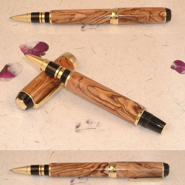

Here is a Havana rollerball pen I finished last night. Murphy was at my side the whole time! I got my new Berea mandrel running semi-true finally. I turned it down and found some serious cracking that I had to deal with. The CA finish gave me fits. My lamp/magnifying glass broke off when I adjusted it to get a better look at the finish. I put on a coat of TSW and buffed it. I took it off the mandrel, holding it in a paper towel to keep my fingers off it. The cap jumped out of the paper towel and rubbed itself all over the concrete floor ... twice. I didn't throw anything. Now, that's self-control! :) A little more cleaning and buffing, and everything worked out alright. Whew...

That's a gorgeous pen, Jim. I'd never have thought it was a "save"! BTW, Murphy's twin has been living at my place since Friday night. Unlike you, I have thrown a few things. If he doesn't leave soon I'm going to turn a bowl!

Jim, Great looking pen! I turned a Little Havana FP last week. Hope I can do justice to the next one like you did.
Randy aka peninghandrjg.
BTW Did you have any trouble drilling the monster holes?

Drilling the holes is no problem. I think the instructions say to use a 7/8" blank, but I make several a week lately with 3/4" blanks. I use Paul Huffman's drilling vice, so I am able to hit the middle of the blank pretty easily. I also refrain from drilling through the bottom of the blanks. I stop just shy of penetrating the blank, then cut the ends off on the tablesaw. This technique prevents a lot of blowouts on the drill press.

Thanks again for the comments! I like the Havana rollerball pen. It is a very good quality kit. It makes a heavy pen, but I like it as does a recent customer who just had his 5th shipped to him today. The fountain pen is too short, and I don't care much for the ballpoint. I do like the rollerball though.

I occasionally find a crack or two in olivewood. Normally it is a hairline split that is easily taken care of with a CA finish. This one was more significant and wanted to pull apart somewhat. The worst spot is on the cap near the finial. You can see it to some degree on the bottom picture just above the clip. It is not real noticable. There is also a spot on the top picture just to the right of the center band. The only spot on the lower barrel became invisible with the CA finish. Not many of us would even see the flaws without being told about them. I don't have a moisture meter. The blank did seem quite dry. The cracks for the most part appear to be spots where a twig may have been.
