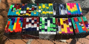

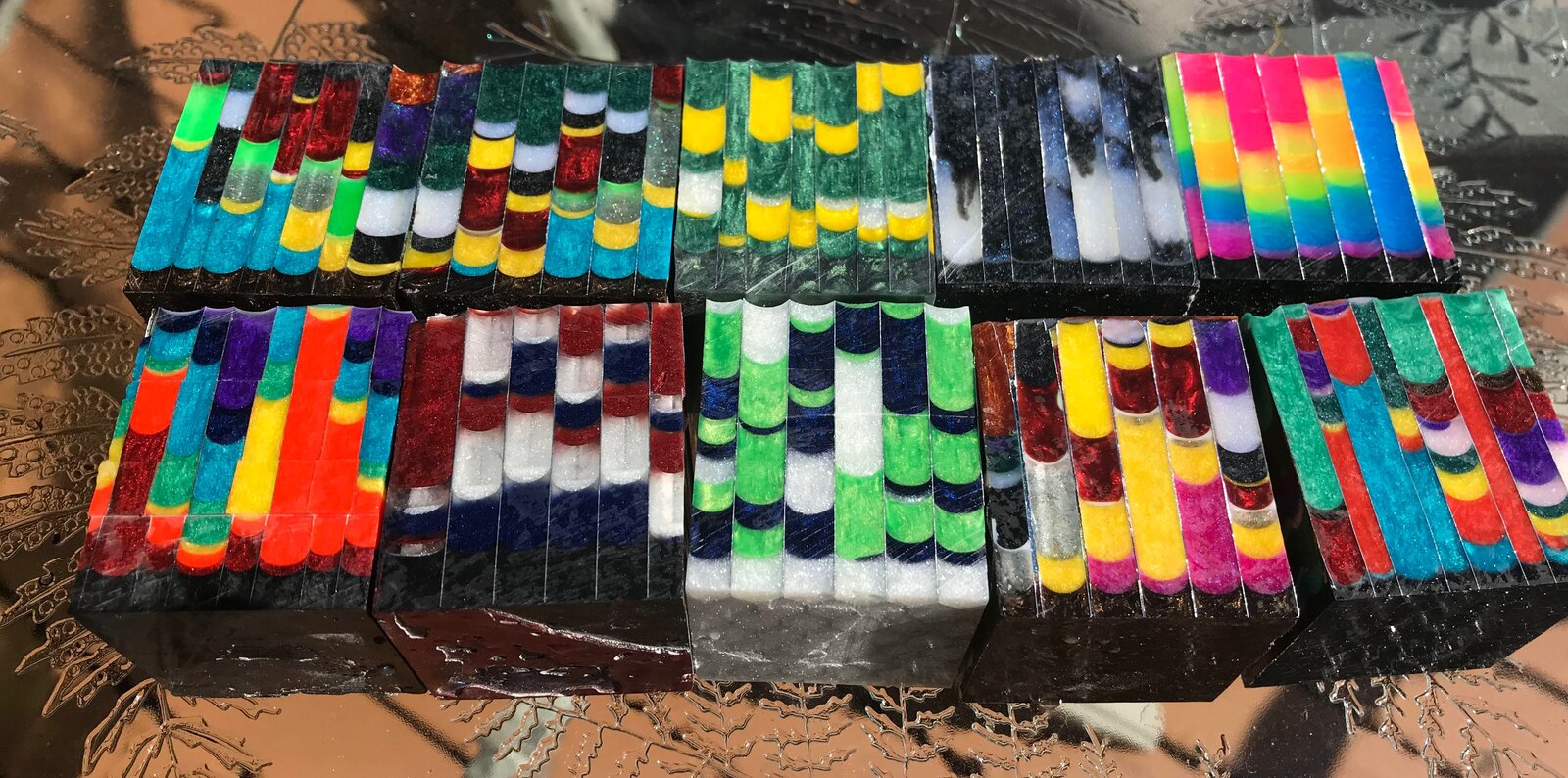

ccccchunt, how do you make those? They look pretty cool!
They are made out of 2" aluminum honeycomb. I cut the honeycomb into 5.5 x 5.5" sections and it fits in my HDPE molds for block casting. The aluminum is etched with Hydrochloric acid before casting.
Before putting the Honeycomb in the mold, I pour a 1/8" thick layer of Black or other contrasting color, then I push the aluminum honeycomb into the mold. When this first 1/8" layer cures, it seals the bottom of the honeycomb so I am able to keep the colors from bleeding from cell to cell. Then I mix my first color and randomly fill cells at different levels. Then I let it cure. Then rinse and repeat until every cell is full to the top. Because it's poured randomly, the pattern is different every time.
