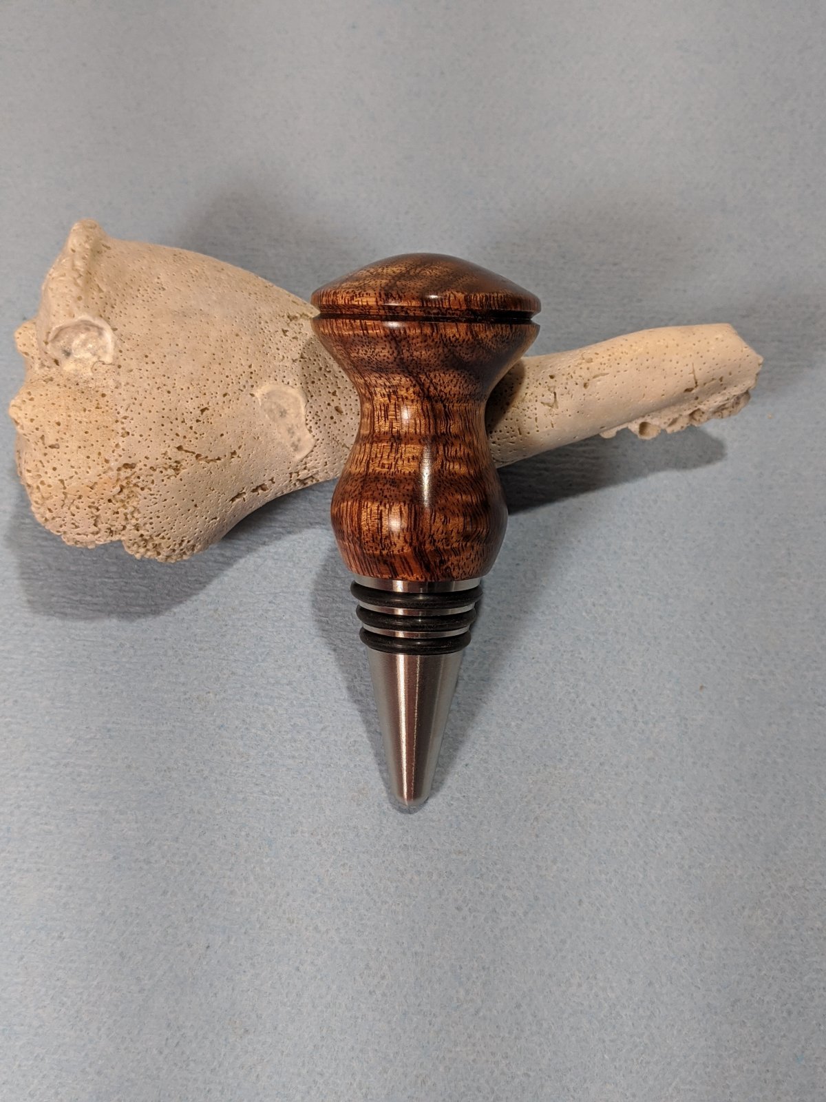

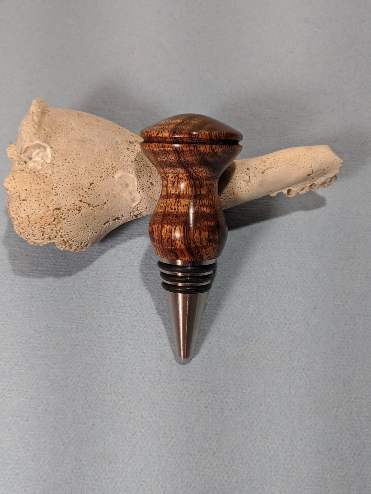

I just recently converted to Ruth Niles bottle stoppers (nilesbottlestoppers.com). Her's are all food grade Stainless Steel and produced in the USA and the stopper and rings are warranted for life. You might want to check out her website as some of the questions above are answered on her site. Her mandrels are great and extremely easy to use. I also use the brass inserts instead of the drill and tap set up some suggest and I've had no problems...at all. The inserts allow you to "mix and match" stoppers to different stopper heads. Your customers can choose a stopper and then select the top section too. If you contact Ruth directly she will usually get back to you within 24 hours and she'll answer all your questions. I'd like to see how your work comes out. Here's a shot of one of mine with a Niles stopper in Curly Koa. You can also see this exact stopper in her "Gallery" section on her site. Good luck.
Almost forgot, you can get an extra 10% off all her items, even if they're on sale, by using the coupon code "show special". Quick and inexpensive shipping too.
