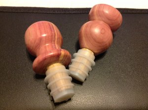

So I just made 2 red cedar bottle stoppers with the woodcraft silicone friction stopper. It uses a 1/2" dowel and I put a drop of clear silicone to make sure it stays on. First glued in the dowel then used my Jacobs chuck and a center till I got almost done then moved the center back to finish. I will say it was actually fun!!! I don't have many cutting tools but they came out great!
monophoto
Mar 13, 2010
2,545
Saratoga Springs, NY
They look very good!
I prefer to undercut the bottom of my stoppers very slightly - not more than 1/16". I use either a forstner bit to drill a rabbet before drilling the hole for mounting the blank on the mandrel, or I hold the blank in a scroll chuck while facing off the bottom with a gouge. Then I sand and apply finish.
The idea of the indentation is to create a rim to hid the seam between the stopper itself and the turning. It's a very small thing, but it makes the finished product a bit more professional.
