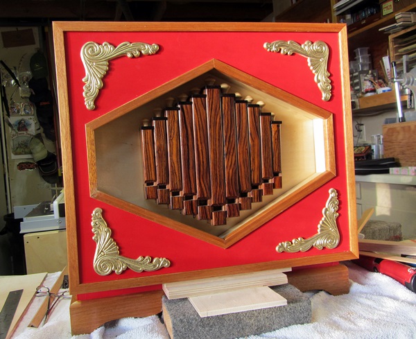

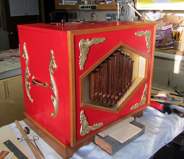

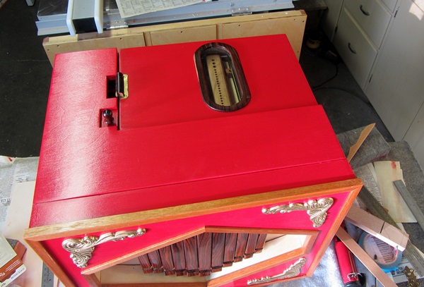

I started this last October and it is almost finished. I am waiting for some hinges to attach the front and top. This was a pretty challenging project and worth the work just to hear the first notes out of it. Could not have completed it without the help from a group over on the Family Woodworking Forum. It was so much fun I have collected plans for three other ones, just have to decide which one I want to tackle next. It is a John Smith Senior 20 organ, 20 notes, uses a paper roll. The plans and music rolls have to be ordered from the UK.

That is the plan, but I am waiting for some other organ builders to bless it.... We are getting together in the near future and I'm planning on having them help with a final tuning of the pipes. I'm real close, but don't understand music enough, nor hear well enough to make sure it is really in tune.
Completely understandable. As awesome as that looks you wouldn't want it to sound bad! Kind of like a great looking pen that won't write!

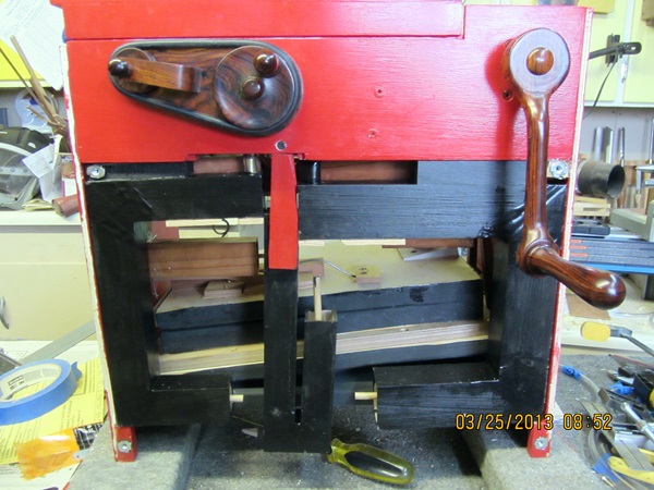

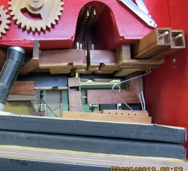

can we see inside?

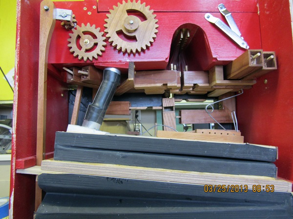

Sure:
1st is the back, the black pipes are the bass pipes
2nd is the front showing the other interior pipes (I put 9 inside and 11 showing on the front) plus you can see the bellows with the air pressure reservoir on top of them.
3rd is another of the some of the interior pipes and the spring that puts pressure on the air reservoir.
Anyone interested in these there is a great thread on Family Woodworking.org called "Organ Build".
