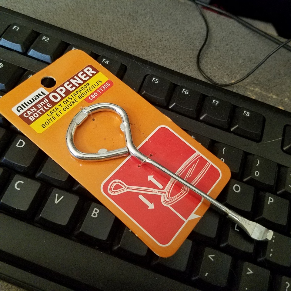

When making bottle openers using these paint tools how do you attach it.
I made one where I used I glued in a 7 mm tube and tuned a closed end handle. I then cut off the prying end and glued it in putting a few shims of wood to fill out the flat part. The issue is sort of the top of the hole kind of needs to filled.
Any other ideas? Maybe not use a tube and drill a smaller hole? the reason I used a 7 mm tube is that I thought it would help keep the wood from splitting.

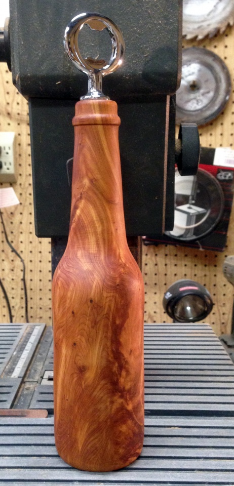

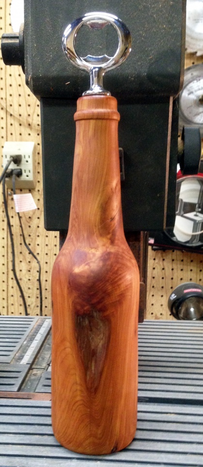

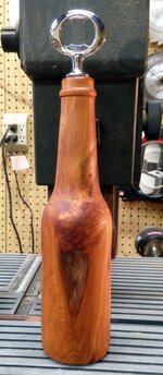

Here's a really cool idea for your bottle openers - a beer bottle beer bottle opener. I used one of the opener kits on this, but the paint can thingy could be used too.
I used wood from an old cedar post & made it the size & shape of a Shiner beer bottle and gave it to my brother last Christmas. He loved it.
