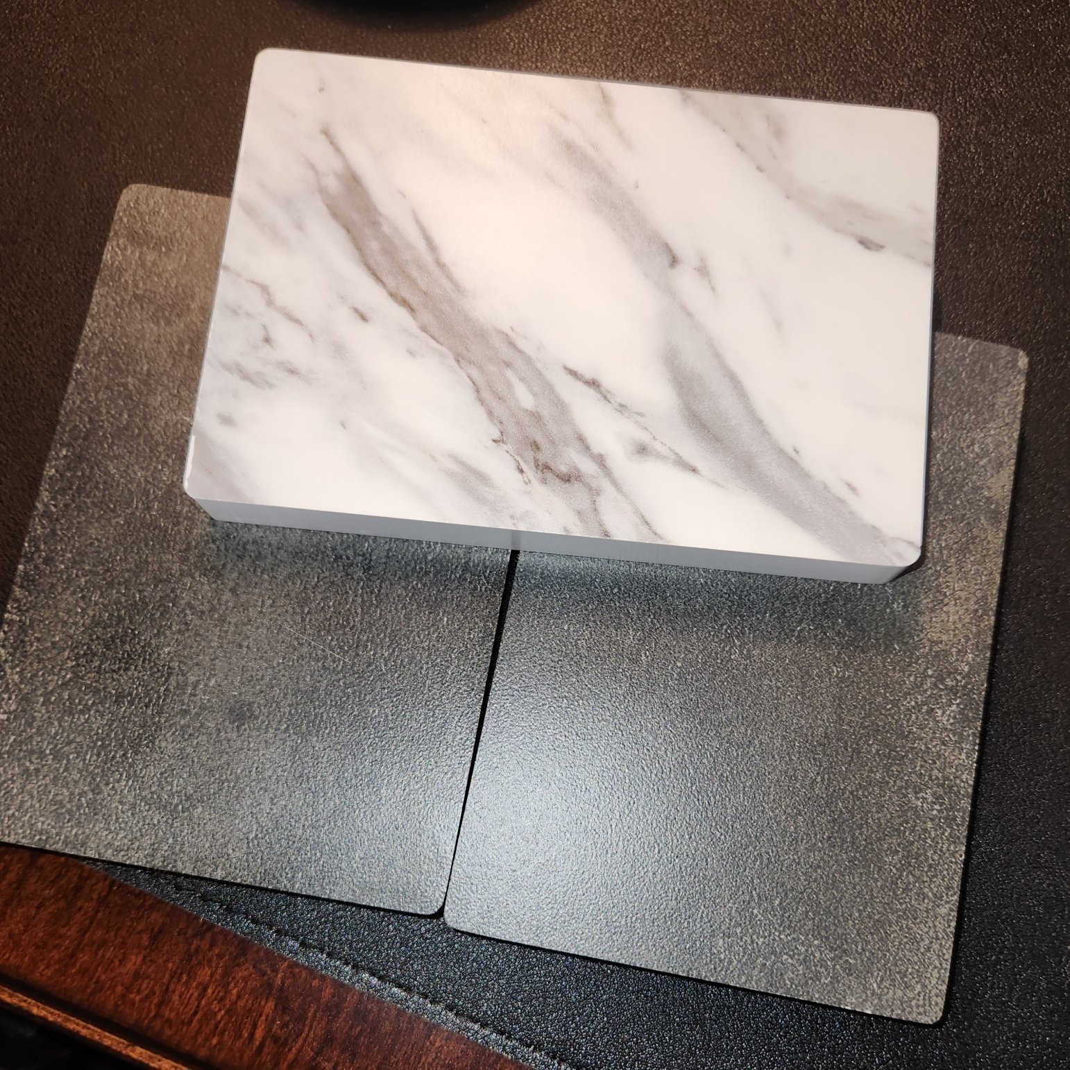

Seeking guidance / lessons learned for bonding corian or wilsonart material. I obtained some samples from Home Depot which are 1/2" thick. I want to bond them together to build a 2.5" x 2.5" blank. My intended use for the blanks would be for the Penn State yo yo and spinning top kits.
I reached out to the Wilsonart company for adhesive information and haven't heard back yet. I'm thinking due to low stress that regular epoxy should be sufficient.
I've always heard that medium ca, no accelerator is best for corian. You want to glue smooth to smooth, after roughing each with some sand paper. Just enough to remove the shinyness from the top surface.
You can also look for a glues that are specific to plastics. They usually have a prep agent, which basically "softens" the plastic and then the bonding agent is able to penetrate deeper into the surface so that it creates a "chemical" weld.
