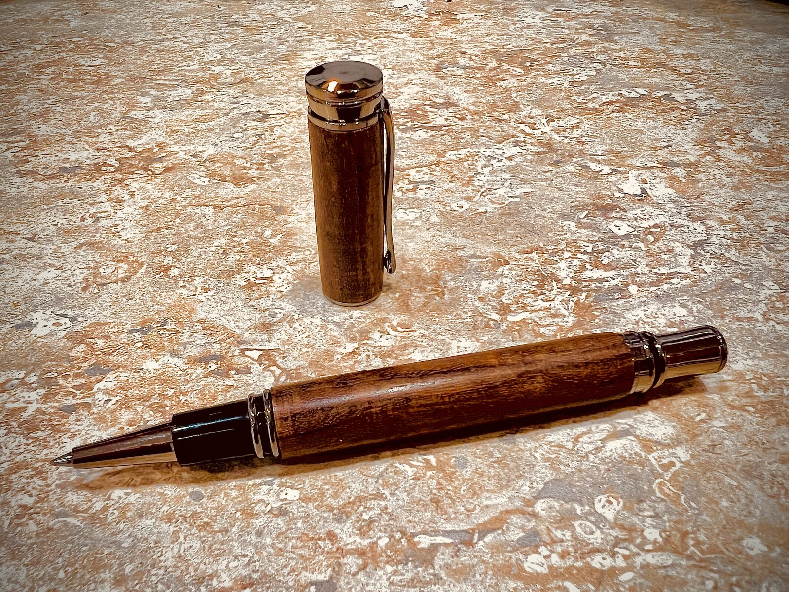

Lucky thirteen was the one that stayed together. For this one I coated the tube with an obscene amount of medium CA like I usually do but then also took the extra step of coating the inside of the wood blank with an obscene amount of thin CA. After a full 24-hour cure I took it to the lathe and turned it down to where it had nearly an eighth of an inch of thickness left and then pulled out the 80-grit paper gouge.
After a depressingly long time grinding wood off with the paper (depressing because it felt like cheating), it got very close to final thickness so I started up the grit ladder and everything finally stayed together.
A brazilion coats of CA/BLO finish later, it was ready for assembly. My kit was the Executive Rollerball pen from Penn State, which I hadn't seen before. I'm pretty disappointed. When the cap is in place, it looks like it wants to snap on further or like some thing is missing. I won't be buying this kit again (or this wood), but the wood does look pretty nice.
