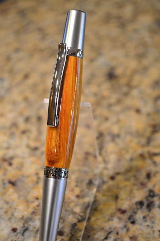

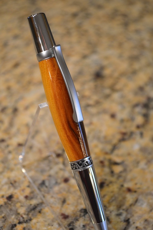

A friend gave me some Bodark (also known as Osage Orange or Hedge) and wanted a couple pens. Very hard wood (and very yellow) that turns beautifully.

it is one of my better choices of wood to turn, and crosscut is even better, but requires a sharp tool and patience. nice pens by the way.

Can you tell me how you did the finish? My son just turned his first osage orange pen today. I am trying to get my kids more interested in woodworking. But where I'm failing is with the finishing. We cant get anywhere close to that shine. And orange is his favorite color, so he was really excited to find a wood in his favorite color. I showed him this picture, and he was very impressed! Thanks for any help you can offer.

I use 5 to 6 coats of medium CA and then wet sand them with micro-mesh from 1500 to 12,000. Then I use HUT Ultra Gloss Plastic Polish to cover any small scratches.
I apply the CA in thin even coats and lightly spray NCF Quick accelerator after each coat. Do not get in a hurry here. Let the CA set between coats (several minutes).
I've done over 500 pens this way and if you use fresh CA you should have no problems.
Good Luck. Let me know how it runs out.

Beautiful pens. !!
Finishing is... tough! And it changes for every different blank, and every different season (humidity in your shop...). Find your comfort zone, then tweak pretty much all the time. :rolleyes:
I prefer to "wet sand" with Walnut Oil and abranet 180 - 600. Then go to Pens Plus; or Danish Oil ( MM - 12,000); depending if I want a shiny finish or a matte finish. I rarely do a CA finish. And to complicate matters... At times I use a thin CA finish x2, then sand and finish with PP or DO.
Good luck!

Interesting Mark! I totally agree with the change in temp and product, but now you got me thinking about other finishes. Thanks!

Nice choice in the wood for your pens. Osage Orange is one of those timbers that just look great, without any fancy figure or burl. It is in a small group of timbers that one can make that claim for, such as lignum vitae, and some iron woods. Nice work!

Awesome. Thanks very much. Do you sand in between the coats of medium CA?

No I don't - unless I messed up when applying the CA.

Thanks, Ross. I tried your technique last night and it worked out great. When I showed my son the results, he got excited to make his next osage orange pen. Really appreciate the suggestion.
