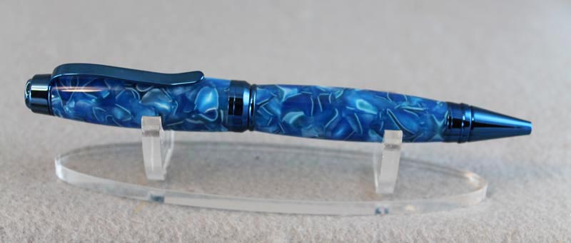

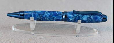

I bought a couple of these when I placed my last order from Beartooth.
I saw John's thread about them and finally got around to turning one.
The wife thinks it really cool.
any comments and suggestions welcome,
Mike

They look really good. I just got my order last week so I too will try some of these out. I like the color of the parts. Will go good with many blanks. Thanks for showing.
