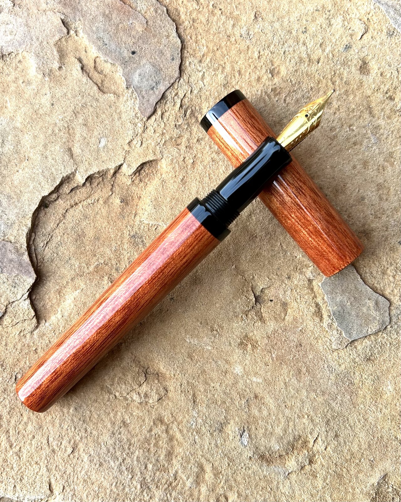

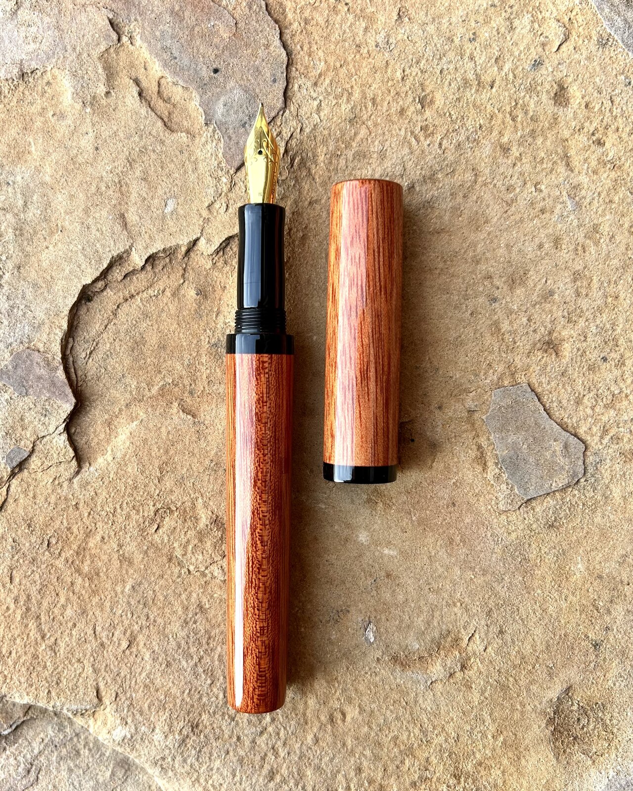

We haven't worked with blood wood up until now, and I have to say I'm a fan. Beautiful burnt orange coloring with darker grain that the ebonite seems to complement. This one has no inlay, but features a sleek modern look with ebonite rings at body and cap that highlight the beautiful wood coloration and grain.
Blood wood with ebonite sleeve and section

Gorgeous pen. How long are you ebonite sleeves? Do they run all the way into each blank or are they just a few mm long?
Thank you so much!
The sleeves run all the way up into the body and cap. This is to help protect from ink leakage leaching into the wood as well to protect the nib from drying out.

I have only just begun my journey into kitless, so I hope you don't mind a few questions for you (sorry in advance):
  1. Do you sleeve the wood with solid ebonite first and then cut & thread the tenon/drill and tap bores? Or do you do all that first and then glue in the sleeves?
  2. Looks like CA finish, how do you treat the ebonite portions, do you just CA over turned/sanded ebonite and then polish the whole body/cap or is there special treatment/process. So far, I have only used ebonite for making sections.
  3. Are you doing all of this on a wood lathe?

First off, you are correct in your spelling, Bloodwood is all one word. Oops!
1) We drill the ebonite as per a usual pen, then epoxy in place. I'm not sure if that's the right way, but works for us.
2) The ebonite portions are treated just like the wood. You can do the section that way as well, but I've read that buffing makes a big difference with ebonite. I don't have a buffing wheel though so I do the best I can.
3) Yes, wood lathe.

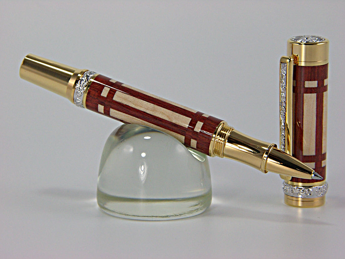

Bloodwood should be pure red and it is but it depends where it was harvested. Also is it from South America. There is bloodwood that also is called Satine and is more brownish than true bloodwood. I have boards that are deep red and true bloodwood. But whenever I ordered turning stock bloodwood they sent Satine which is not even close to red. Redheart has streaks of brown through it and over time will turn brown just as Padauk does but that is more orange red. Redheart also known as Chakte Kok comes from Souther Mexico and again when harvested and where play a role.
Here is a bloodwood and maple pen and it is as red as the day I turned it.

Here is an example of Redheart and it too has stayed this color but see very little direct sunlight.

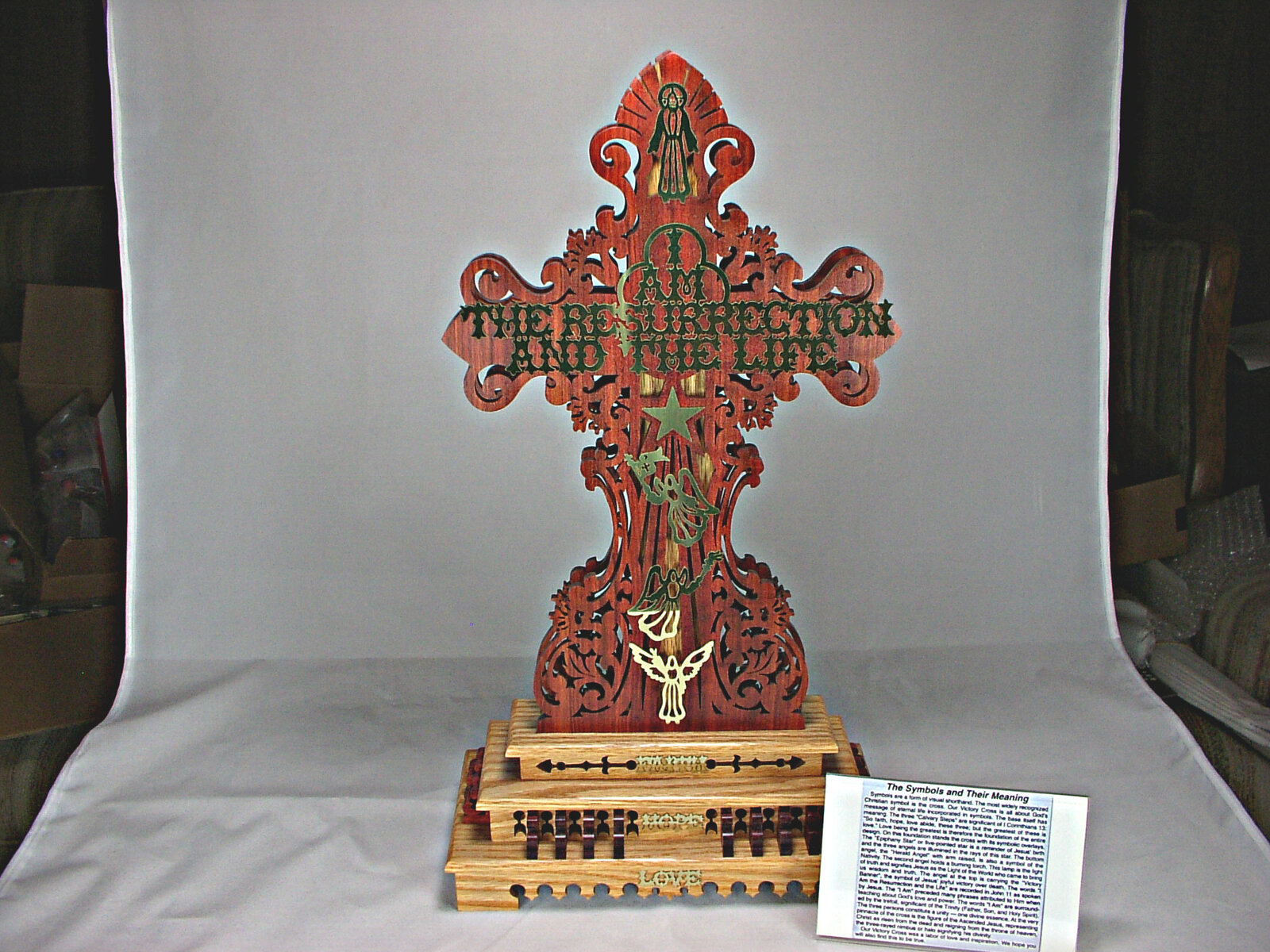

Beautiful segmenting.
Is this your scroll saw work? That is incredible and beautiful wood?

Yes it is. Scrolling is my first and long time passion and hobby. That piece is done with Redheart and red oak and the overlay is bright brass. There is red stain glass within the steps behind the fret work. All cut on a scrollsaw. Thanks for the kind words.
