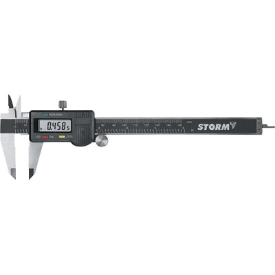

MatthewZS
Jul 22, 2010
482
Georgetown Texas
Like these
