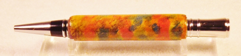

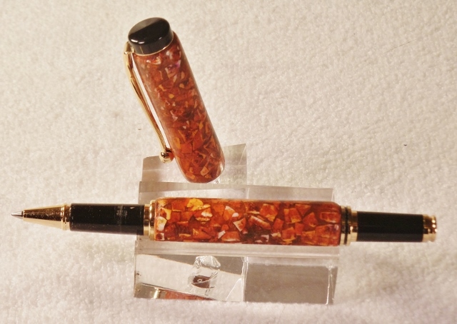

Harvey; Try using alcohol inks to dye your blanks. The alcohol goes deeper into the grain of the wood, doesn't need soaking, no waiting to see what color are getting, and you can control the depth of the color by wipeing off what you don't want. You can also use a blending solution to soften the colors or make them blend evenly. You should be able to find the inks at most hobby or art supply stores, or look up Alcohol Ink on the internet to find a sorce near you or by mail. I added a couple pens to give you an idea of what can be done. The effects and colors are endless. Jim S
