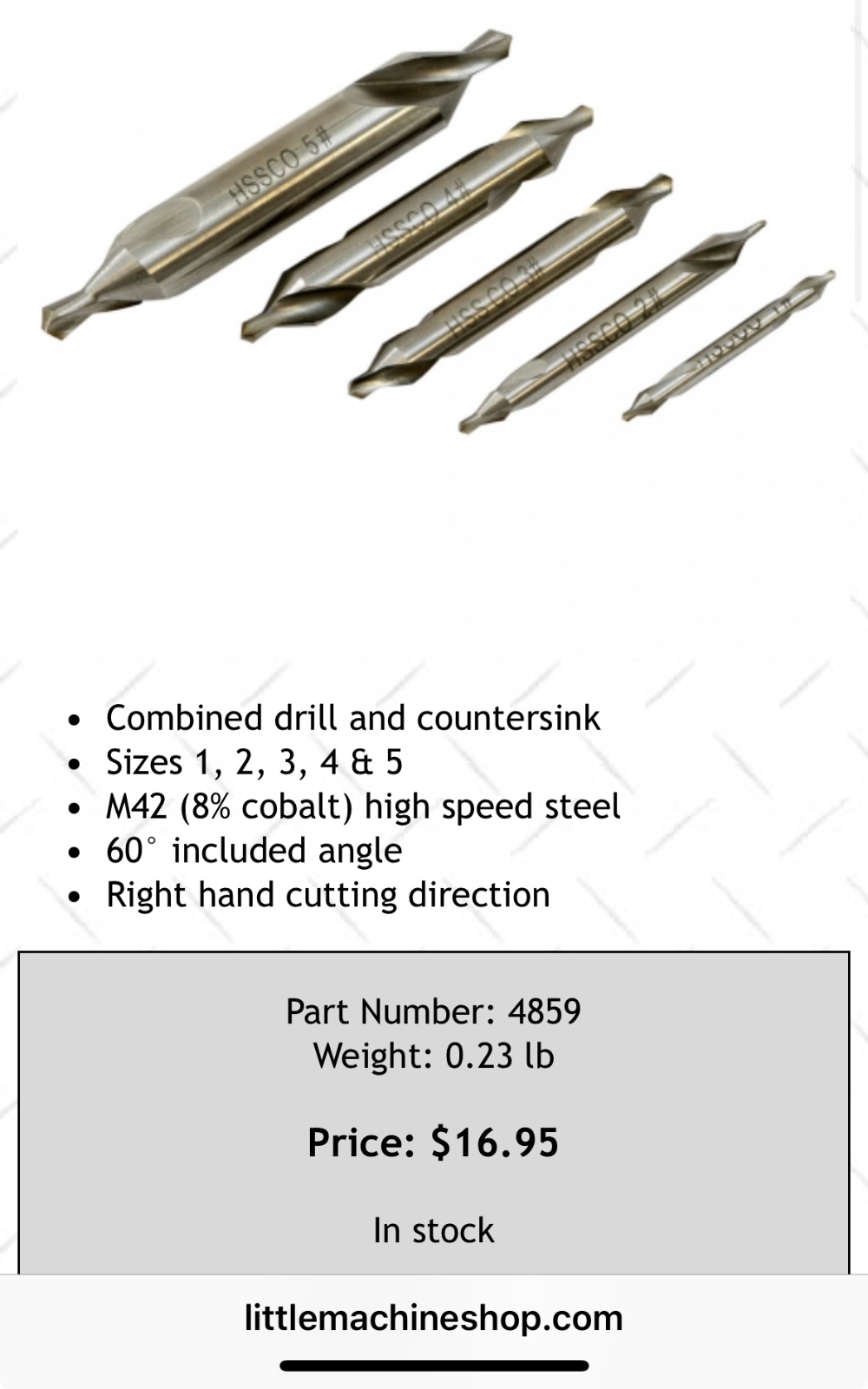

Ken, what size centering bit do you use? Looking online it seems they all max out about 5 mm or 3/16 inch diameter
I bought this set at little machine shop. I pretty much though only you the largest one.

Thanks for all the good advice. I batch drilled ten blank segments in my lathe last night, and I learned firsthand how a brad point drill bit can wobble and wander as it starts to enter the blank. I just went to Harbor Freight and picked up a set of centering bits for $7. Those should work for my needs.
