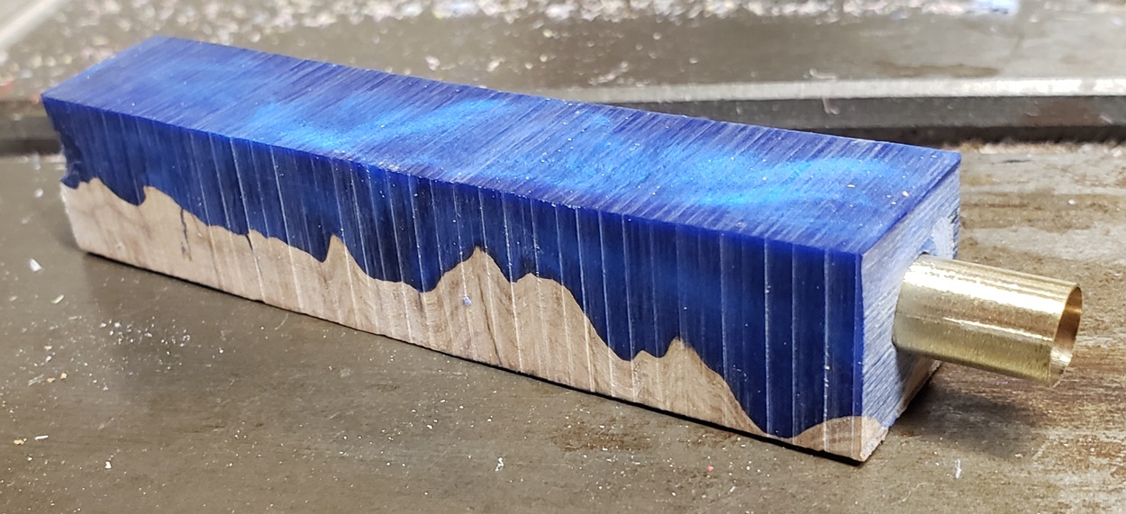

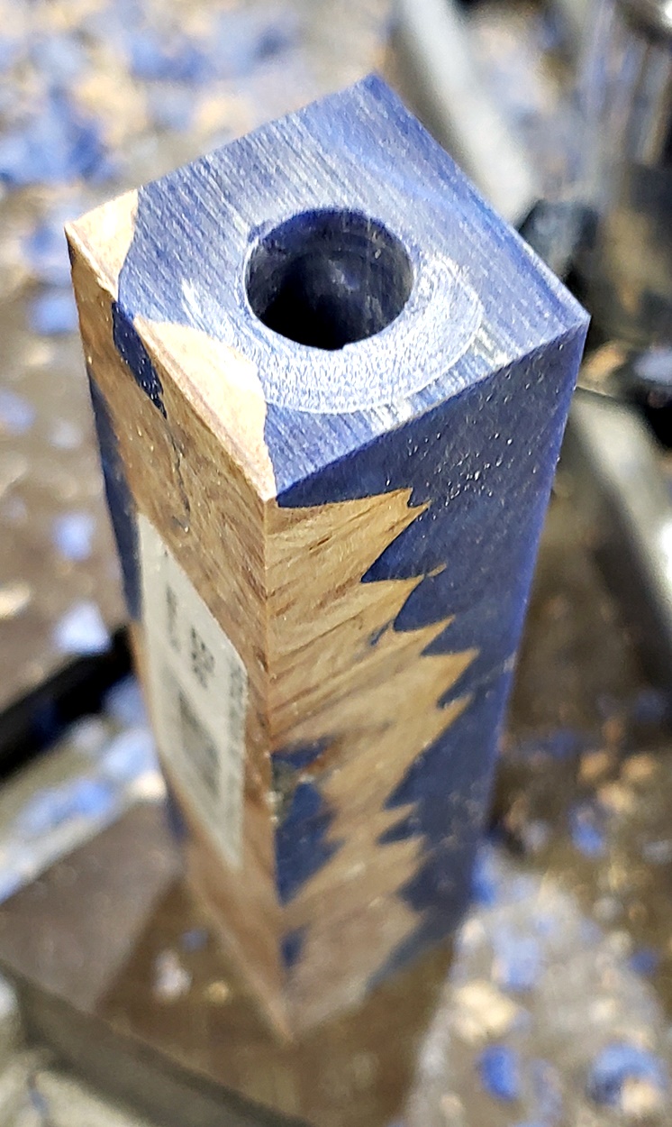

The directions I found on Berea's site say to use an 11/32 drill bit. The opening seems pretty large and the fit of the brass was loose. I'm hoping the epoxy will hold ok. What has been your experience making the Blade kit?
Suggestion - using calipers, measure both the drill bit and the pen tube. Its possible that the bit is mismarked, or that you grabbed the wrong bit. It is also possible that the tube you have is undersized. In other words, check everything - don't assume that anything is what is says it is.
You could also drill a hole in a scrap of wood to test fit the tube. But that only helps if you are sure that the tube is the correct size.
How are you drilling the blank? Is it possible that your bit isn't centered in the drill chuck? In that case, the bit will wobble and drill a hole that is larger than the bit. The same thing can happen if you are drilling on the lathe and your tailstock isn't aligned with the axis of the headstock.

It looks like it was a poor job of drilling. I will start with a starter center, then a jobber bit, then finish with the longer bit. It's a long tube and looking closely it's obviously wobble that enlarged the hole. Thanks for the feedback.
