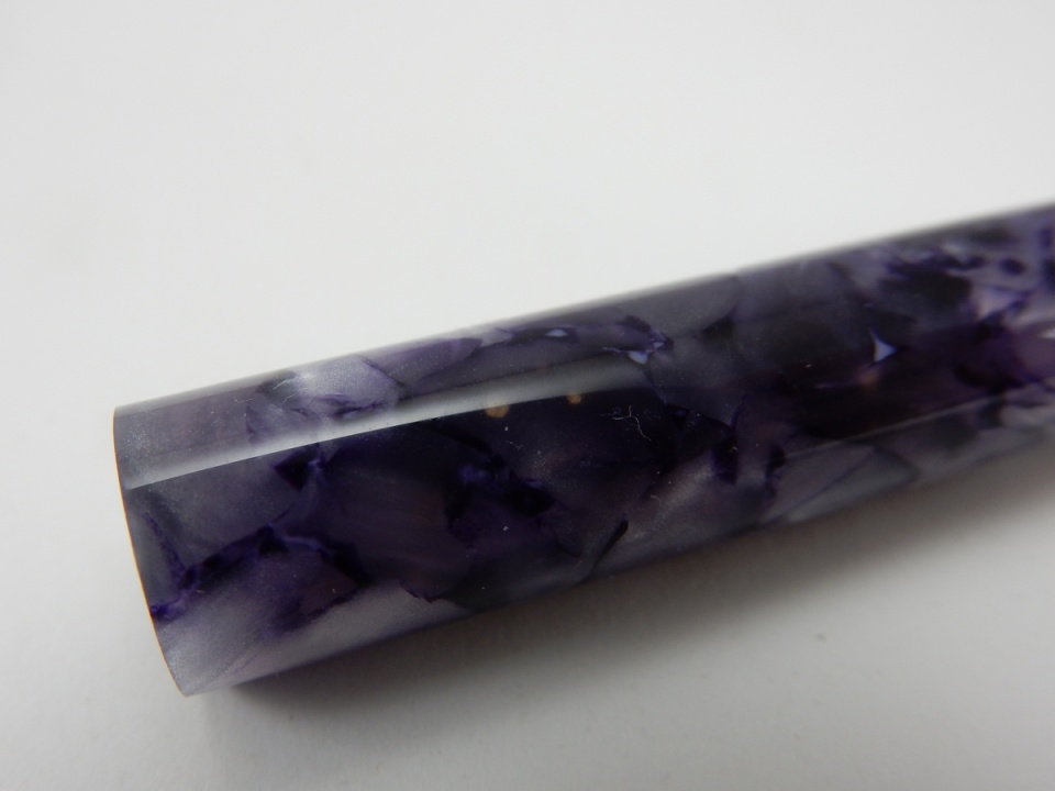

Well, I turned my first pen which used the black epoxy on brass tubes...
I'm not real happy with the results... you can see several spots in this picture where the brass shows thru the blank. So I need a new plan...

How about painting the tube black and using black epoxy.
I paint the inside of my blank AND color the epoxy. I use a drop or two of Testor's enamel paint to color the epoxy, but not necessarily the same color as the paint used inside the blank.
